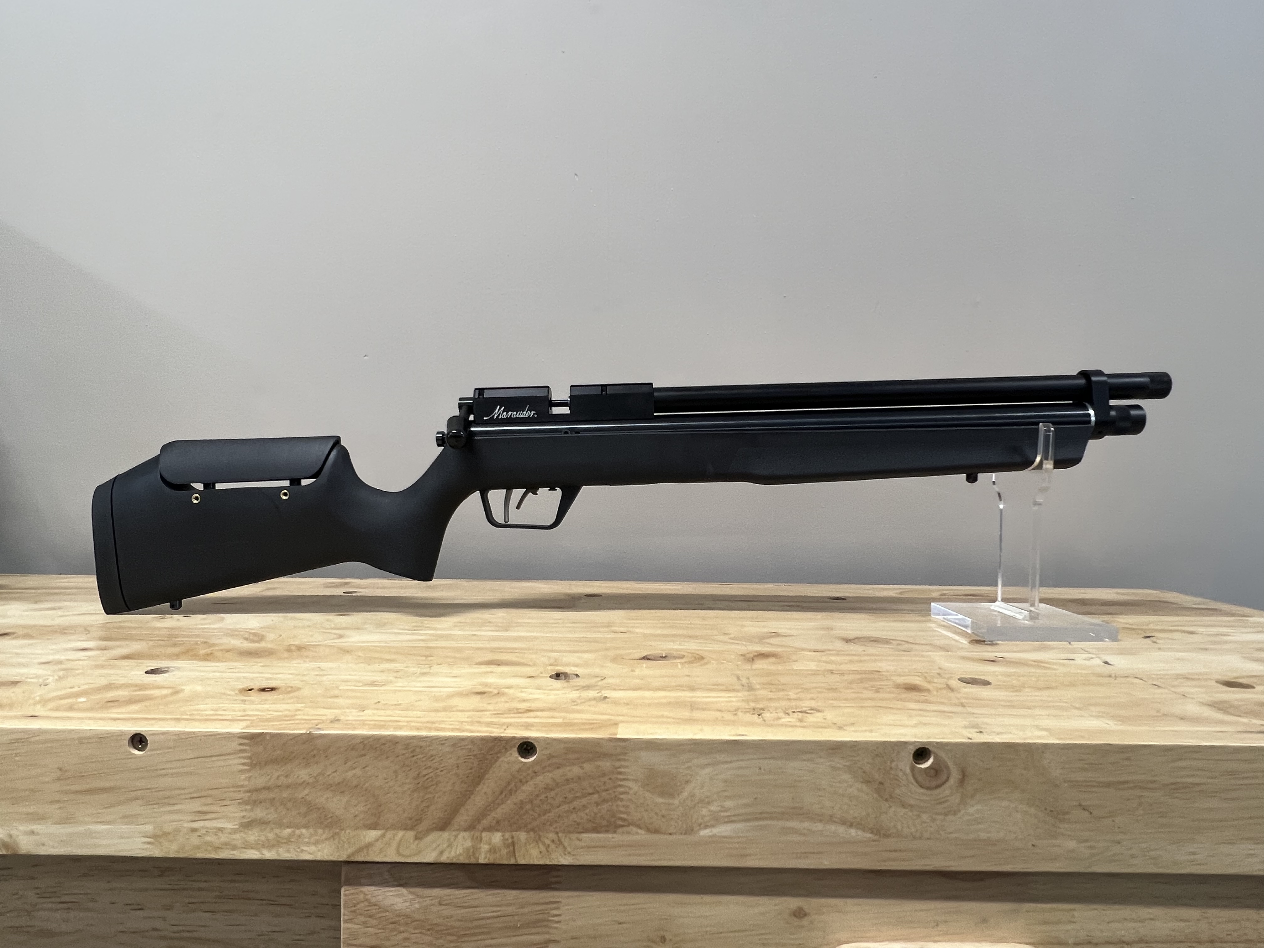

I’ve had a ton of requests for this gun past several months. Since the debut of AR’s Shawty B (Specifically developed barn gun) I was getting requests of this same setup but in say a higher power Truck gun. I finalized the gun’s build last week and is available now. Specs are listed on my website. A truly rugged gun and simple design with less points to fail then any other.
A slug version is going through testing now but not sure at this point if it would meet my accuracy requirements to make available. Time will tell.
The Shawty HP is capable of generating up to 50fpe in .25 and getting 16+ shots at those levels.
A Shawty running 25.3 g @ 880 will get 20+ accurate shots with an extreme spread of 5-7 fps through those shots without the use of a regulator. I highly believe in a well tuned gun over one with a regulator installed. Especially the Marauders. I’ve proven that out and why my standard guns run incredibly well.

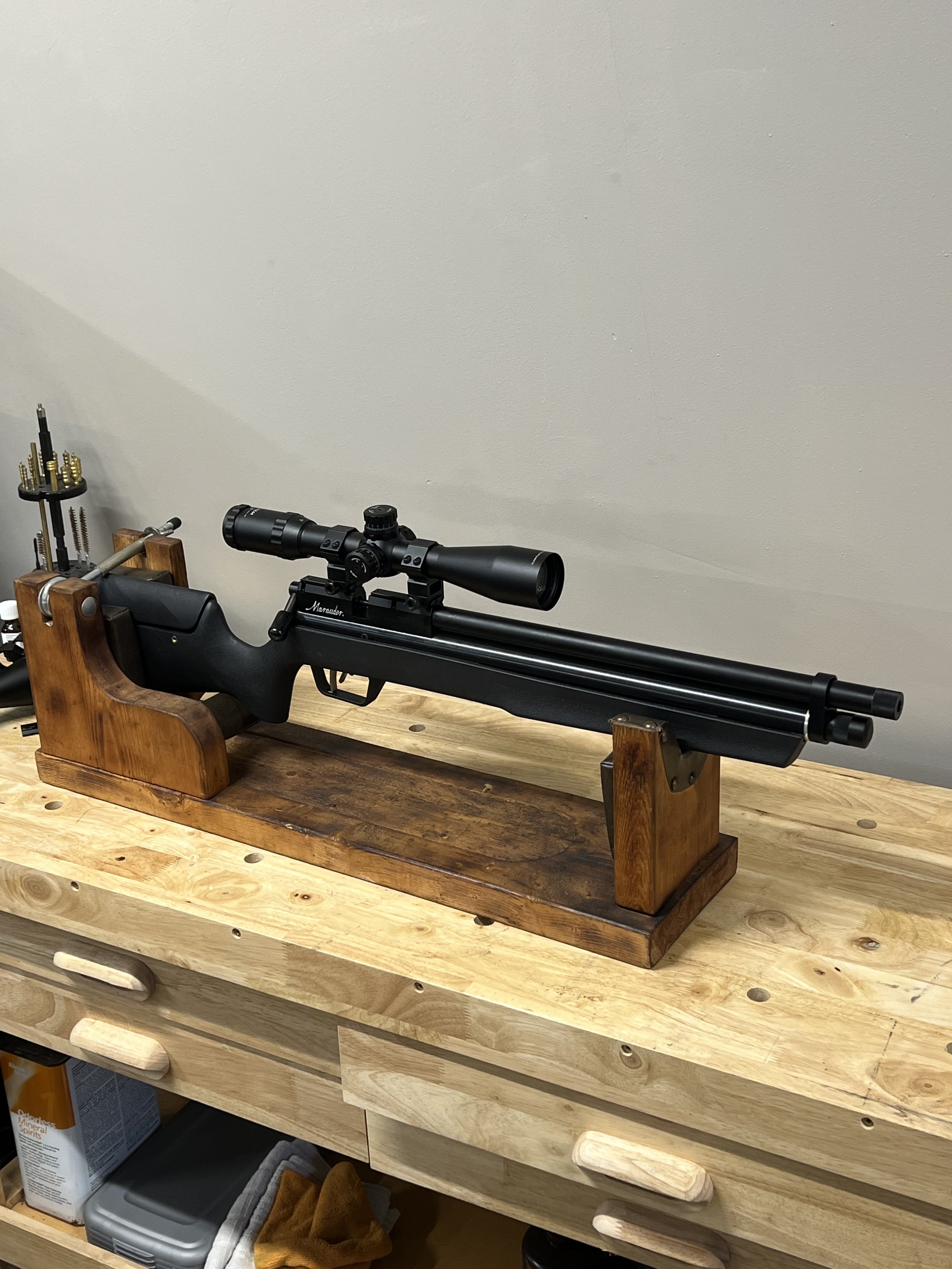

Got mine today! I mounted a little 3-9 UTG on it so I could shoot it. I shot it at a 2800 fill for 2 mags with 25.4 fxs and averaged 898. Shot it at 30yds and both mags was basically one big hole. Tried the hades they seemed to be just a touch more accurate. Going to do a 3000 fill to compare. The 2 mags took it down to about 2200 if I remember correctly.
It a great hunting gun and glad I had him do it.
Yep, got mine last week….couldn’t be happier with it.
Stuck a 10X SWFA on it and proceeded to get the same performance as above.
Super accurate and efficient.
