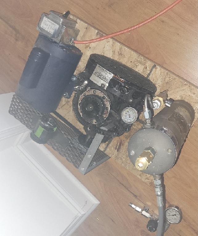

The only "problem" I ever had was with the pressure blow off on top of my filter housing. Around the 10th or so fill I did on scba tank, I let the pressure build till it released, right at 4500 psi with pressure guage just a tick under that. Scared the piss out of me, I was just walking up to it to stop the fill when it released. It is supposed to reset when everything is depressurized but on mine it had a good leak afterwards. I called shelden and he told me the smallest particle that gets in the sealing surface inside will not allow it to seal, you might not even see it when you take it apart. Told me how to take it apart/clean/reset and it was super simple, but getting the pressure set exactly where you want it is tricky. And you have to be surgically clean when cleaning the mating surface or you wasted your time. Took me two tries to get it clean to seal, and I never saw anything dirt wise, looked sterile to me. I used a micrometer and measured before I took apart and set at same height as best I could, fired up and was filling another scba tank and pressure blew off at just a tick over 4000 psi, it reset itself properly that time. I adjusted the height a little, fired back up and it blew off just over 4400 psi. That is still where it is set today, touchy thing to adjust and I figured it was just fine where it was. I have less than 45 hours on mine in 7 years, that is a lot of air at this pumps capacity. My vibration hour meter is showing just shy of 42 hours, I got the meter off fleabay used for next to nothing, new on them was over 500 dollars. Best I can tell from timing fills with stopwatch, it is extremely accurate. I obviously do the 40 hour or once a year maintenance once a year instead of the 40 hours.
Blow off valve is brass part on top of 15"x4" stainless breathing air filter housing on mine.
