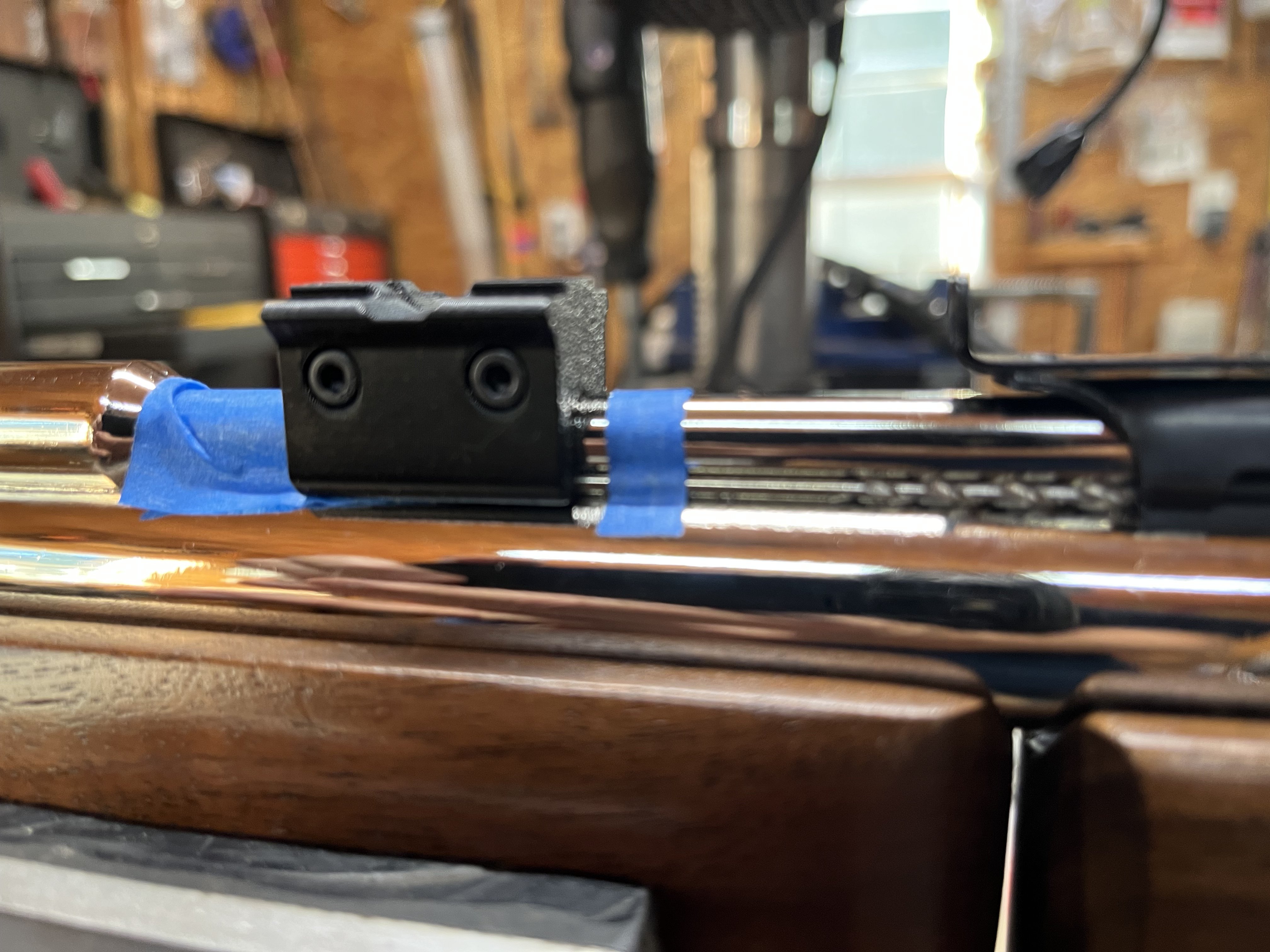

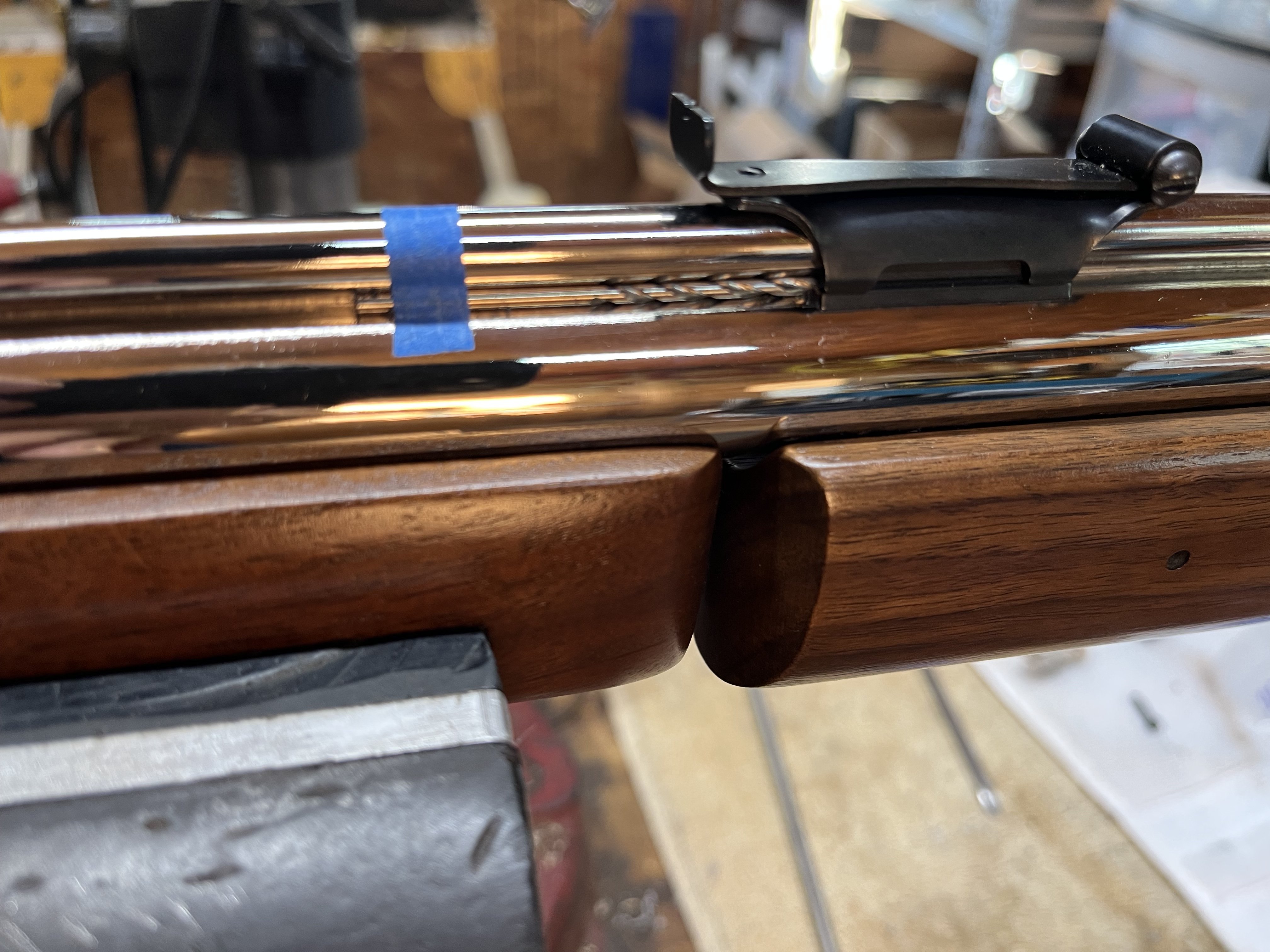

After looking online, I found only solutions that meant beating the sight off with a hammer. Not a good idea for a soldier joint. At least to me. So, I came up with this solution. Two identical tiny drill bits and one Buck Rail mount. Could use the Sheridan mount or make a stop out of wood. Removal or install would be the same. Did both my nickel finished Benjamin’s without a hitch.

After looking online, I found only solutions that meant beating the sight off with a hammer. Not a good idea for a soldier joint. At least to me. So, I came up with this solution. Two identical tiny drill bits and one Buck Rail mount. Could use the Sheridan mount or make a stop out of wood. Removal or install would be the same. Did both my nickel finished Benjamin’s without a hitch.View attachment 513201View attachment 513202
Brilliant! Im putting a williams peep on mine and I will be using your method to remove the iron sight1
