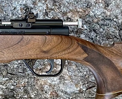

I always put an occasional drop of a heavy oil on the bolt. Then with my finger work it thoroughly around the entire bolt. I think it’s very important because when cocking the bolt, lateral force is being applied from a steel bolt to a soft brass receiver. Smooths out the cocking effort and reduces the binding, which also reduces wear. An occasional bolt and receiver cleaning is necessary to keep dirt out of the oil. No different than any other bolt action rifle. I’ve held some Sheridan’s with a receiver that was worn terribly from a dragging bolt. Probably won’t effect the shooting but why let it get this loose. I just acquired a Benjamin 392 used and someone wisely changed the bolt handle to a knurled knob. Always pulling directly straight back. It was dry and a drop of oil made all the difference. It would need to be explained to me just how a couple drops of oil on the pivot joints on the muzzle end/arm would migrate to the bolt on the receiver.
