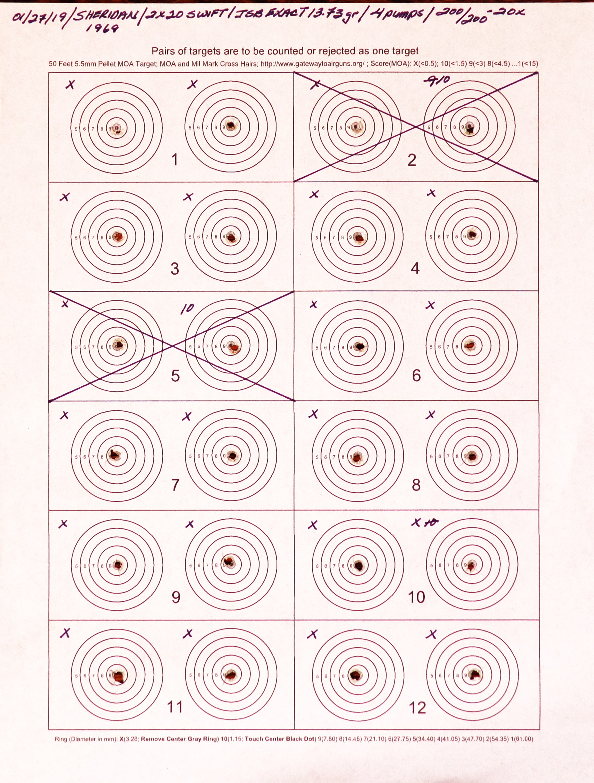

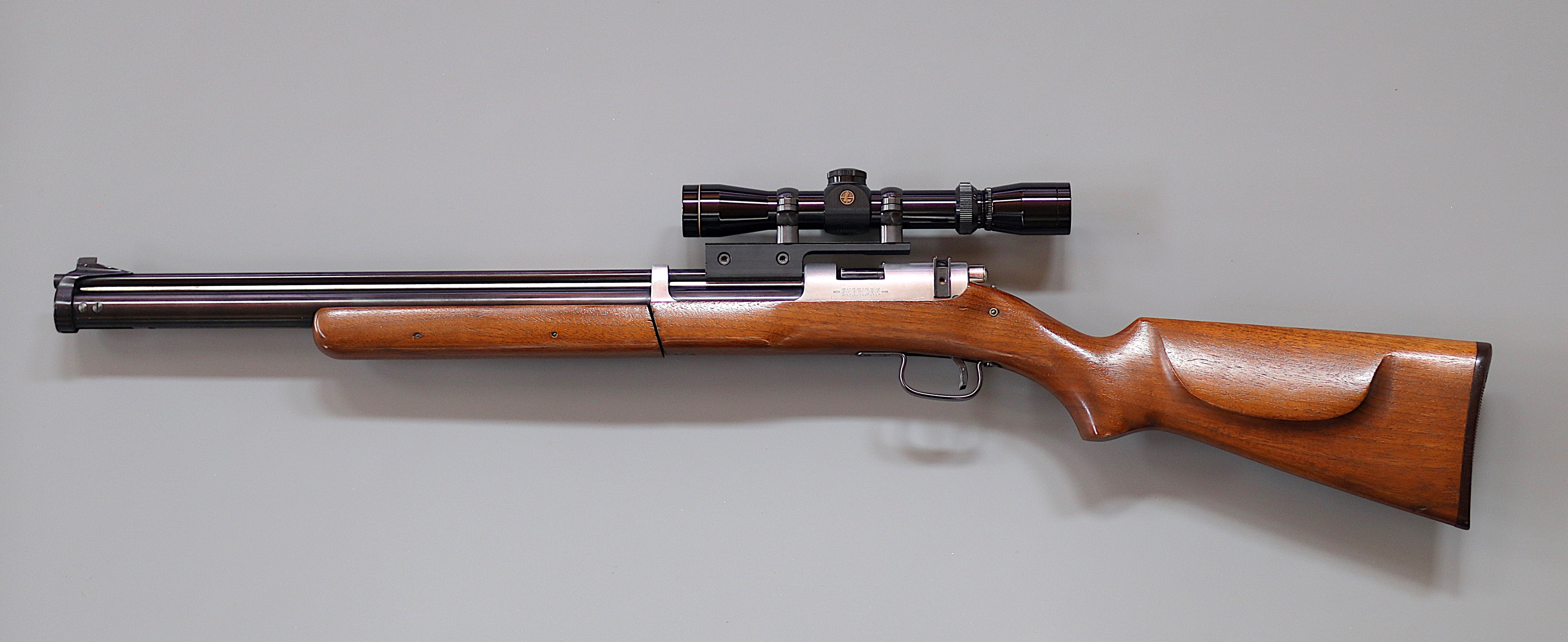

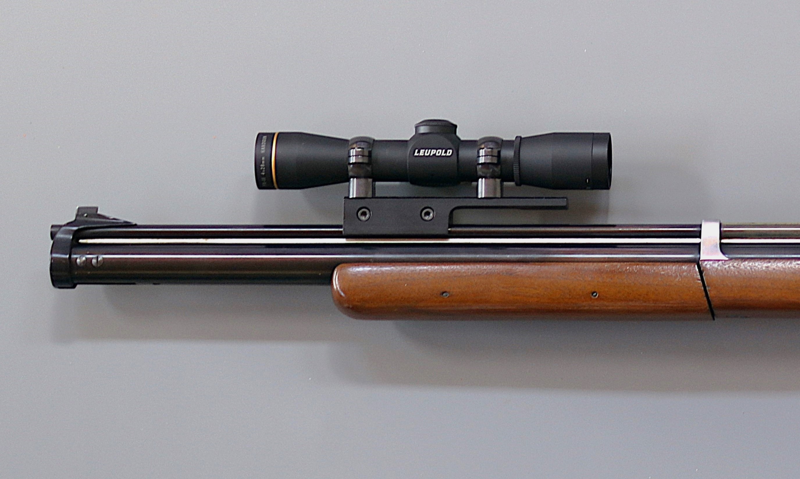

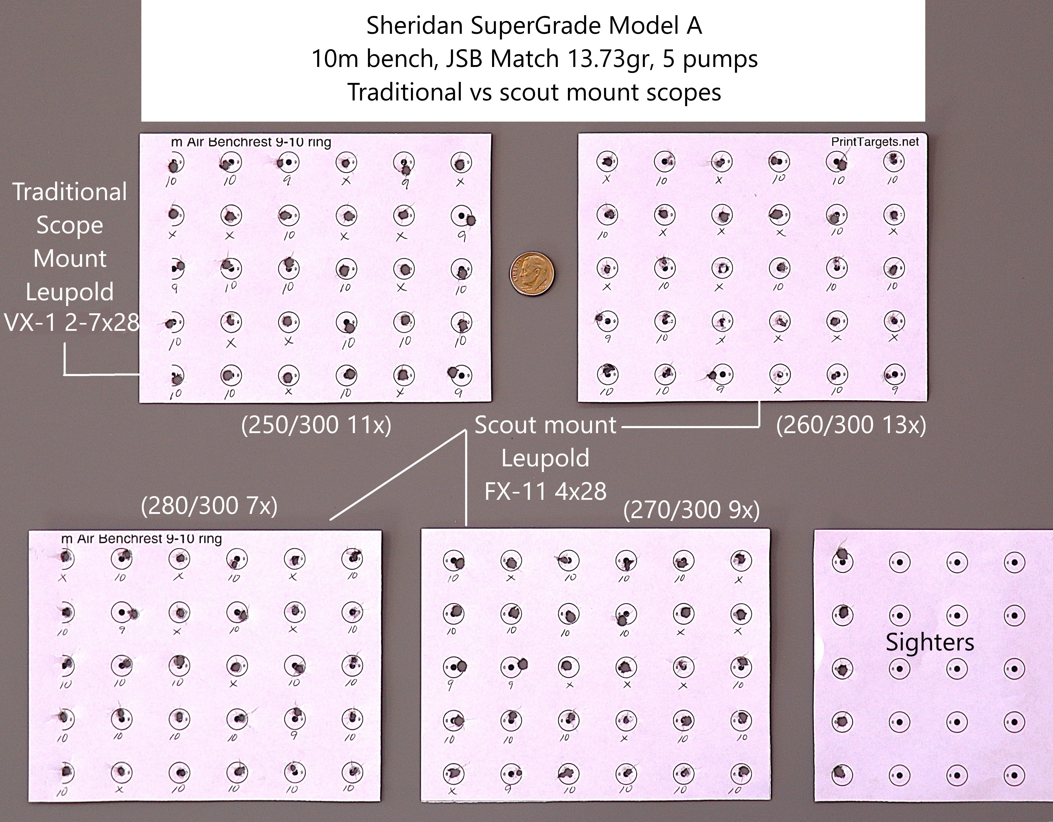

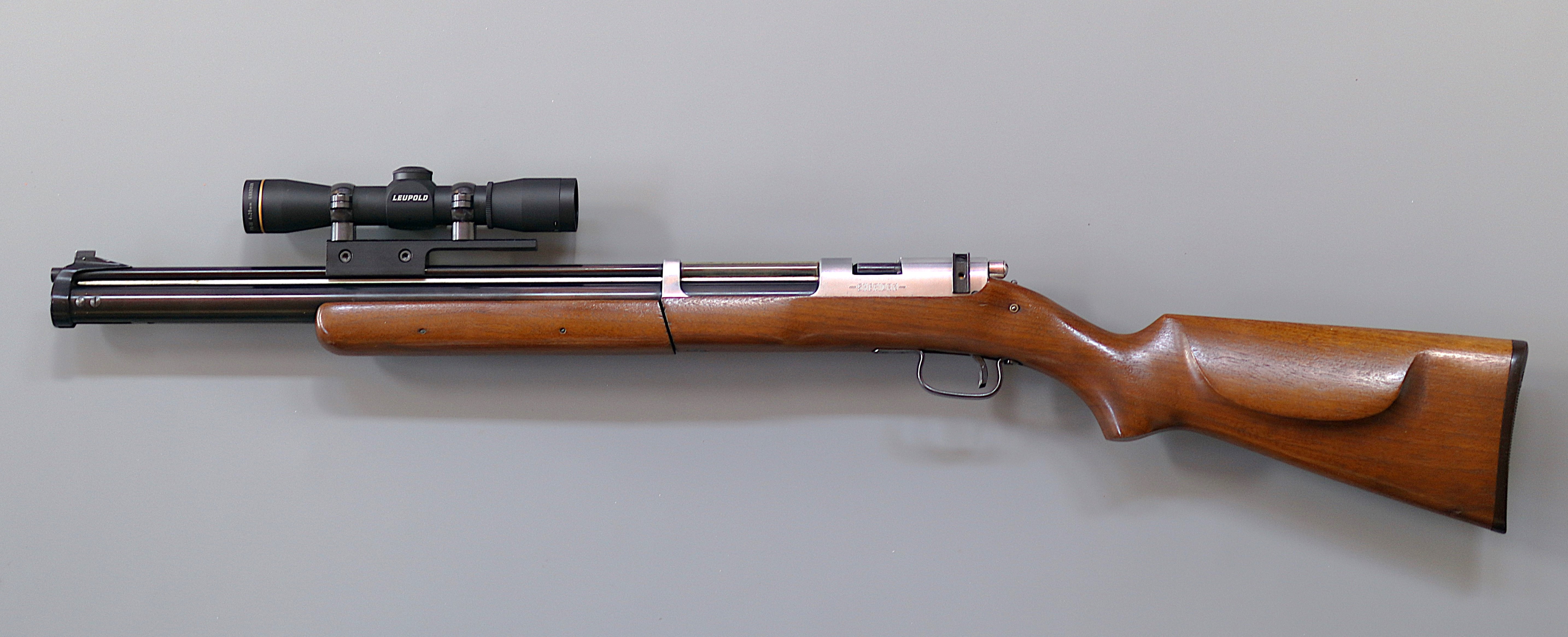

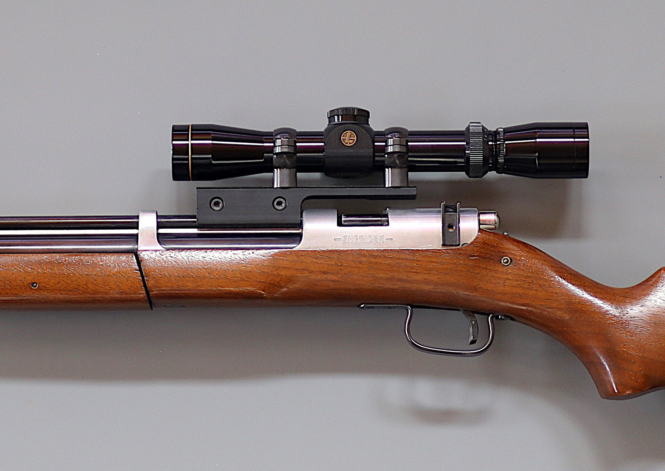

My number 1 bucket list with regards to ag's was adding a SuperGrade to the collection. Number two was testing the SG on the range to see how it compared to the Model C. A tall order given the later is the most accurate of all my vintage pumpers.
The gun was tested from a bench at 10m. First with a traditional scope mount and second with a handgun scope/scout mount. Pros and cons of both are as follows;
Traditional scope mount;
Pros:
Much more pleasing with regards to aesthetics.
Cons:
Difficult to access loading port.
Difficult to cycle gun beyond 3 pumps w/o placing free hand over scope.
Repetitive zero placement of cross-hairs impossible.
Sight acquisition lags.
Scout mount;
Pros:
loading port access remains the same.
Cycling gun with proper free hand placement remains the same.
Repetitive zero placement of cross-hairs much more consistent.
Spontaneous sight acquisition.
Cons:
Much less pleasing with regards to aesthetics.
Perhaps the most limiting factor between the two optic configurations is zero placement. The scout mount allows the user to place the scope at the exact distance where the "scope shadow" is just beyond the circumference of the field of view. Extremely important for precise repetitious cross-hair placement. In addition, and just as important, the scout mount allows the user to use the turret caps as an additional aid to true-up the cross-hairs, which is impossible with a traditional scope mount.
Conclusion:
When compared to the Model C, the SG has a much more cumbersome trigger design. It's ridges/grooves grip the trigger finger and leaves little room for finger placement/pull error, whereas the Model C trigger is smooth and much more forgiving. However, the SG's trigger has what could be called a two stage trigger which is certainly an advantage over the Model C. If the SG had the same trigger design as that of the Model C it would be the clear winner. So for now, the scale tips in favor of the Model C simply because of it's trigger design.
The last photo shows what the Model C is capable of.

I do not understand your loading port access , or are you stating the loading port even without a scope is difficult ? clearly the scout mount has nothing to do with the loading port . Also when pumping the gun ? my hand holding the gun would be over the loading port when pumping with the scout mount (which is what i use on my sheridan)
No. Access to the loading port is difficult with a traditional scope mount & completely accessible with the scout mount. I thought I made that clear, "remains the same" w/scout mount.
Yes the scout mount allows the user proper placement of the free hand for cycling. That was also made clear, "remains the same" w/scout mount.
Refer to pros & cons.
guess i read it wrong IE: "remains the same "as in the first description .

Thank you Treefrog. Although I am not implying the SG is less accurate than the Model C. Quite the contrary. It is every bit as accurate. The only issue (speaking only for myself) is the SG's trigger design. I found it difficult the duplicate each pull with the same consistency due to the grooves on the face of the trigger.
