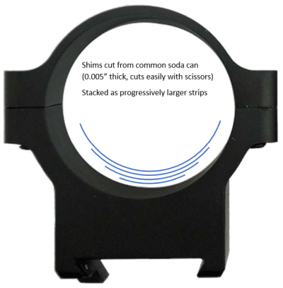

If we are talking about a hard-recoiling springer, that's a different story...often they need to be tightened right up to the ragged edge of crushing the tube. But on PCPs I've shimmed in the ballpark of 100 scopes, in amounts ranging anywhere from 0.010 - 0.025", and not only have I not damaged a scope, the tubes look and feel no different than a myriad of scopes that were mounted with no shims.
The way I do it is with progressively larger strips cut from a soda can:

Hello Jason
Can this method be used to simulate the use of Burris Signiture rings?
For example, offsetting the shims to 135 & 55 degrees
Seems like it might be tricky
Not really...only the portion of the shim(s) occupying the stationary side of the ring would influence the scope. Might get a little lateral adjustment but not as much as the Burris arrangement.
An alternative is to shim at the rail / dovetail.
