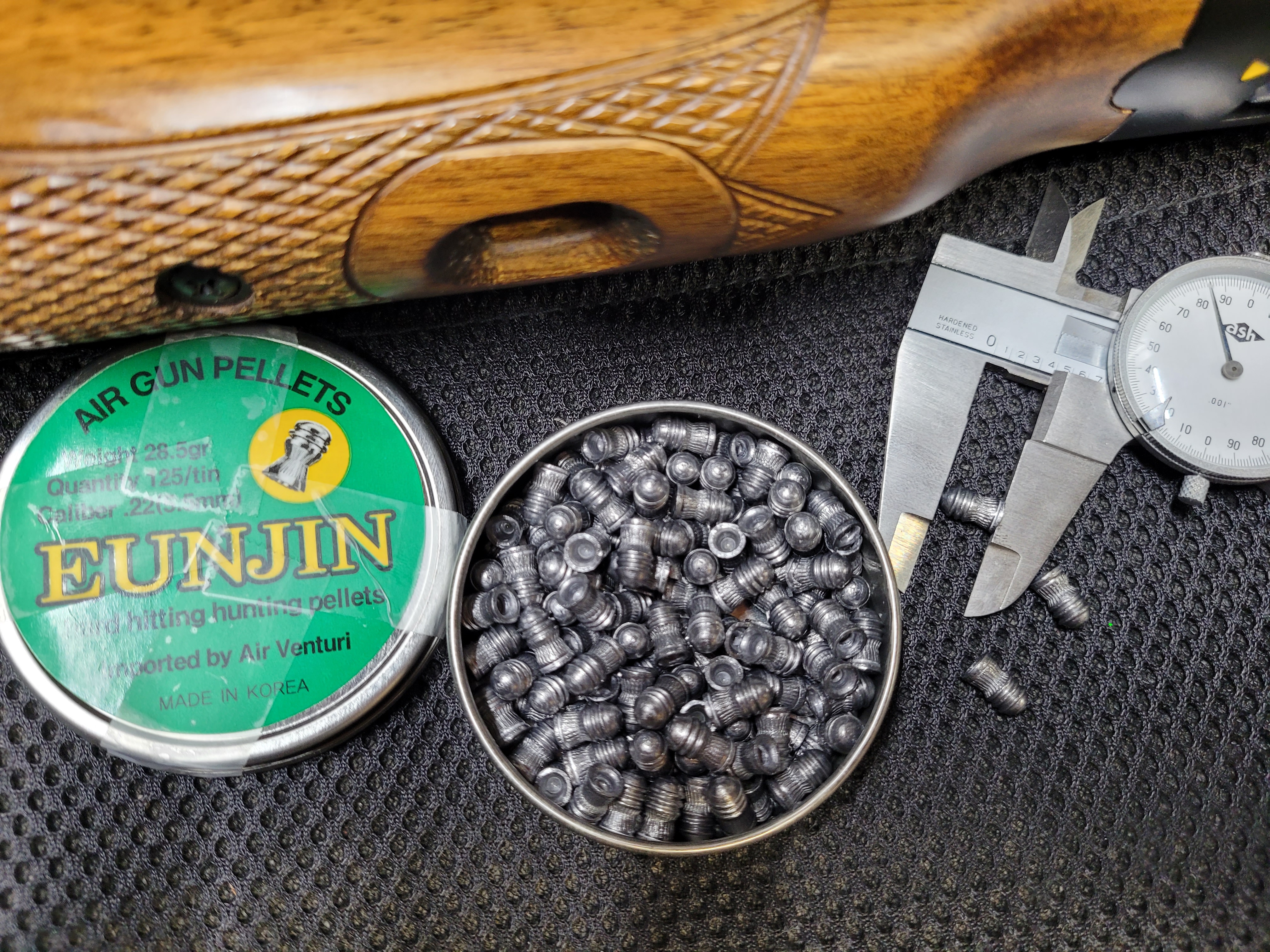

The factory mag from Davis is value priced, try one (3 more?). If yu might ever want to change pellets once you remove receiver cover it IS worth milling the cover as someone above mentioned. They all like the Korean ammo best. They also like flat bottom slugs of the correct length and have the power to push them tho with the famous Korean Cliff power curve. Any pellet who's tip slides into the bottom of the next pellet is Not a good choice.

Do you, or anyone else, know what diameter slugs the 5.5mm Career likes?
Update:
These beauties cycle plenty good enough. No need to take her apart and start messing around. Thanks for all the help.
