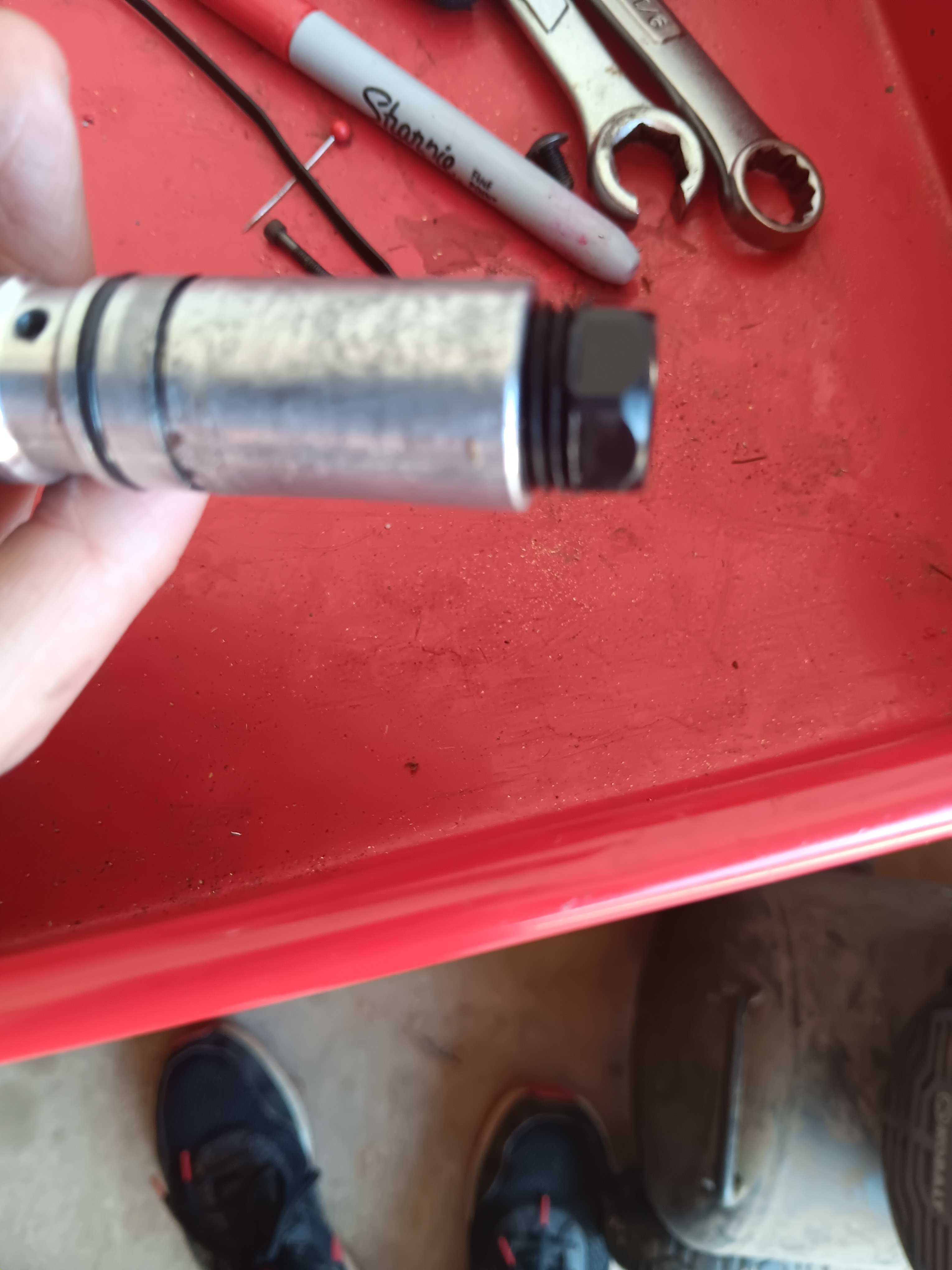

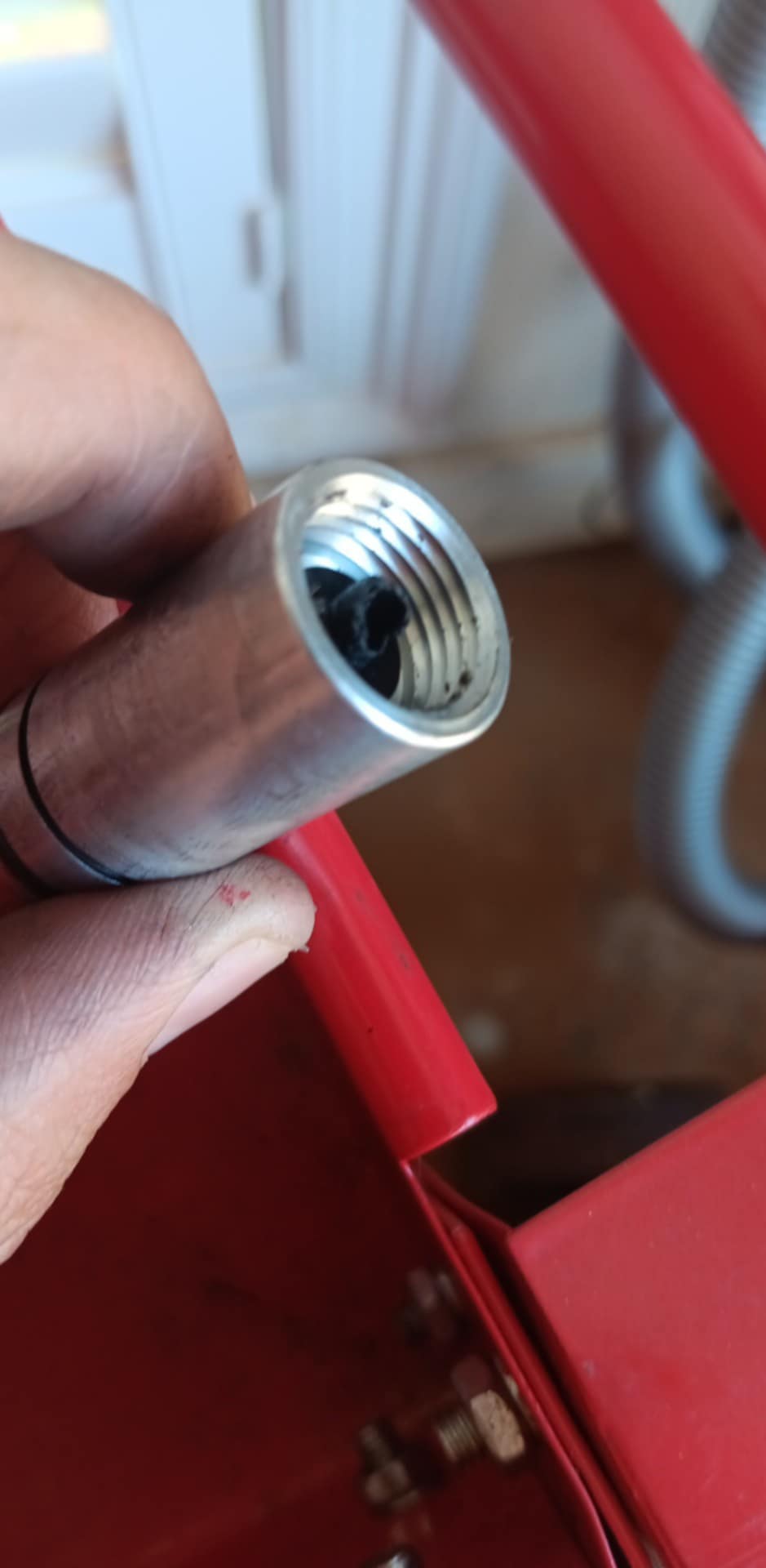

Well my shoebox freedom 8 wouldn't build any pressure at all the other day the black nut where the piston goes through came loose and I tighten it with a wrench big mistake.... I didn't know lol supposed to be hand tight.. anyway it made the nut and black piece break and crush into each other anyone else had this problem?

Yeah mine doesn't have the Allen key head bolt in the cylinder I'll let you know when I get it fixed should be Monday or Tuesday next week and very simple to fix.

I watched the video and decided since I had the cylinder already off to just go and rebuild it cleaned the check valve good and got all new o rings in it and Teflon tape I'm glad mine has the permanent ferrule on the air lines with the washer and o ring so you don't have to worry about the ferrule getting wore out and leaking.
