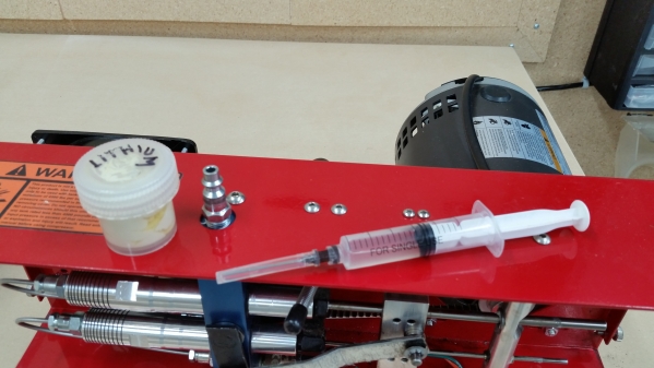

Put the lube on the support bushings where the rod slides through. I just smear the existing grease back on the rods every fill. To make maintenance easier, I put the oil in a syringe and the lithium grease in a little jar.

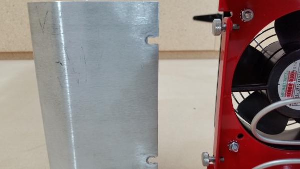

Another tip I did was mod the cover screws. I notched the holes, and used knurled nuts to remove it easier.
Great idea on notching the cover holes, and knurled bolts, will go to homers today and get some
