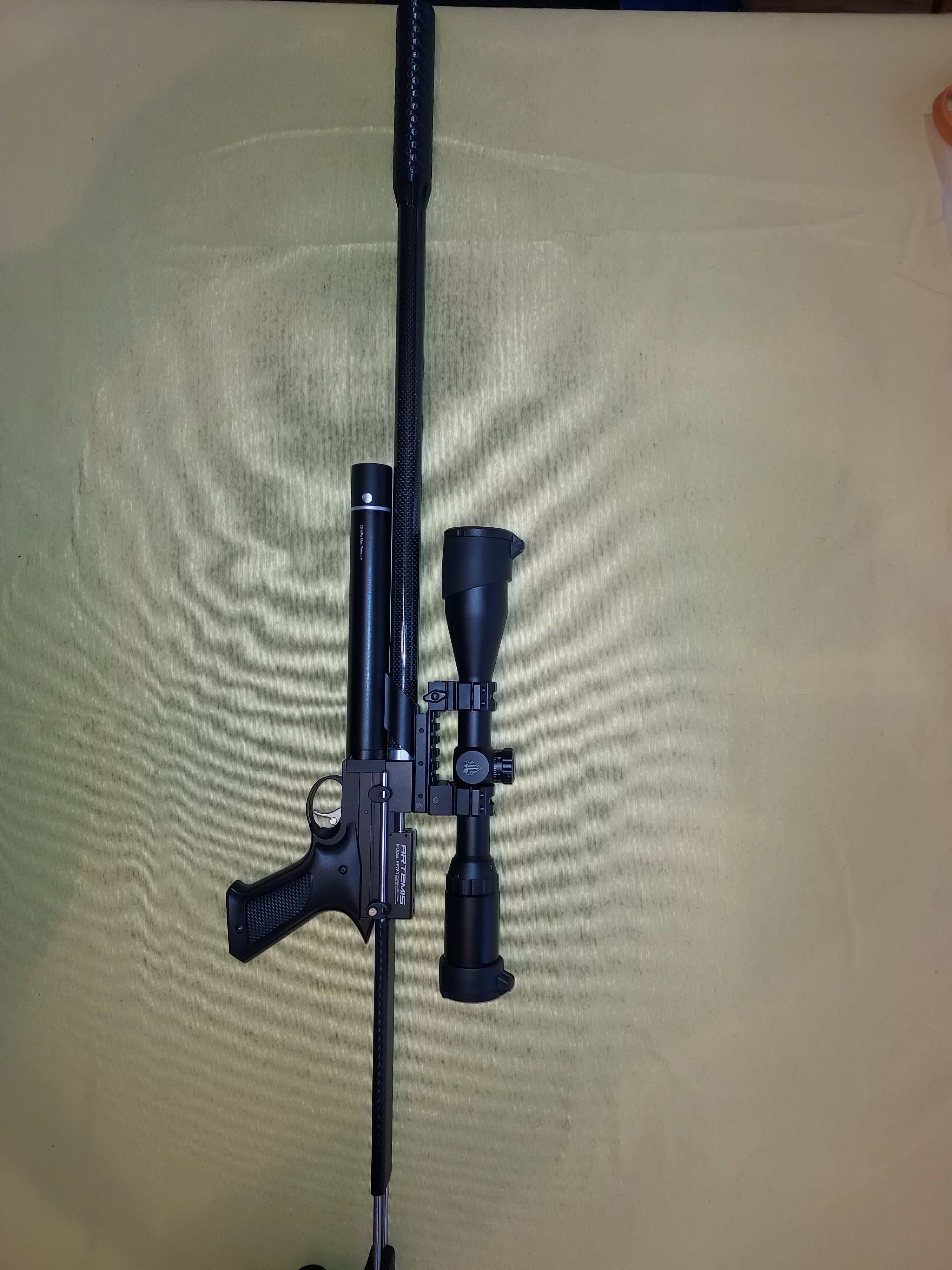

Well this PP750 was supposed to have been converted to a long ( Carbine ) full shroud barrel, but it came back like this and I don't have the ability to do all the required changes. So I will shoot it as a Pistol for now.

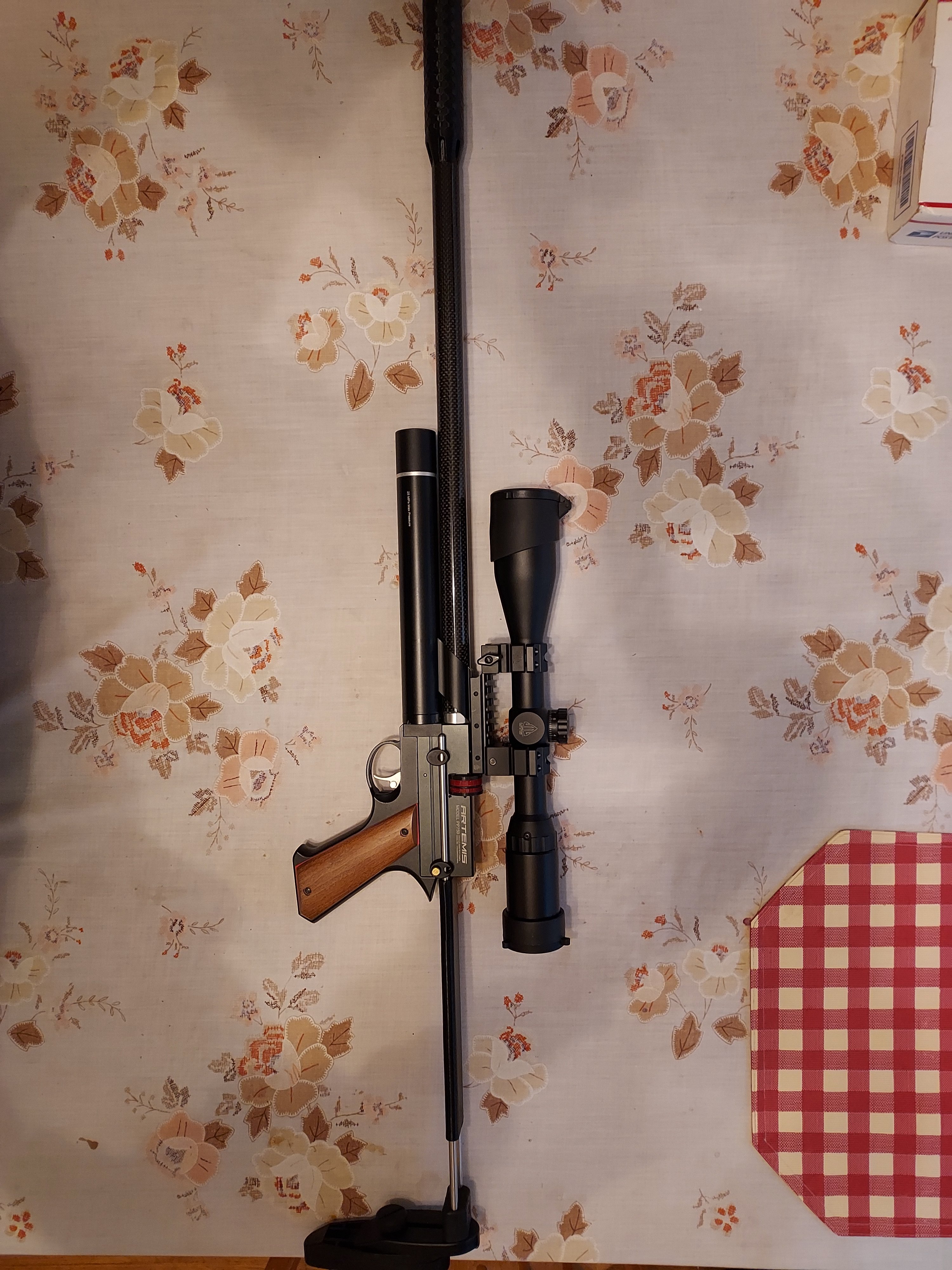

All I did was purchase the 17" barrel from AirgunArcheryFun and swapped it out. I added a BuckRail moderator that is thread for the Chaser barrel. I did 3D print pteg spacers that slide over the barrel, then put a carbon fiber tube over that. I want to buy better grips, thicker with a thumb rest. I can't find any for sale yet.

Hello,
Boy that looks good. Is your Pistol not black in color. Mine is all black.

Hi, Thank you for the compliment. I have seen some amazing carbine conversations on this site. If memory serves BioHazard did an amazing HW44 carbine, mine really pales in comparison.
My pistol is also all black. The red around the wooden grip plate is a 3D printer spacer, one on each side under each grip plate, to make the grip wider. This makes it a little easier for me to hold the pistol steady. Probably not necessary now that it's a carbine. The stock also has a printer insert that slides in between the rails. The insert is a little wider than the rail, so when I push it fully forward the stock doesn't twist as easily.

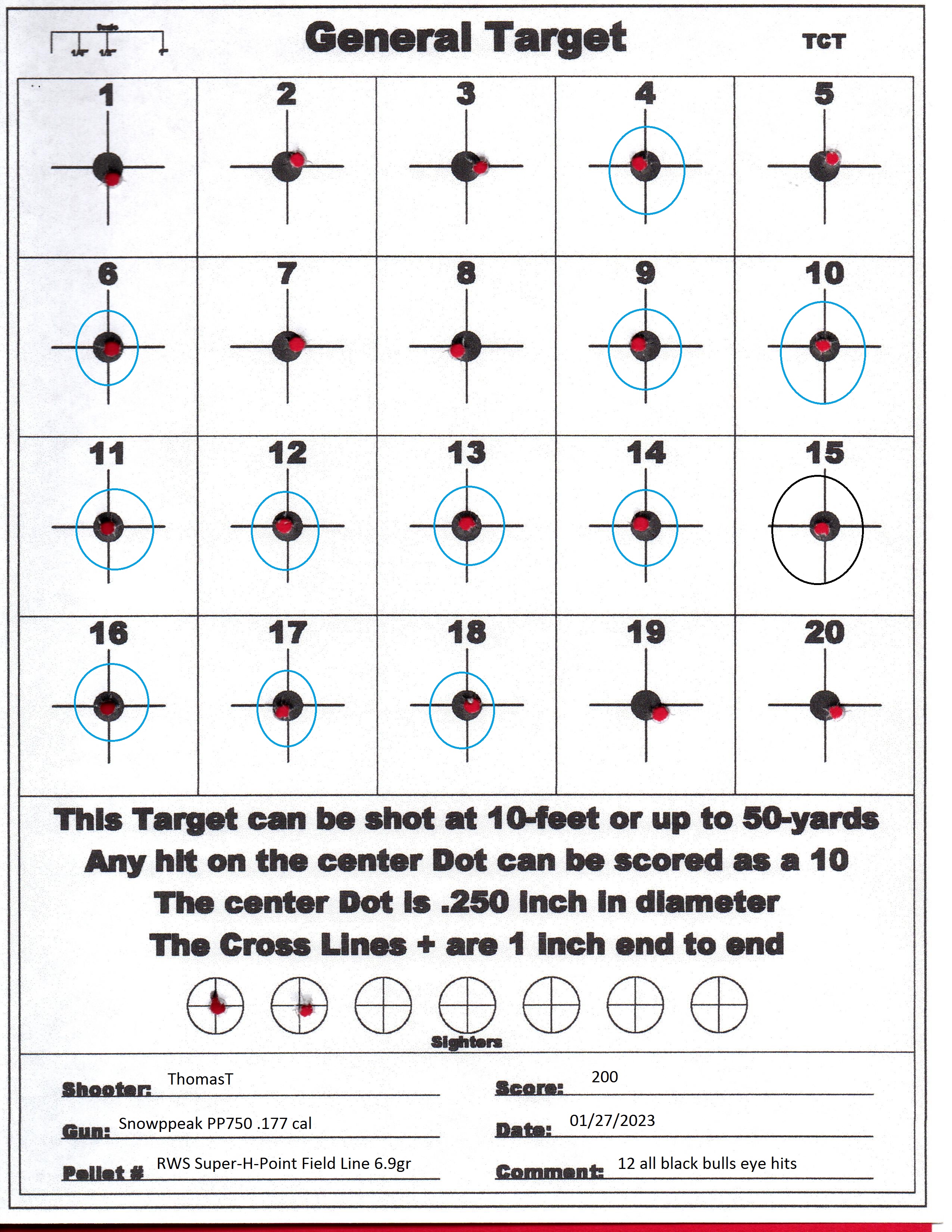

Hello everyone,
Well I just received a shipment of pellets and one new for me is the RWS Super-H-Point Field Line 6.9gr. I just had to put up a new General Target and see how these babies would shoot and not too bad. I drew a blue circle around each target that I shot all black bulls eye, a total of 12 out of 20. One thing for certain, this PP750 like this new pellet :love:

Hello @Raider03
Love the looks of your Carbine. Mine was supposed to be like that, I had ordered and paid for the long barrel with the full shroud but only got the barrel and no shroud.

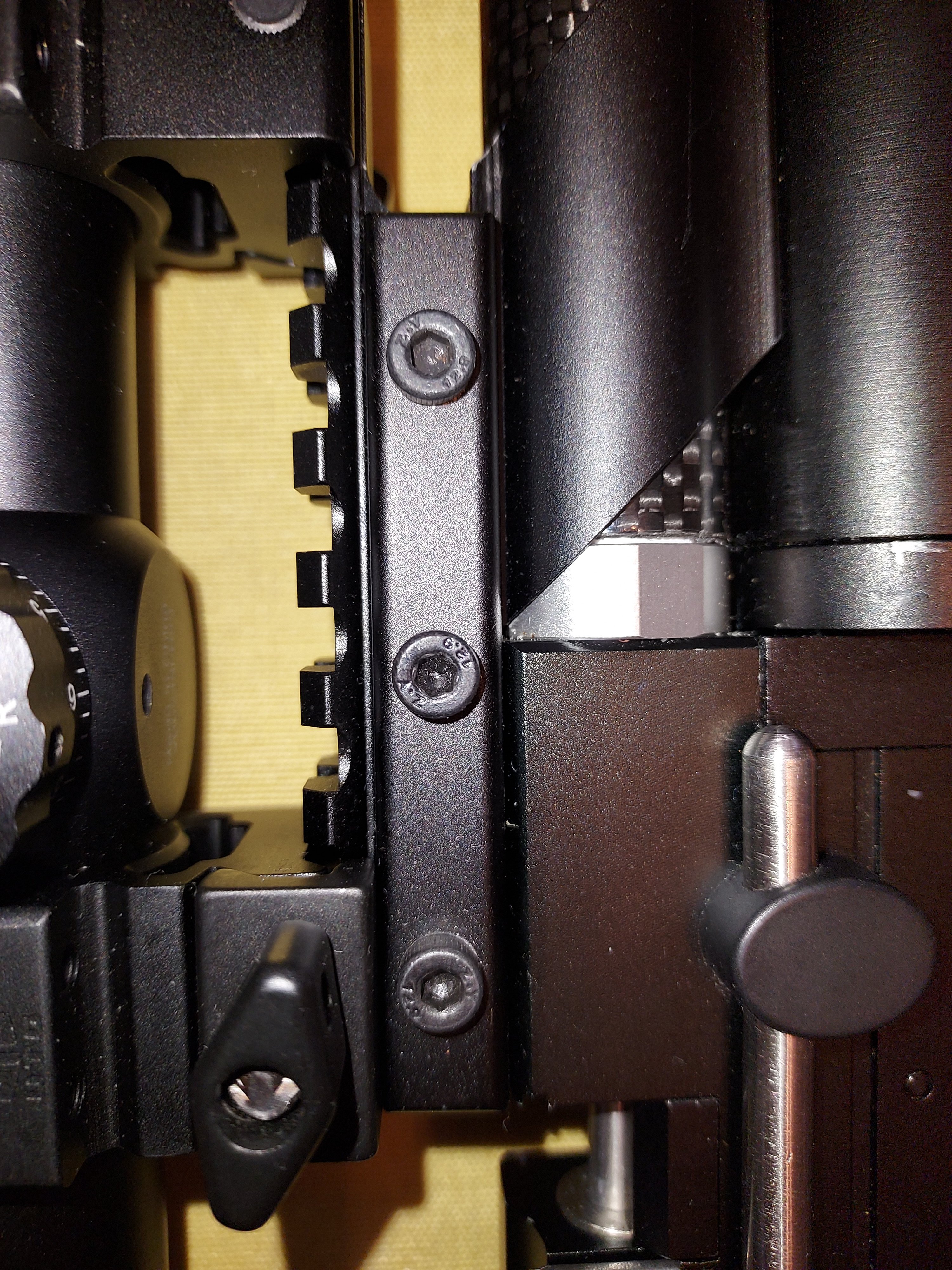

The way you have your scope mounted is one of those "adapters" dovetail to picatinny, is that correct? And if so is it good and solid? I like it.

Yes, it is an adapter from UTG. The front clamps onto the barrel band. The connection is solid. Purchased it on Amazon. Link follows. Should I print some petg spacers for you?

Hello @Raider03
I will order one of those, the close up photo shows it real well.

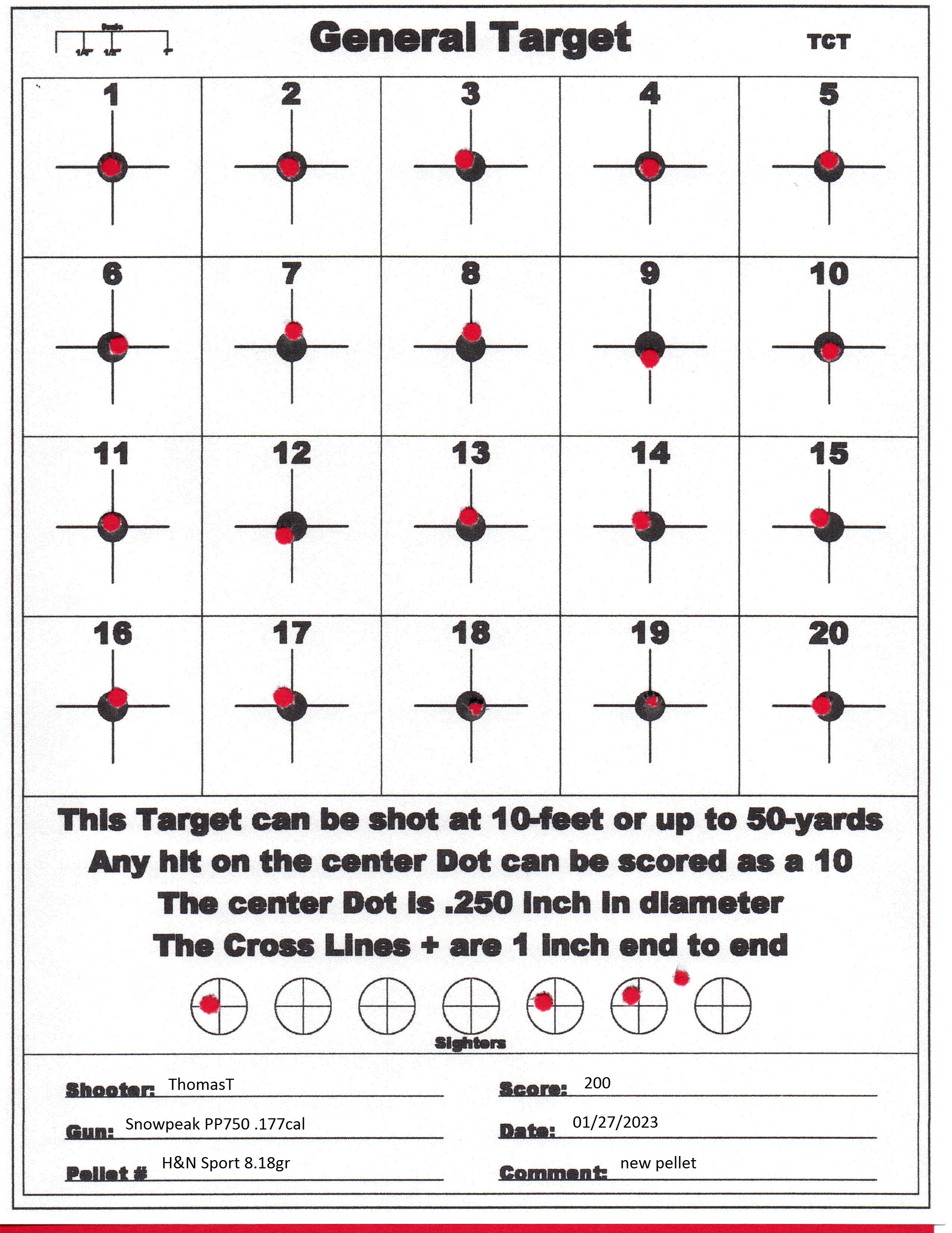

Hello everyone,
This morning I shot the General Target with my Snowpeak PP750 .177 cal using the RWS Supermag Field Line 9.3gr Wadcutter pellets. Cold outside but set up in my shop at 15-feet and was able to shoot a 200 score. I had to hand load each pellet one at a time because the pellets were very hard to load using the magazine. The domed pellets feed OK from the magazine but the flat face of the wadcutter caused way too much resistance for me to feel comfortable "forcing" them in.
