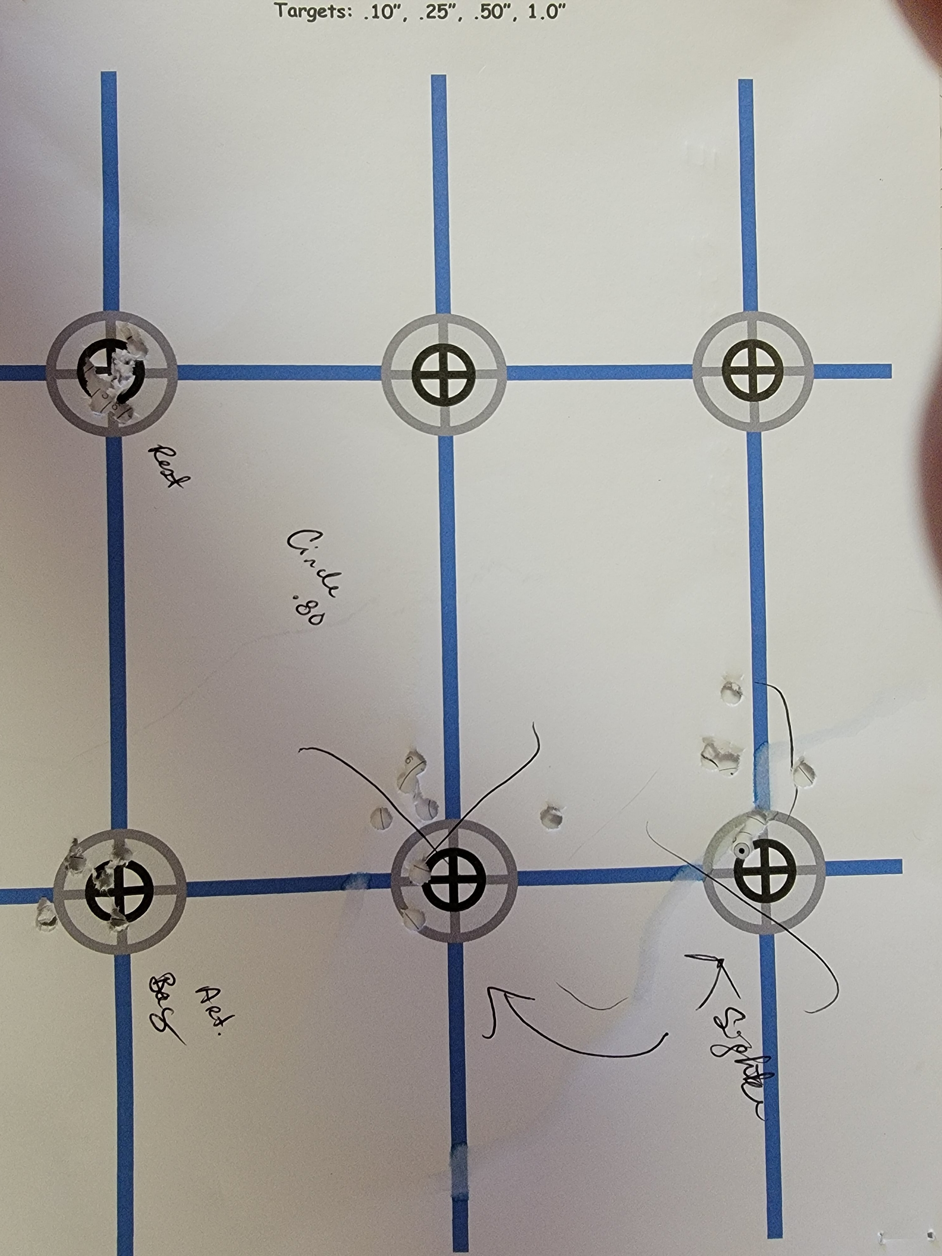

So I am playing with the 30 yard challenge here. In doing so I dropped a Mueller 40x56mm scope on my TX200 III. I went out to sight it in. At that point I tried the artillery hold used here and my "bench" approach I typically use.
Note I am really green at air rifles. I have 2 months with springers and years in rimfire. After sighting in I shot 2 groups. AA 8.44 gr. 4.51 Diabolo pellets. It likes those out to 50 yards.
This is only 2 groups mind you. However it fits with my .50" to .70" groups at 50 yards and 3" to 5" groups at 100 yards where I usually shoot.
Artillery hold had .64"ctc for 5 with .47" for best 4.
Bench styled free recoil was .41" ctc for 5.
