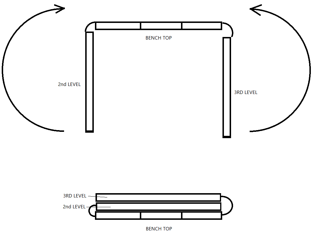

An easy seat height adjustment would be to simply hang additional plank on both sides of the bench to adjust up two levels.

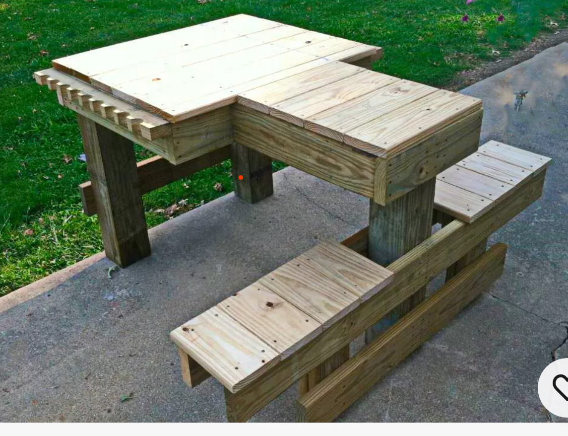

my range built basically the same bench as pictured , and they get shoved around all the tim , for what reason i do not know but it takes over an hour to straighten them out and measure distance to targets every match..

I am not going to use 6x6 legs. But I might use 4x4 legs and leave them 48 inches long. Then burry them in the ground so the bench is level and can’t be moved. Long through bolts and bracing should keep it from moving

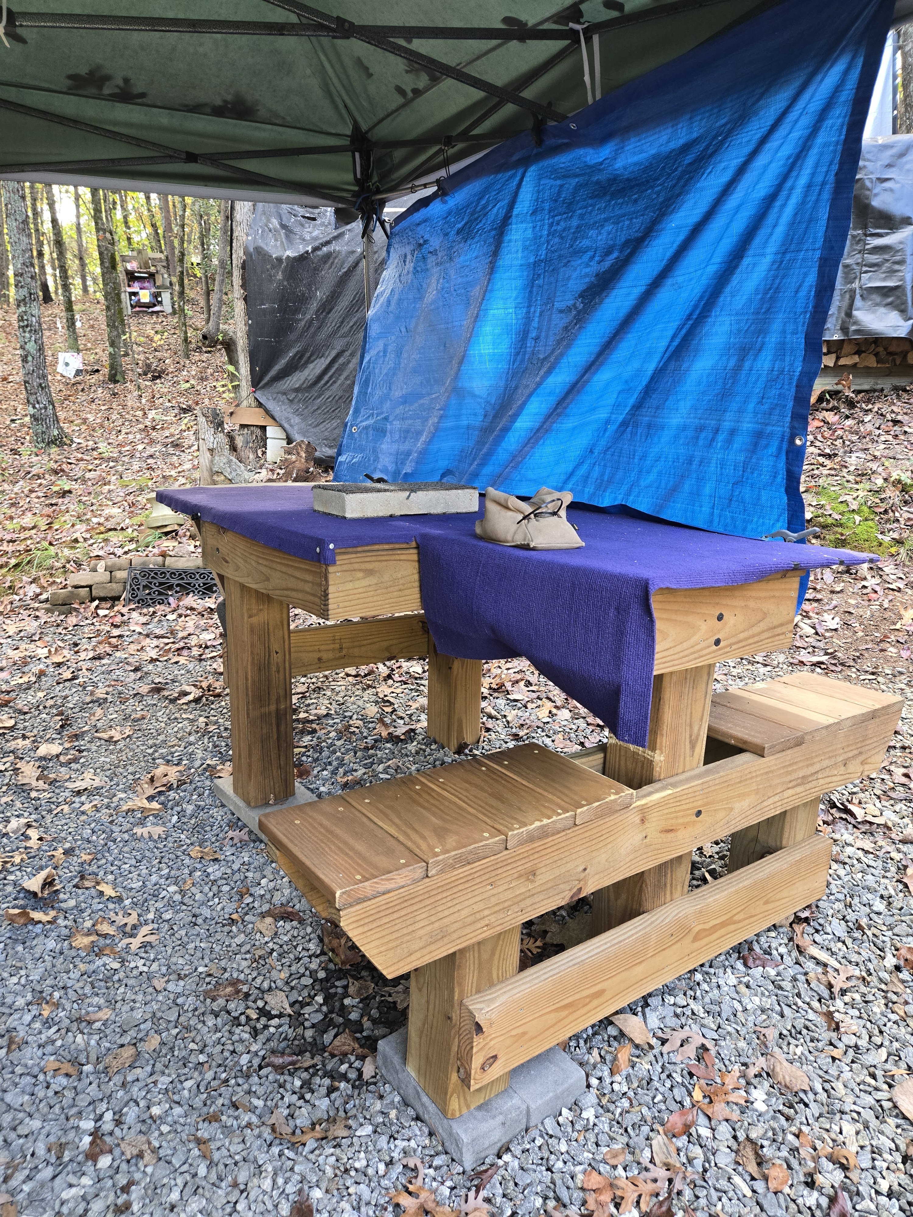

My bench stays under a canopy year round. I sealed it with Thompson's water seal . The top has indoor-outdoor carpet . Between that and the blue tarp , I don't have to search for empty brass in the gravel , when shooting my 10/22 . The bench is over 5 years old and still solid as a rock.
