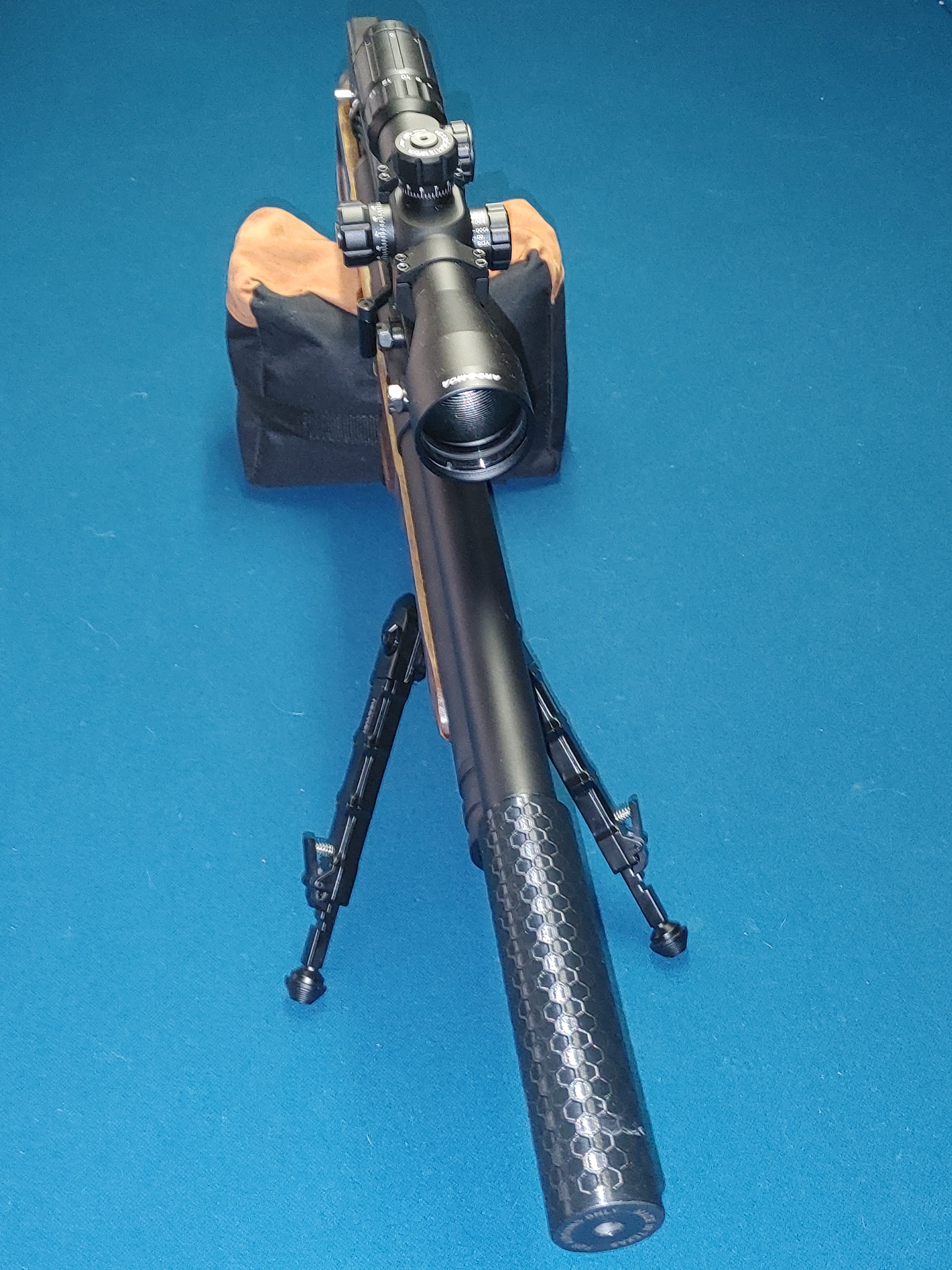

No idea how much energy this makes its a Kalibrigun Cricket 2 in .22 but I shot it again and I don't think I can hear a difference. If there is then its not that noticeable. Needless to say I'm not impressed with this Buck Rail moderator, at all actually pretty dissapointed in its performance. This is the non tapered version with the steel insert. The fit and finish are fine and it is ultra light but I cant hear a difference. Any other moderator recommendations that wont break the bank?

https://airgunlaws.com/georgia-airgun-laws/ I would encourage you all to look them up and make sure your in somewhat compliance.well if you have a shrouded barrel or a tension barrel with a cap , you can cut strips of just about any cloth(sweat pant material works good, kitchen dwawer liner alternated with sweat pant material works best strips 1.5inch wide wrapped around barrel behind any spacer and slide the shroud on leaving a space or porting for the air to escape from will make it an integrally suppressed barrel and you may not need the buckrail at all. smiles
