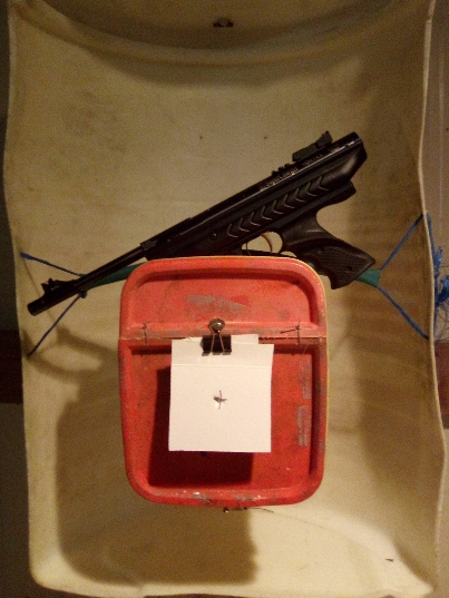

I got a his bucket stuffed with old rattie jeans screwed in a 1/2 55 gallon plastic drum as a oops back stop .
