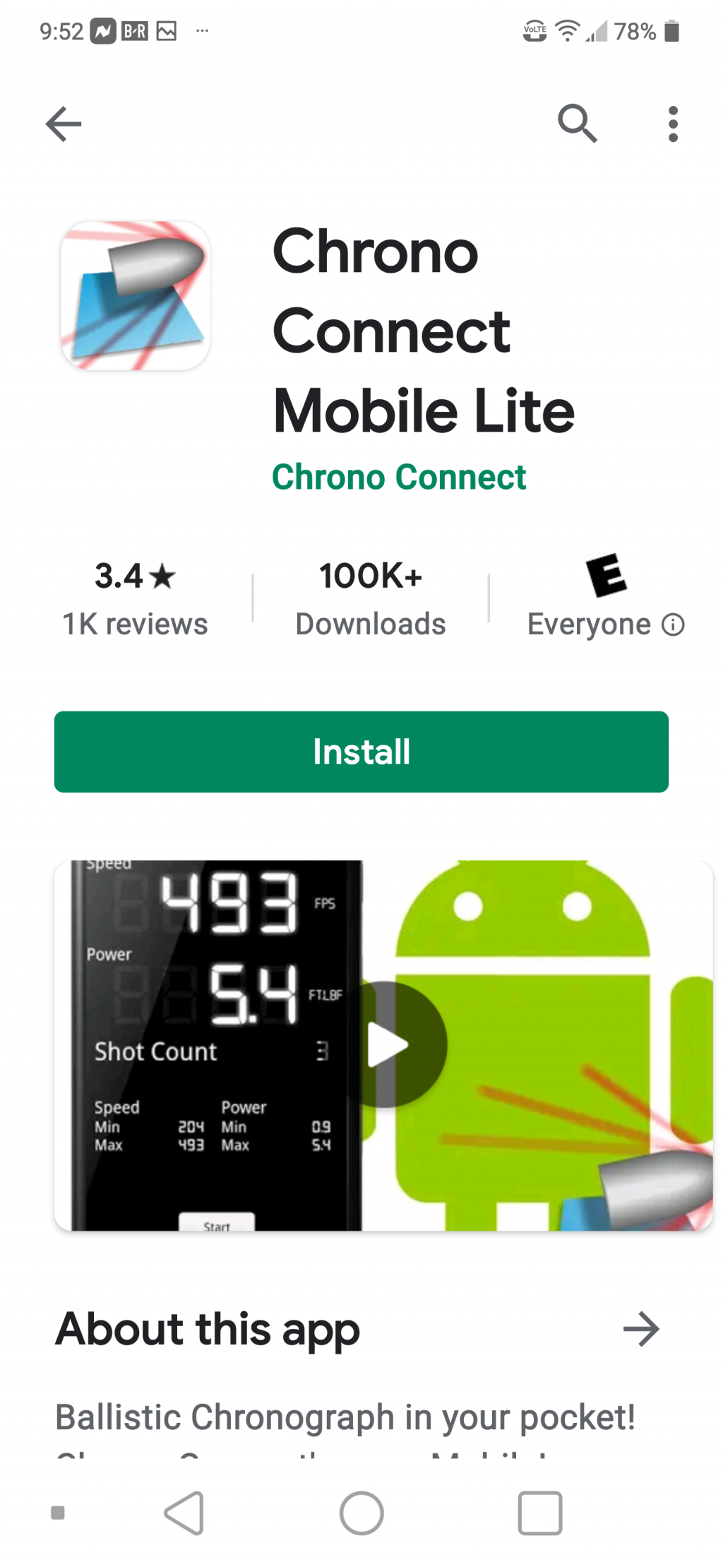

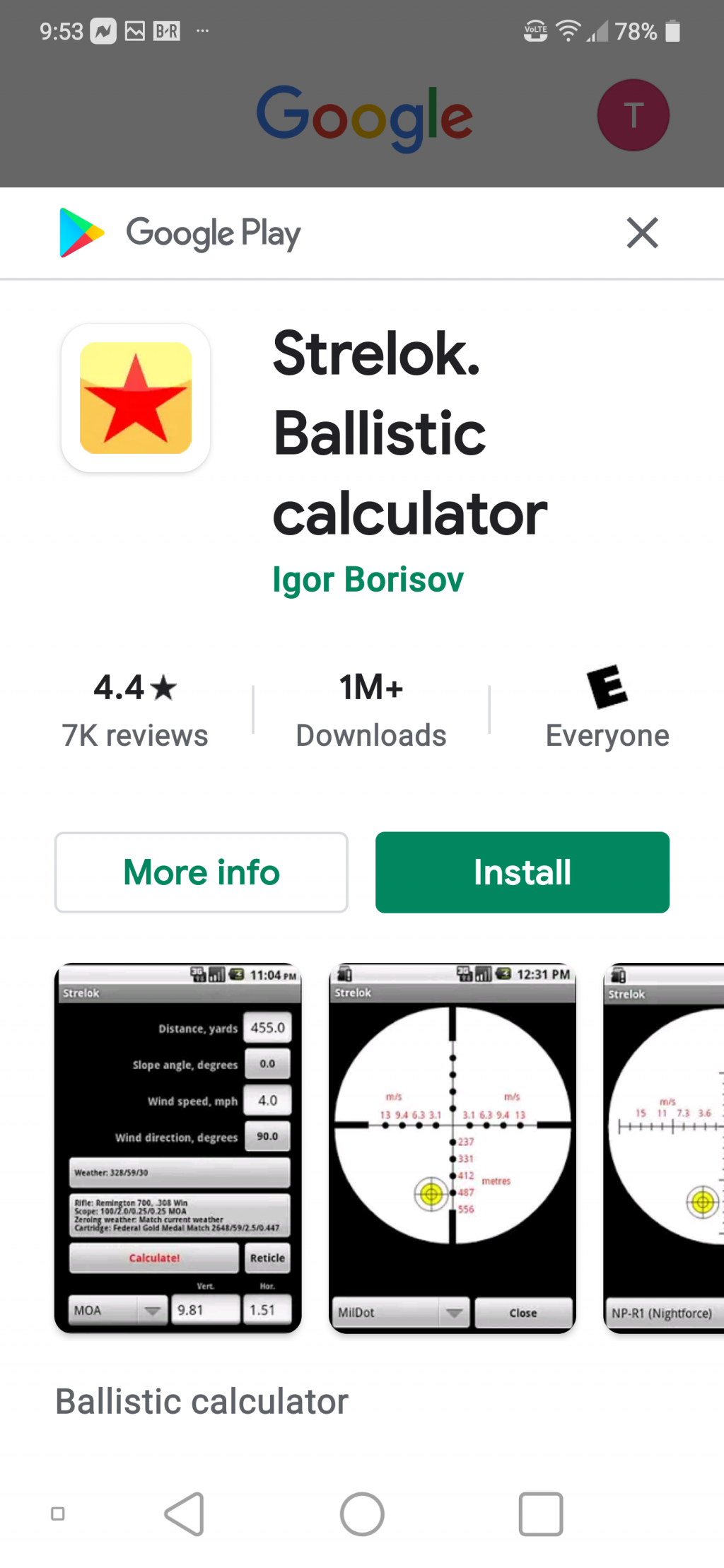

@ponsoldt2 As stated by others. You really need a chrony. Download these 2 free apps and hopefully this will solve your problem.
