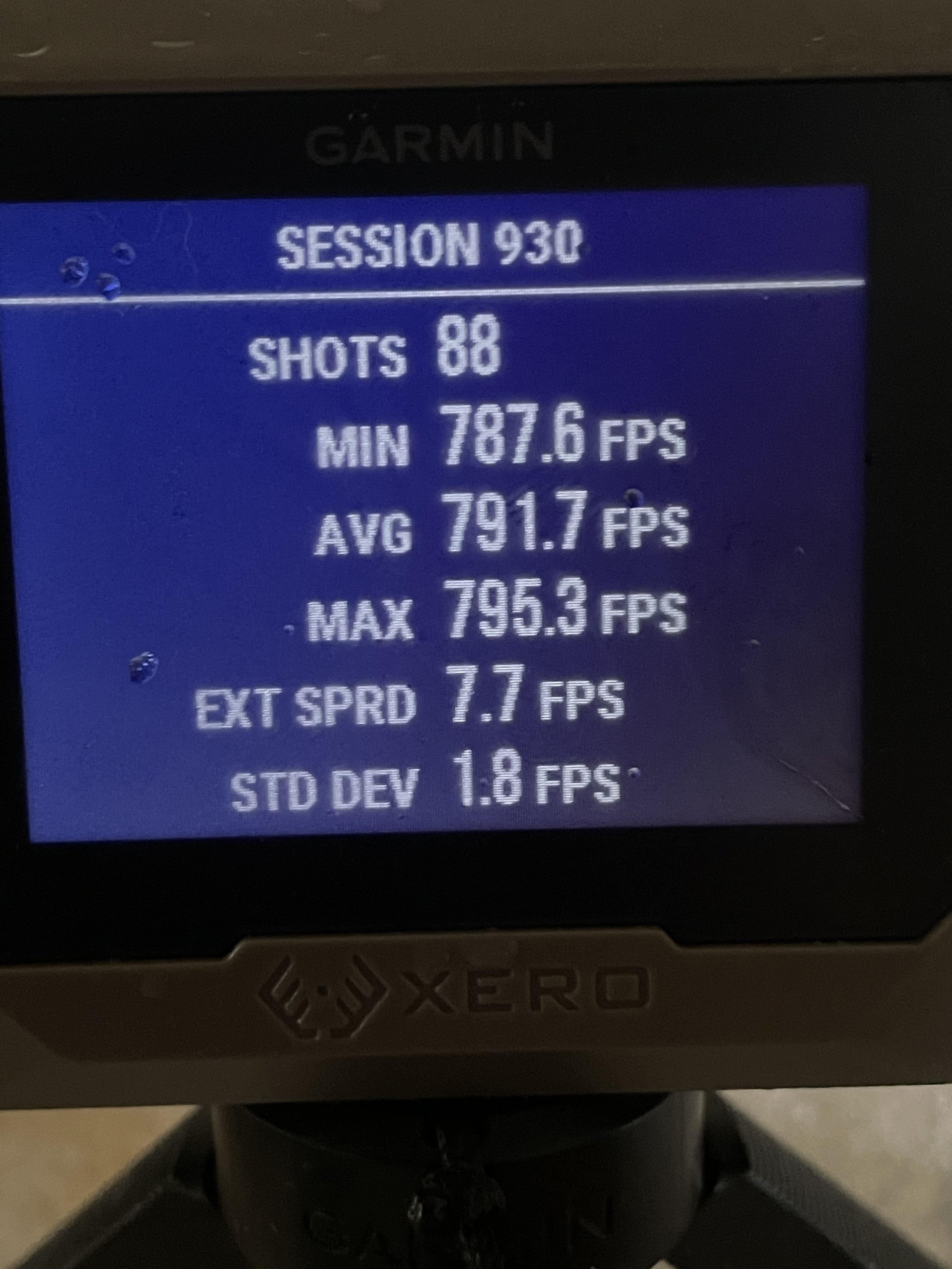

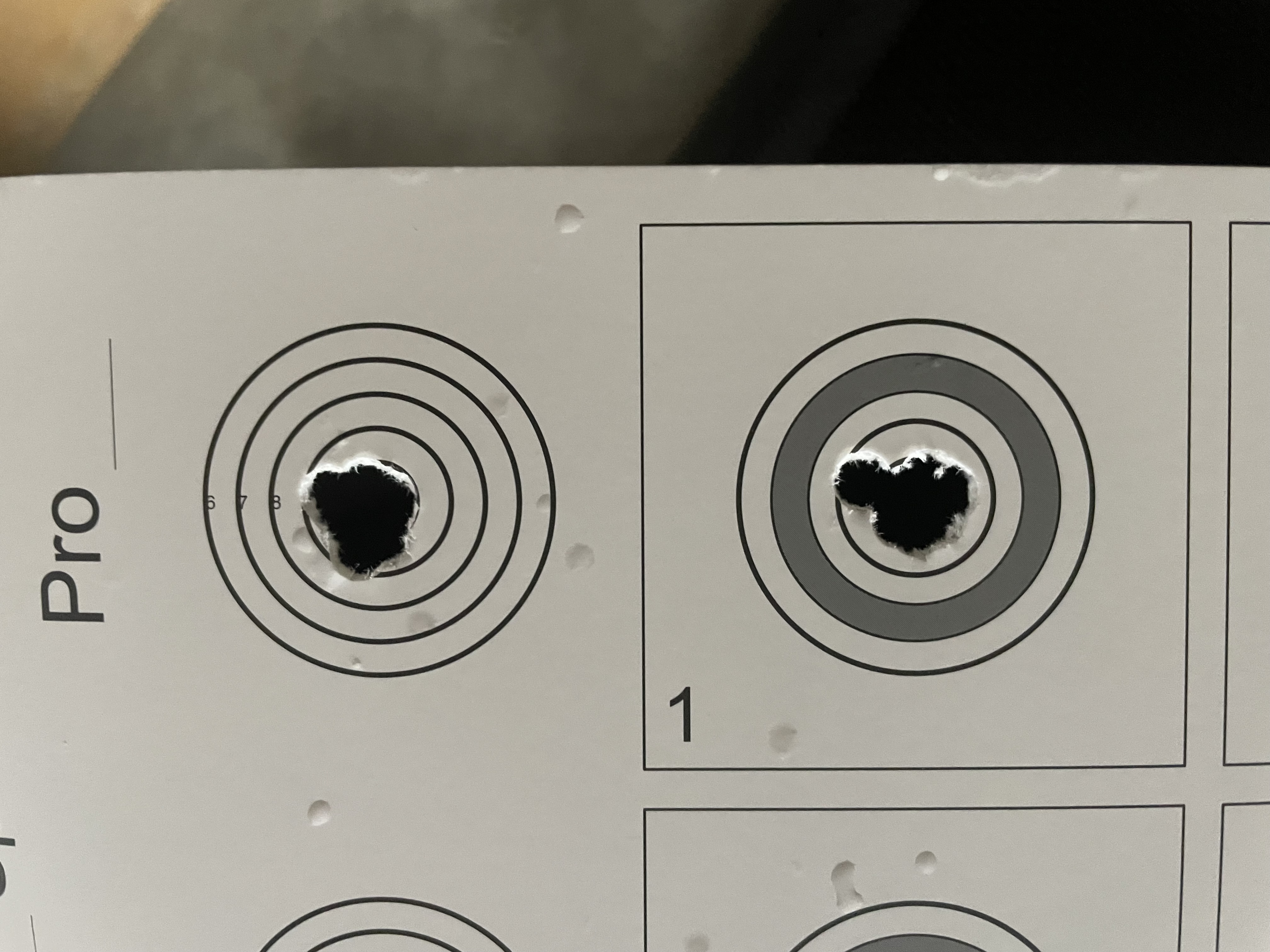

Here's a couple 25 shot groups at 50y using 40gr slugs going 791 fps. The furthest I have shot them is 265 yards and they did extremely well....although at that time I think I was around 830fps.
Mike
That's awesome accuracy! As long they they keep spinning to the yardages you are shooting, your accuracy should be good. When the spin slows is when slugs de-stabilize and go off line. That's pretty cool that you can get that accurate at slower speeds with slugs 👍
Yeah, it's a pretty sweet barrel that Scott machined! It shoots quite a few pellets and slugs with 1.5 MOA accuracy up to 50yds. A couple different pellets shoot under 1 MOA. I've been trying to find a slug that will get close to this. the JSB KO Mk II's are the best so far. I just need to find some space where I can stretch the distance out.
