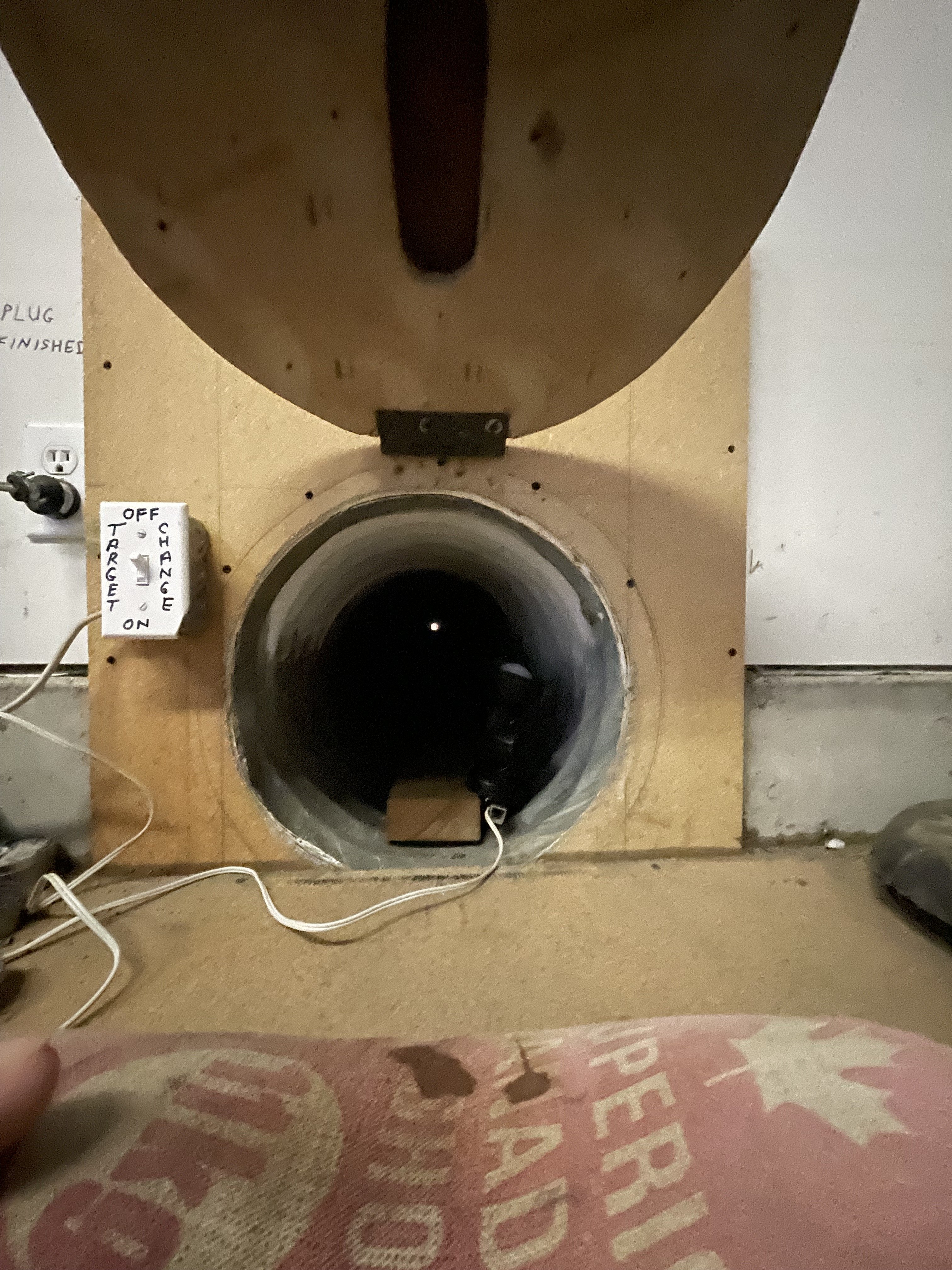

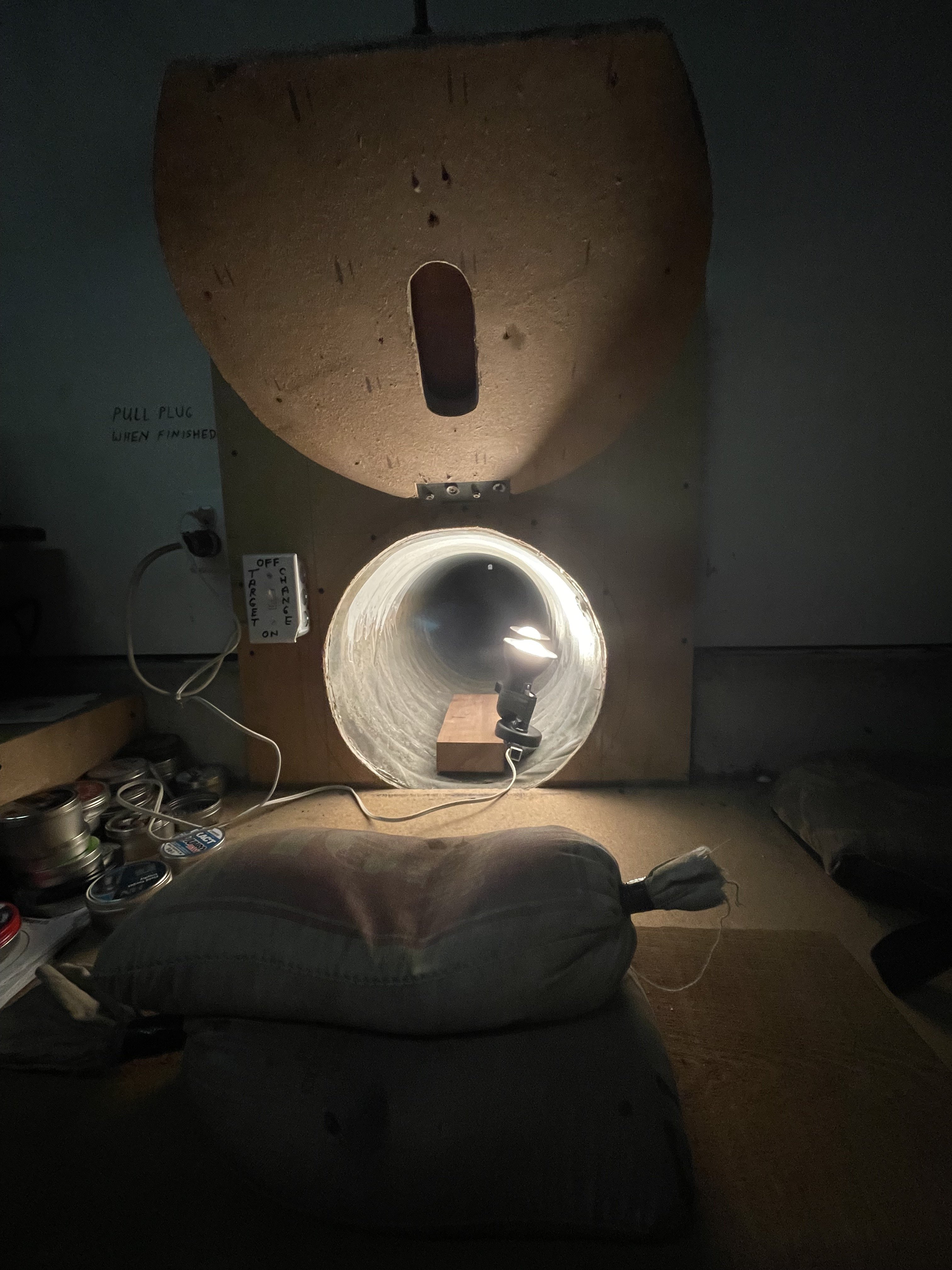

I used 18" culvert for my under ground 30 meter range. the lights are for my chronograph. Steve!

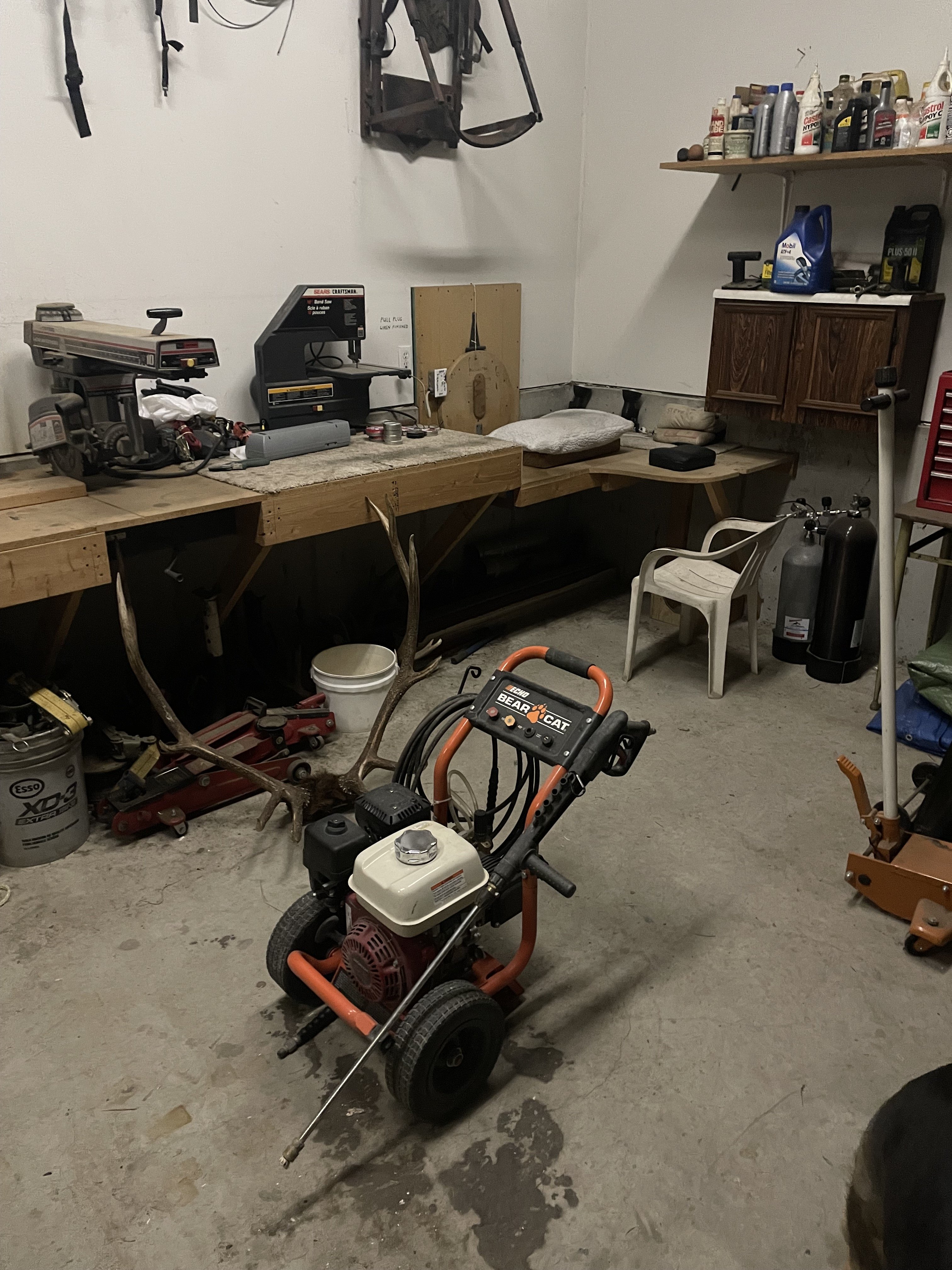

I have heated workshop and shoot there all winter with my pellet guns keeps me out the house.lol, The ground slopes up away from my shop so the other end is about 8' under ground.I made a frame up with a 3/4" steel plate at the back and a couple of rollers on my lathe to fit a roll of meat wrapping paper on it. there is knife sharpener motor to roll the paper up when I turn a switch on and stop it when I have a clean sheet of paper to shoot at. I just shoot a pellet at it and then shoot at the pellet hole for a target then move over a couple of inches and shoot another hole and another 5 or 10 shot group. I can not change the distance only 30 meters. I was going to go 50 meters but had to dig over my water line to the house and I thought better of that.I only shoot .22 long rifle and pellet guns in the range.A roll of meat rapping paper will last me all winter and half the summer.Steve!
