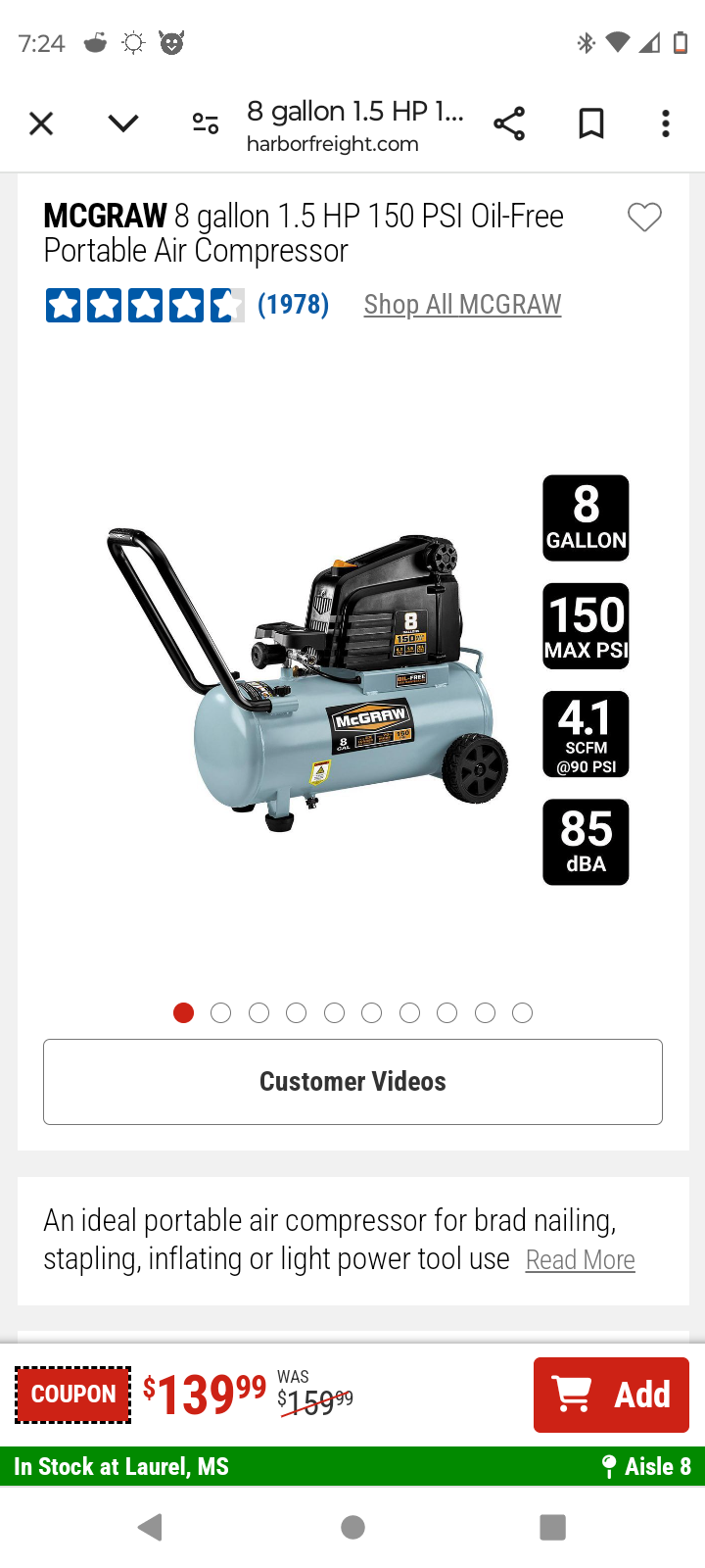

Is this air compressor good for the altaros booster pump I'm filling a 45min scba tank and a small guppy tank I'm not insanely worried on fill times

I have a 60 gallon 12 scfm @90psi gonna see if my dad will let me use it... Or I might buy a cheap 5scfm air compressor from harbor freight or Lowe's Ill be filling a small guppy tank and a 45 min SCBA tank
60gallon 12scfm @ 90 psi sounds great. At the same restrictor setting as mine, since I'm at about a 2:1 rest to run ratio, you'd have something like a 4:1 rest to run ratio. Napkin math here, since you've got a bit better than double the scfm.
As for the 60gallon versus 20gallon tank in the compressor, I'm a bit less certain on the math there. B/c you've got 3x the volume, but your compressor will also have to run for 3x as long on each cycle as mine does. But it'll also sit without needing to run for longer than mine....might be a wash. I think the more relevant difference is the scfm, of which 12 is much better than 5.3. 😃
