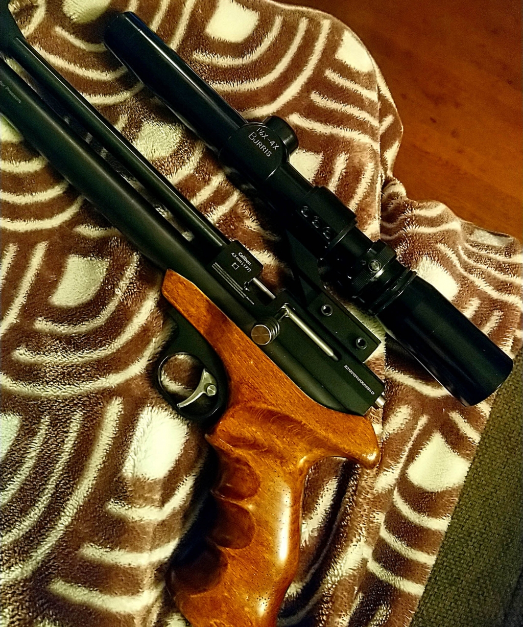

I'm working on a 1322 PCP project. Customs has been holding some of my parts for well over a month 😡 But when I'm done, it should be about 12" long. Shoot 16gr around 600fps, and be quiet.
I do have a diana bandit that I've detuned. I recon if you cut the barrel down to 6.5 or 7" you'd be able to hit that target velocity. And have a couple inches for a moderator. I had mine shooting 850fps with the factory 9" barrel. But I've got it regulated down to 630fps.
However, you'd still have to deal with the fact that the bandit's grip is pretty uncomfortable. I fixed that on mine.

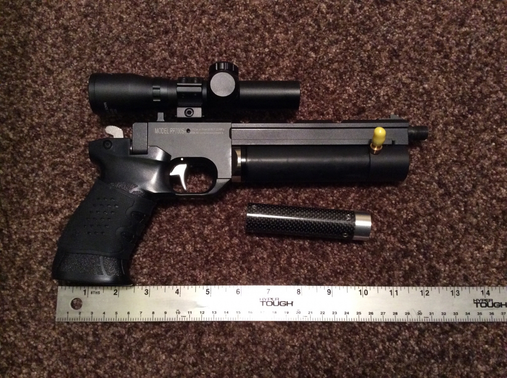

This is the best I could do when I had the same need as you. I chopped a PP700 because I wanted a smaller balanced pistol. It shoots 8.80gr Crow magnums 710fps for 16 shots. The ES is usually around 5fps and it’s only 26 pumps with the Hill to fill it back up. Accuracy is insane thanks to the Huma, LW barrel and hours of fine tuning the valve,HS and porting. You can’t buy it so sometimes you have to make it.
Very nice work. Which end of the air cylinder did you take off?
Didn’t use the original. Saved it in case I sell the gun. Guys seem to like sticking stocks on the full size pistol.
I took an old Crosman barrel, put it in my lathe and machined it to fit the receiver. Started at 10” and tuned the gun for max performance and shot count. Then I cut and crowned the barrel at 9” and did the same thing. I kept taking an inch at a time off the barrel until I got to the lowest velocity that was acceptable to me. When I got to 7”, the gun was a little too slow and didn’t tune as well. I looked at my data and decided on 8.5”. Then I took a LW barrel and made it 8.5” and machined it to fit. The pistol definitely shoots better with barrel tension because I tested it both ways. So I threaded the end of the barrel, made a barrel nut/mod 1/2unf adapter and crowned it so it looks clean. I cut the factory shroud, made a short tube and prayed for as many shots as possible. My favorite .177 hunting pellet is the Crow Magnum. This gun loves them and I regularly take birds out to 50yrds with them. The amount of hours I have in this gun is crazy but it was winter time and that month went by rather quick. The finished gun is still a little cheaper than my Ataman AP16 but not by much.
Very interesting information. Indeed lots of work but it makes for a truly unique piece that seems to work well for you. I'm still wondering about that air cylinder, how you modified it and what you started with. Was it another stock pp700 cylinder that you modified or other?
