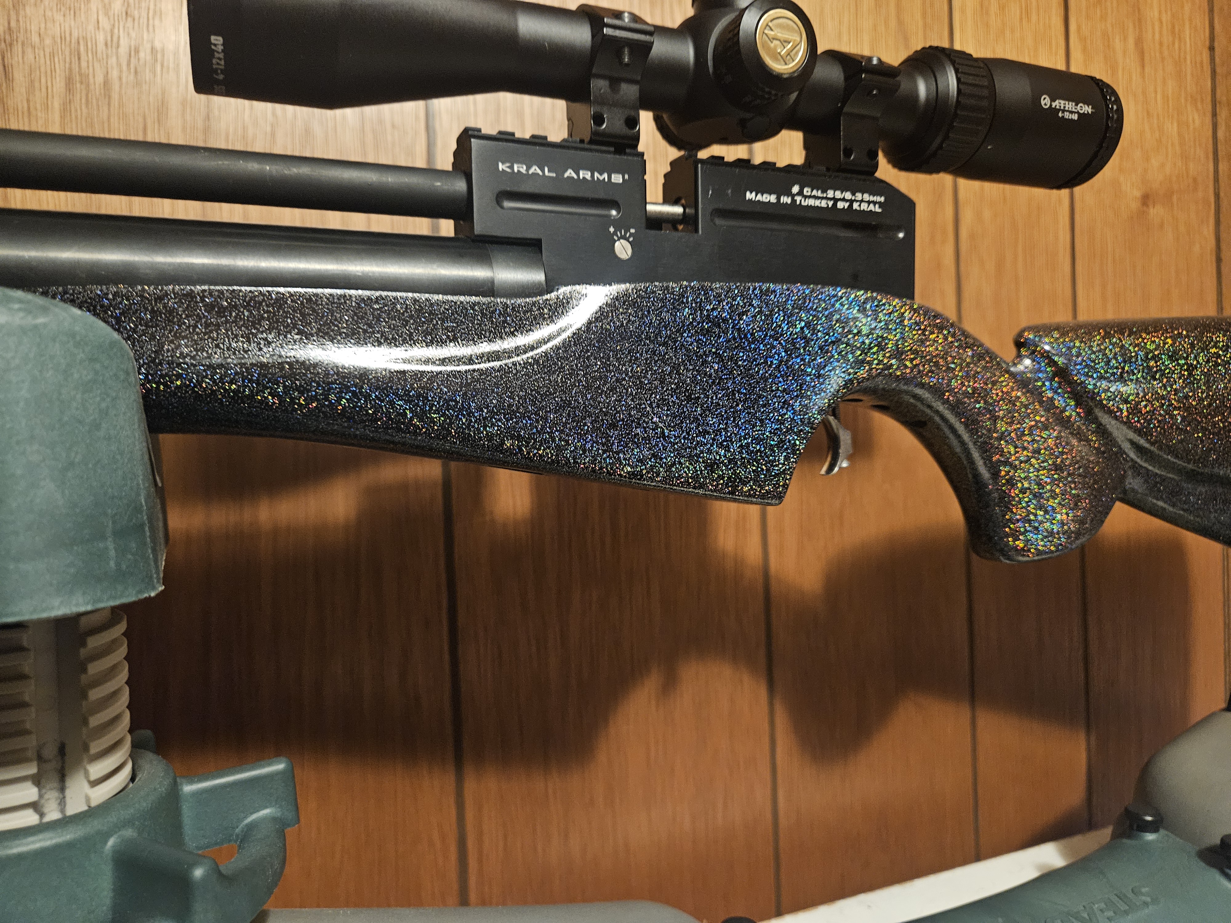

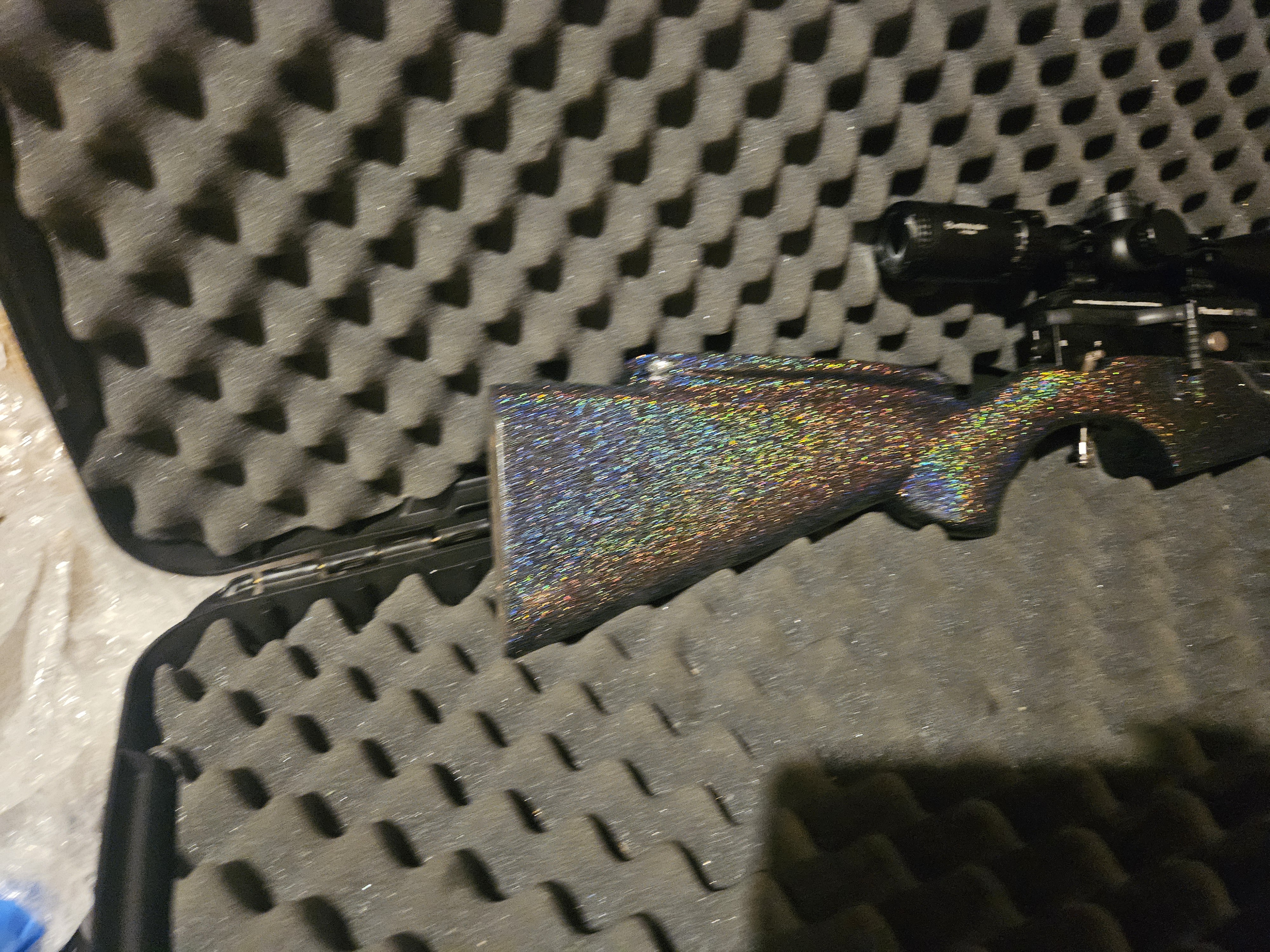

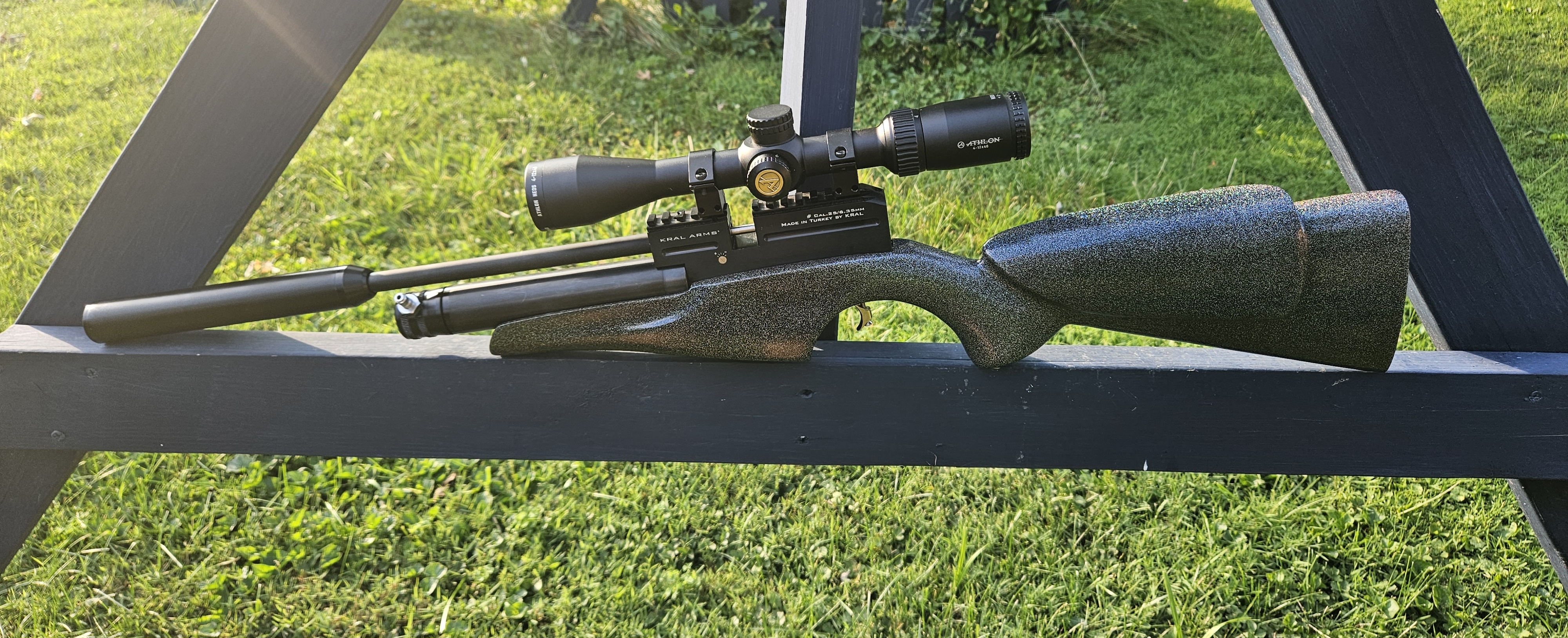

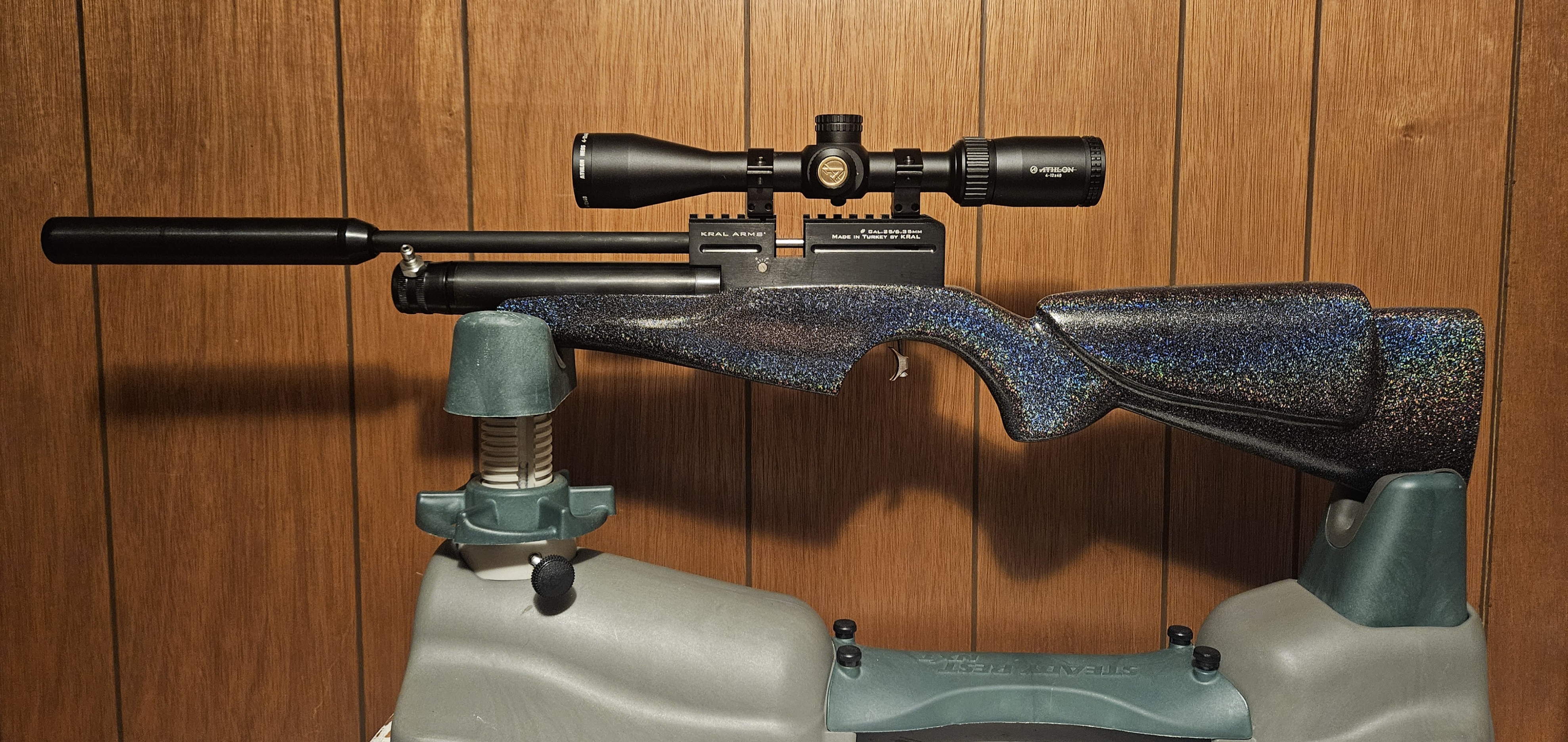

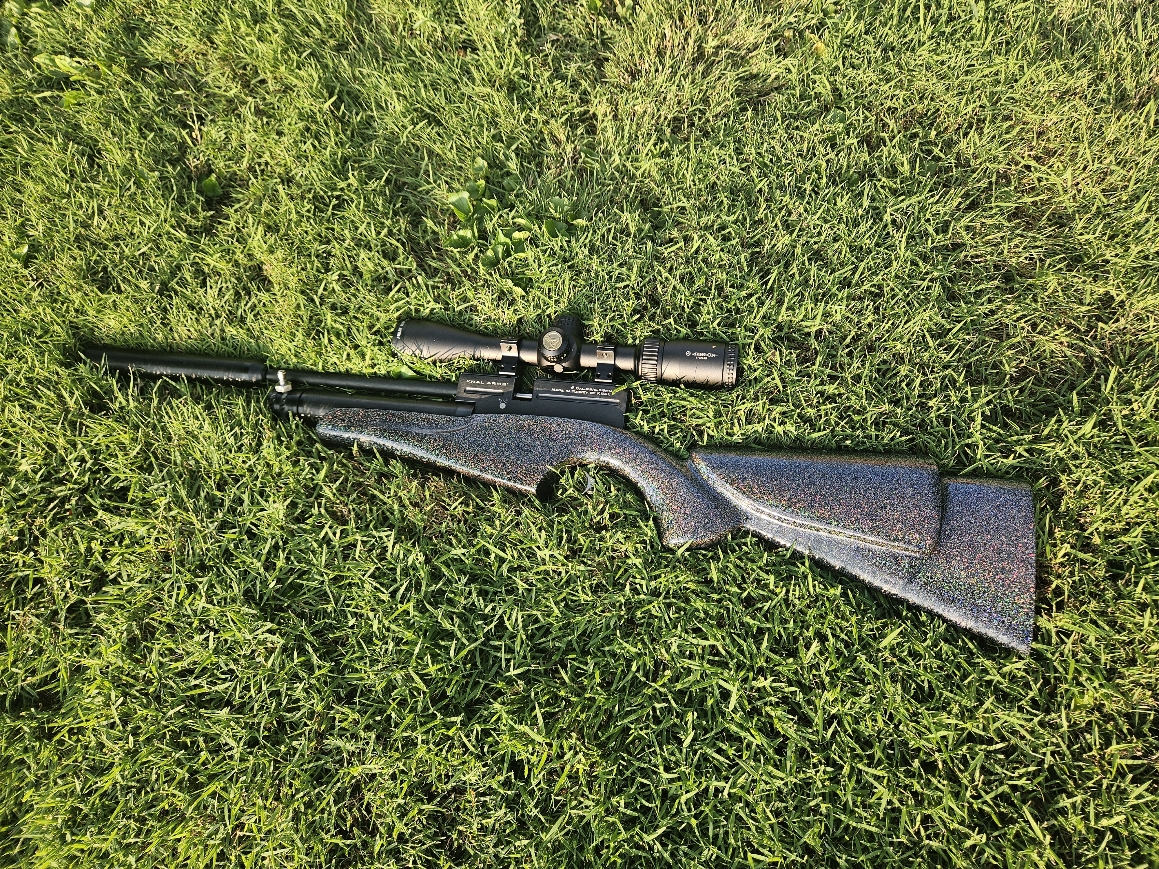

This is probably the last Kral I will build. Parts are drying up with Kral making guns for other brands, and the customer service at Canada shooting supply has taken a nose dive as of late.
I ordered their last np01 25 cal barrel, an np03 breech I modified to a rifle trigger, and the np02 tube I got from @moodyblues.
Grafted a fore grip off some other gun, reximex or something like that. It fit the tube, but was busted in half so I used the front on this. Molded a butttock from a mauser stock I still had left and then carved/shaped to my liking.
Decided to go a different route on the finish and did an iridescent rainbow pearl over it. Some call it Galaxy paint.
Anyhow, the pics don't do the finish justice because the camera keeps trying to correct for the hue change.
Moderator is actually very good and is a Kral factory unit. Got this tuned for 700 fps for 20 shots with JTS 25.39 and they just stack and stack. It's almost boring to shoot lol. Well, a few sparrows found it quite shocking when I was out testing it before finish. It is super quiet and will probably get plenty of backyard pesting use.
