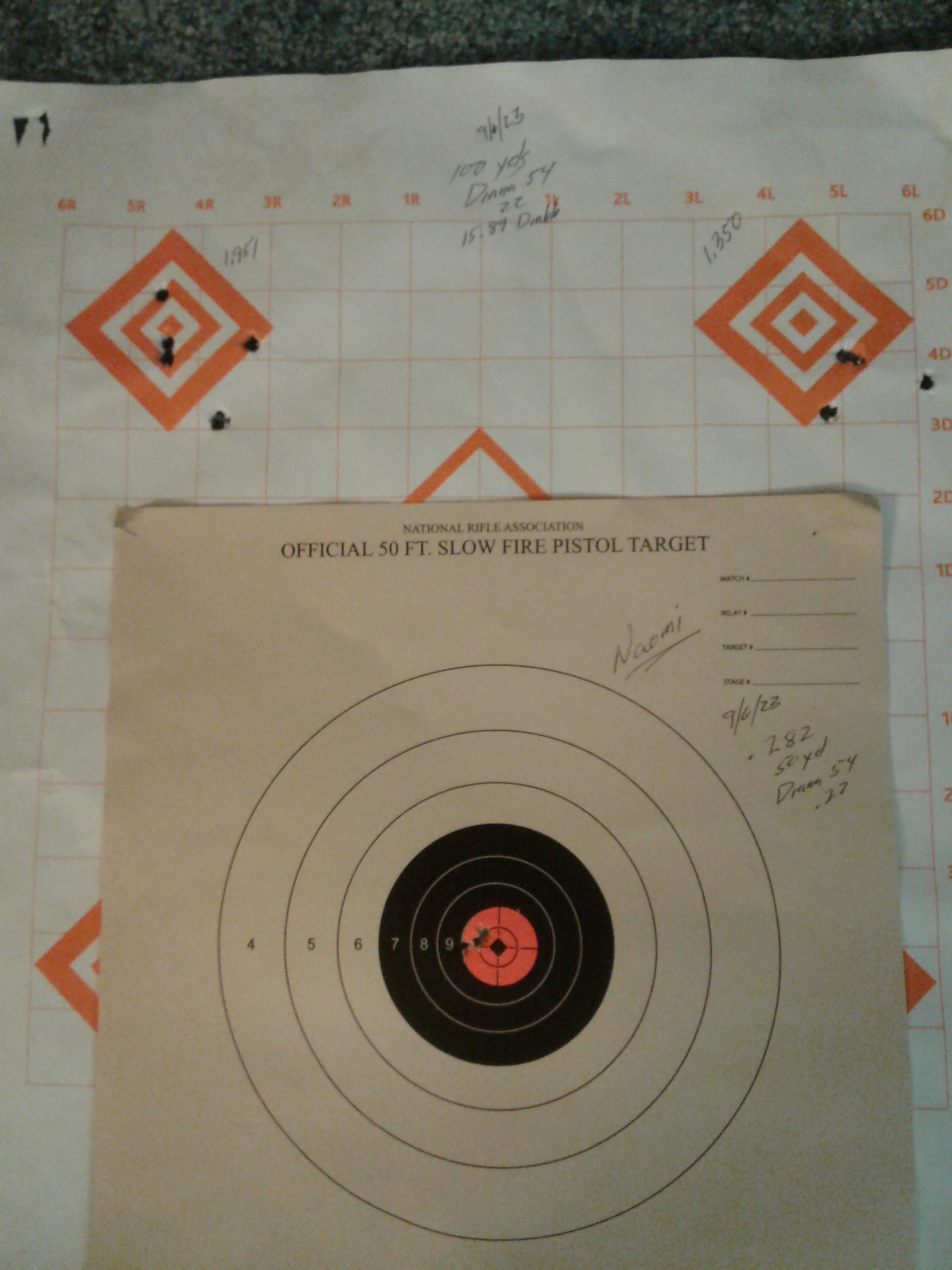

Are you shooting a PCP of a spring gun? Huge difference in many aspects. I can only speak from the spring gun side. The ideas that pellets aren't stable at 10 yards to me is baloney for this reason. Pretty much all pellets we have shot hole on hole at 10 yards. The pellets that don't shoot at 20 meters we shoot at 10 meters and win with. Typically with good pellets at 20 meters 5 shot groups do not show under the base of a .223 case. The groups that make us smile are a small hole not quite perfectly round. Take that to 50 yards, I consider .5 center to center very good and .6 ok. I am speaking .177. Now .22 out of my D54 at 100 yards I consider 5 shots under 2 inches very good. I have had 4 shots make a fat hole several times but then 1 of the 5 leaked out to make it 3 or 4 inches. Must use flags outside or your kidding yourself plus pretty good conditions, especially at 100. Big difference with .22 pellets at 760 vs .177 at 8.4 fighting the wind past 50 yards in my experience. Best day at 100 was back to back 5 shot groups under 1.5 inches.

These are the only pics I have. The 50yd target my wife shot was
That 50 yd Target was the first 3 shots my wife ever shot with an air rifle. I did almost no outdoor shooting with the airguns last year except for hunting groundhogs. The target my wife shot at 50yds I have shot with my TX at 50 and it will pretty much shoot all 10s. Again, conditions are a huge factor. I admire shoe of the groups I see posted off buckets and sticks.
