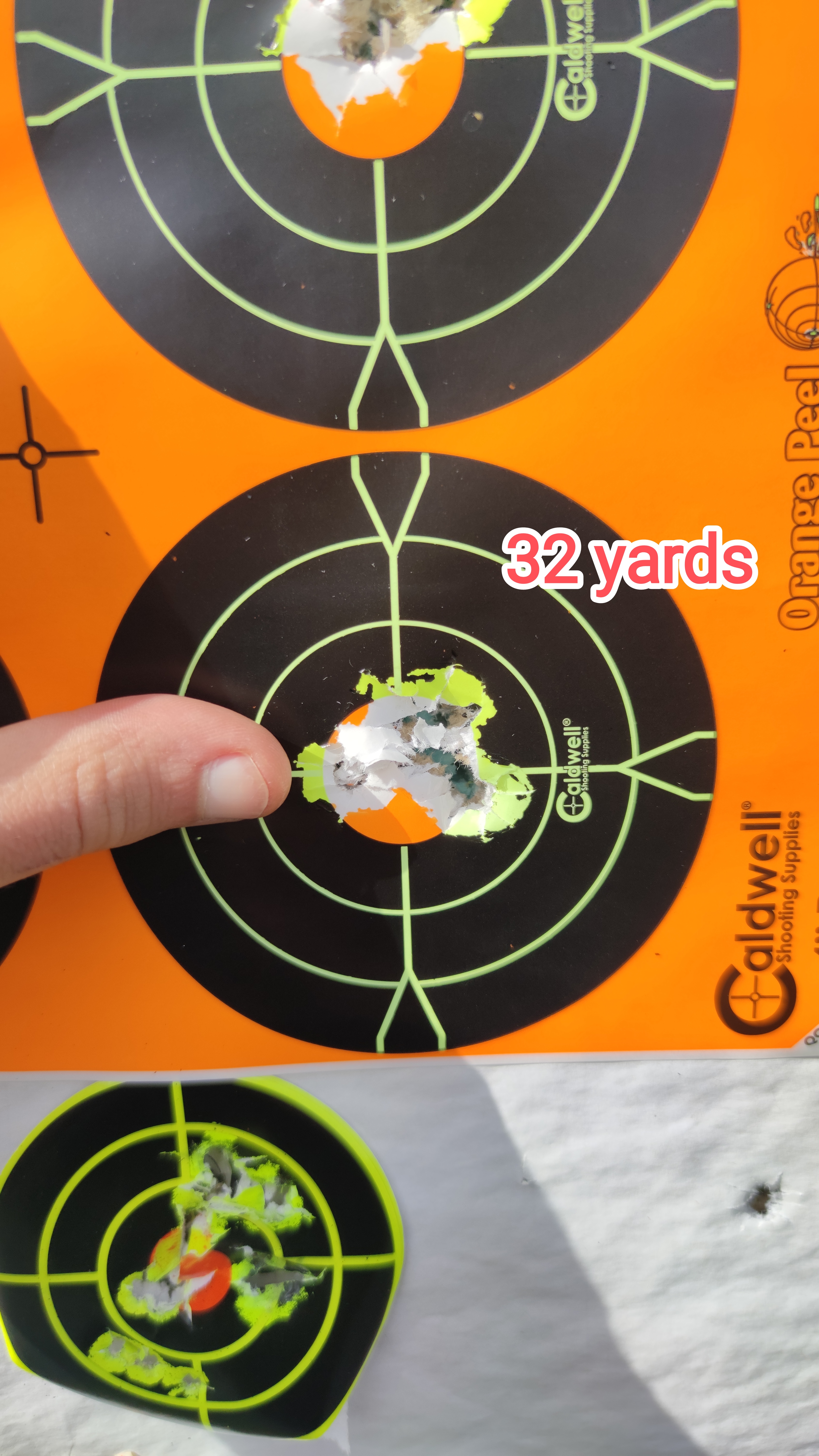

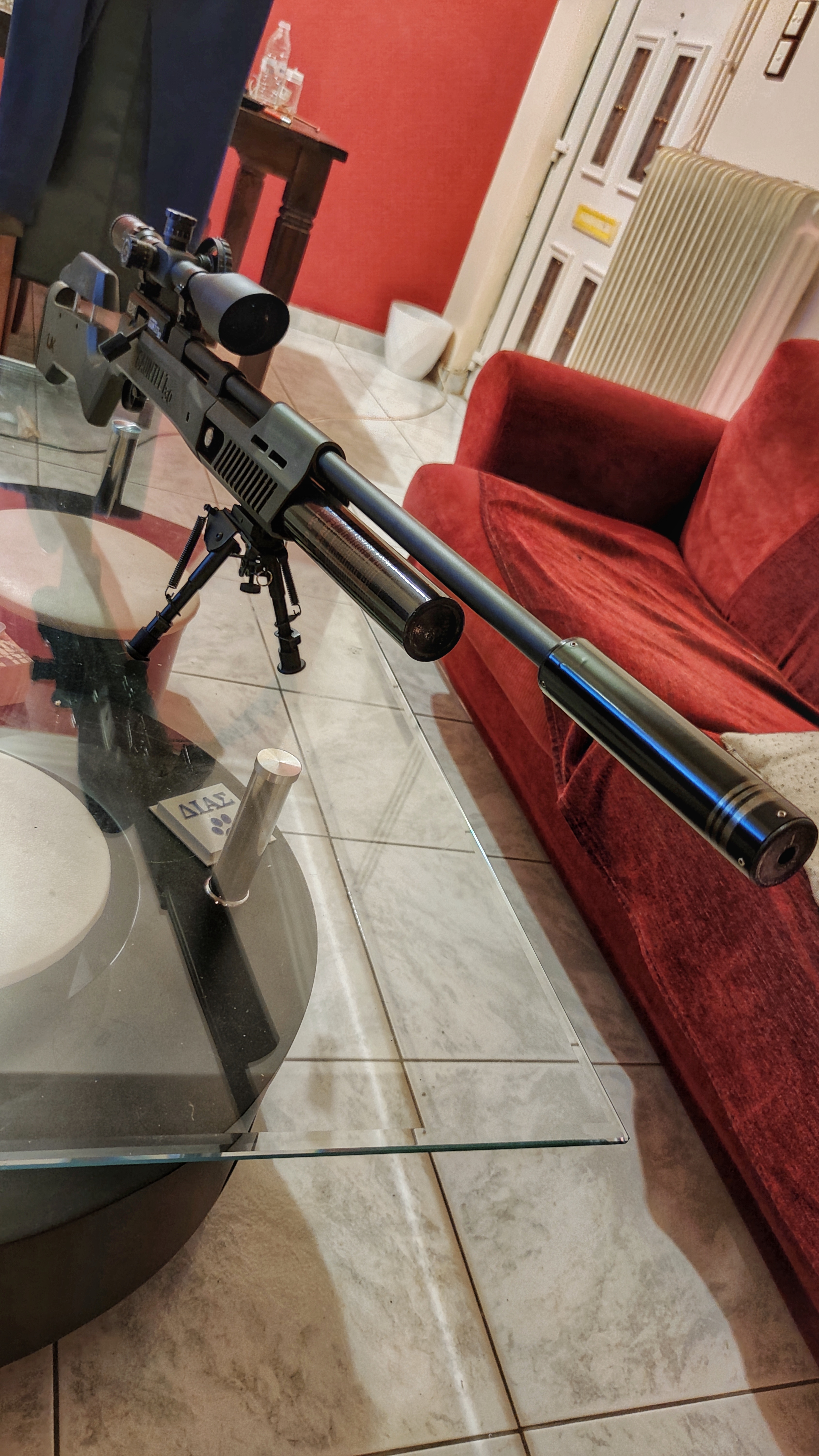

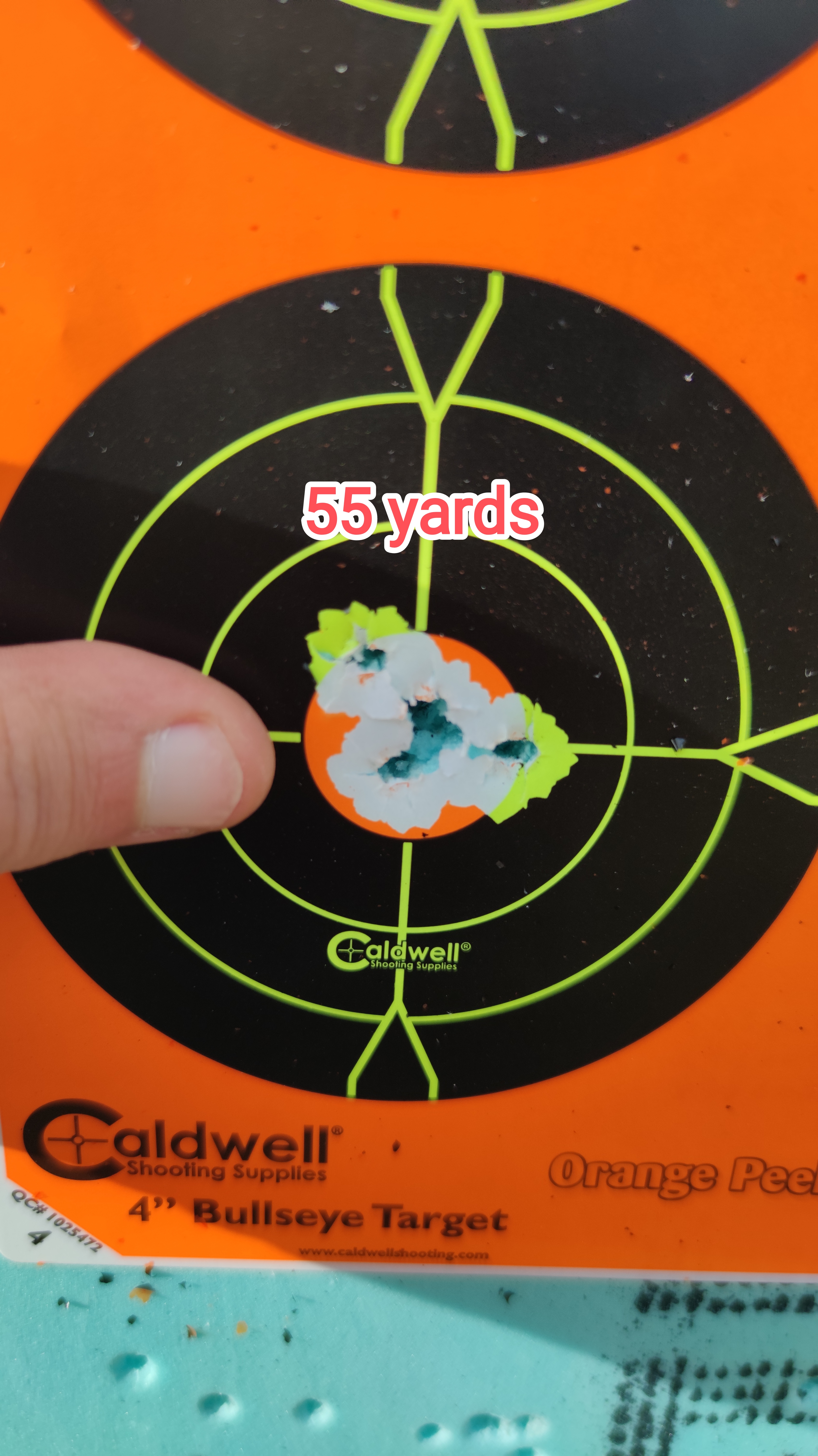

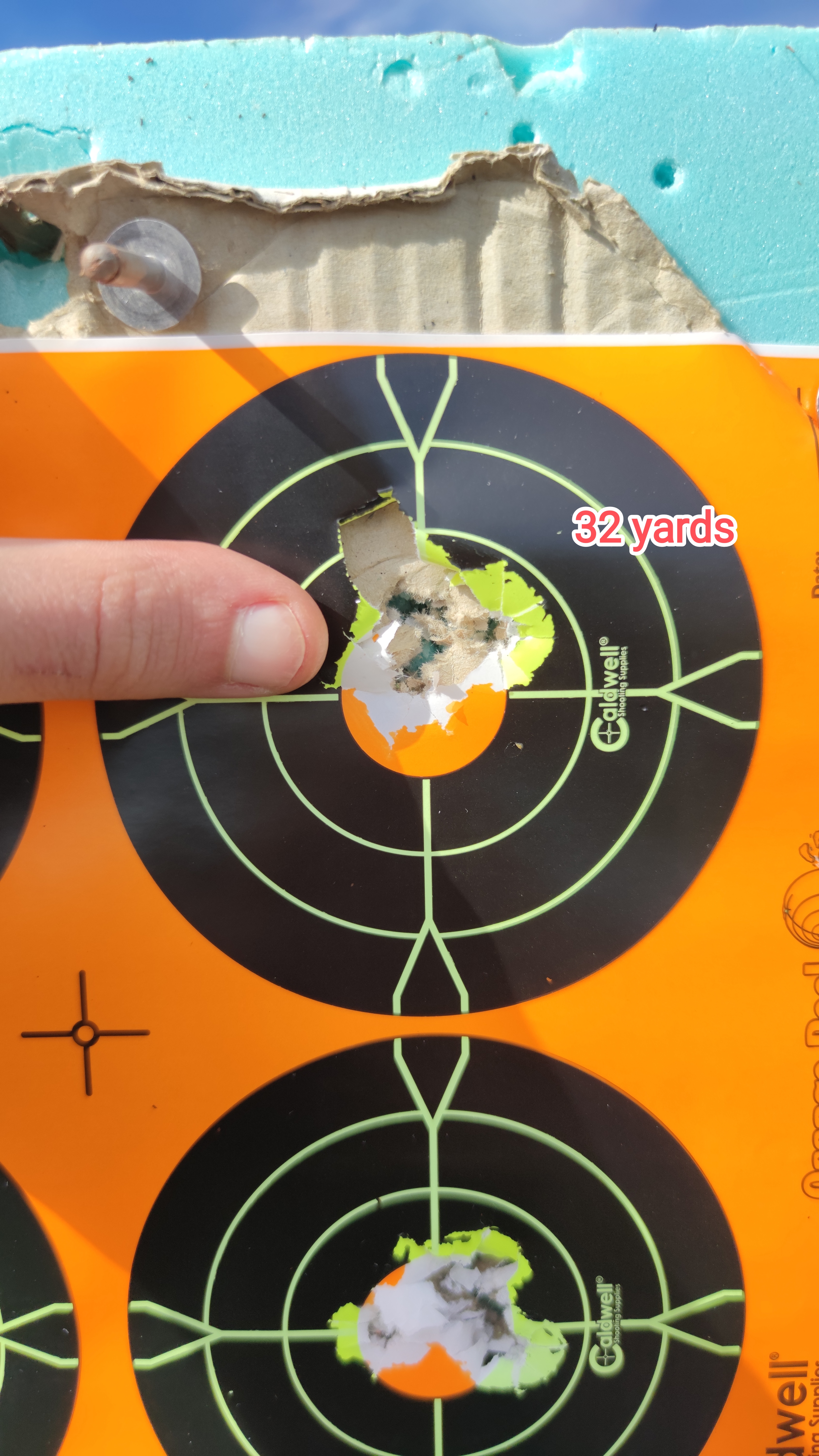

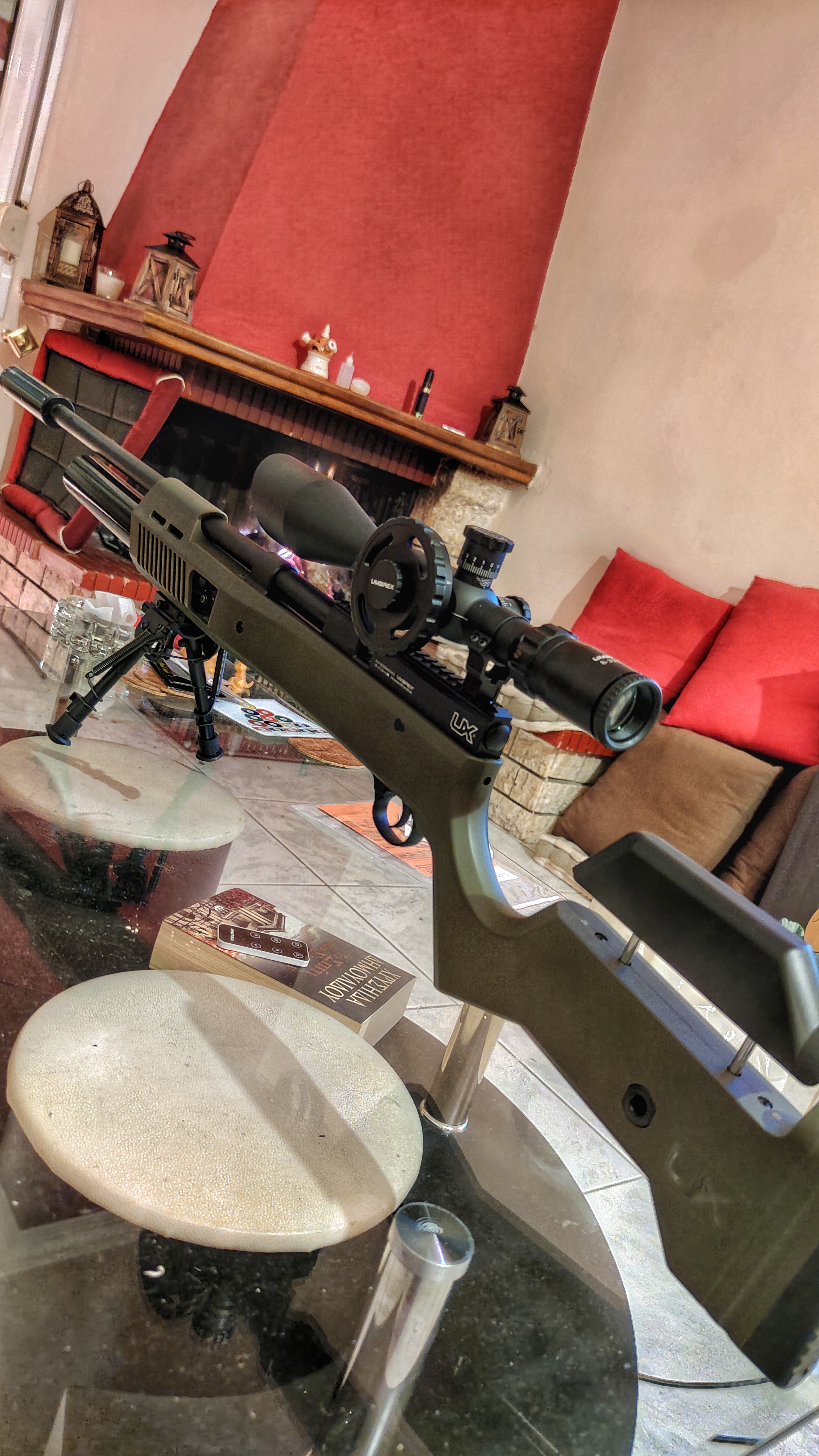

First post and i thought of making it a constructive one. Been a reader a long time though. Anyways,back to the subject.
I have the gun for several months and i dont understand why it isnt discussed more as it s a great riffle for the price.
My gun arrived with no leaks,no marks of any sort,half filled and in general great shape. I threw a cheap setup on it to see what it does. A cheap 50$ bipod and a mediocre SFP walther/umarex mildot scope.
The good:
Very very accurate at 30/55/110 yards. If it wasnt for the shaky gun combo,wind and myself, at 30 and 55 would be almost one hole groups.
Cheap, especially for you guys in the states
Shoots slugs even better than pellets. The trajectory of the jsb knock outs is far more linear than the jsb pellet. Zeroed at 55 yards i get 4 dots down at 110 yards with pellets and just 1.5 dots down with slugs,for reference.
Accurate to the manufacturer s claims. Swinging the jsb 44.75g at 1010 fps consistently.
Adjustable power with the external screw.
The bad:
Cheap plastic stock as you would expect for the price.
Very hard to cock. Compared to an fx m3 which is like a feather.
Bad trigger. Just bad overall. If i was at the states i would get a haji 2 stage trigger first thing.
Very very loud. Definitely not back yard friendly.
Lack of regulator pressure gauge. Again expected for the price. You need a chronograph to adjust power if you decide to do so.
And the last thing that annoys me the most. The foregrip m lok shroud. It flexes. It is impossible to stabilise the gun with a bipod.
In general i love the gun,i m satisfied with it and with a couple of add ons it will be solid. Below are a couple of groups that i did a couple of days ago. Unfortunately there was a lot of wind moving me along with the gun,making the 110 yards impossible.
