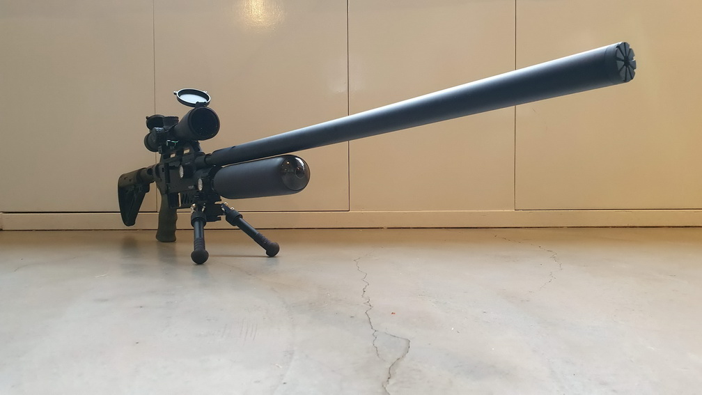

I did the same with my Dreamline Tactical and added a in-barrel suppressor.

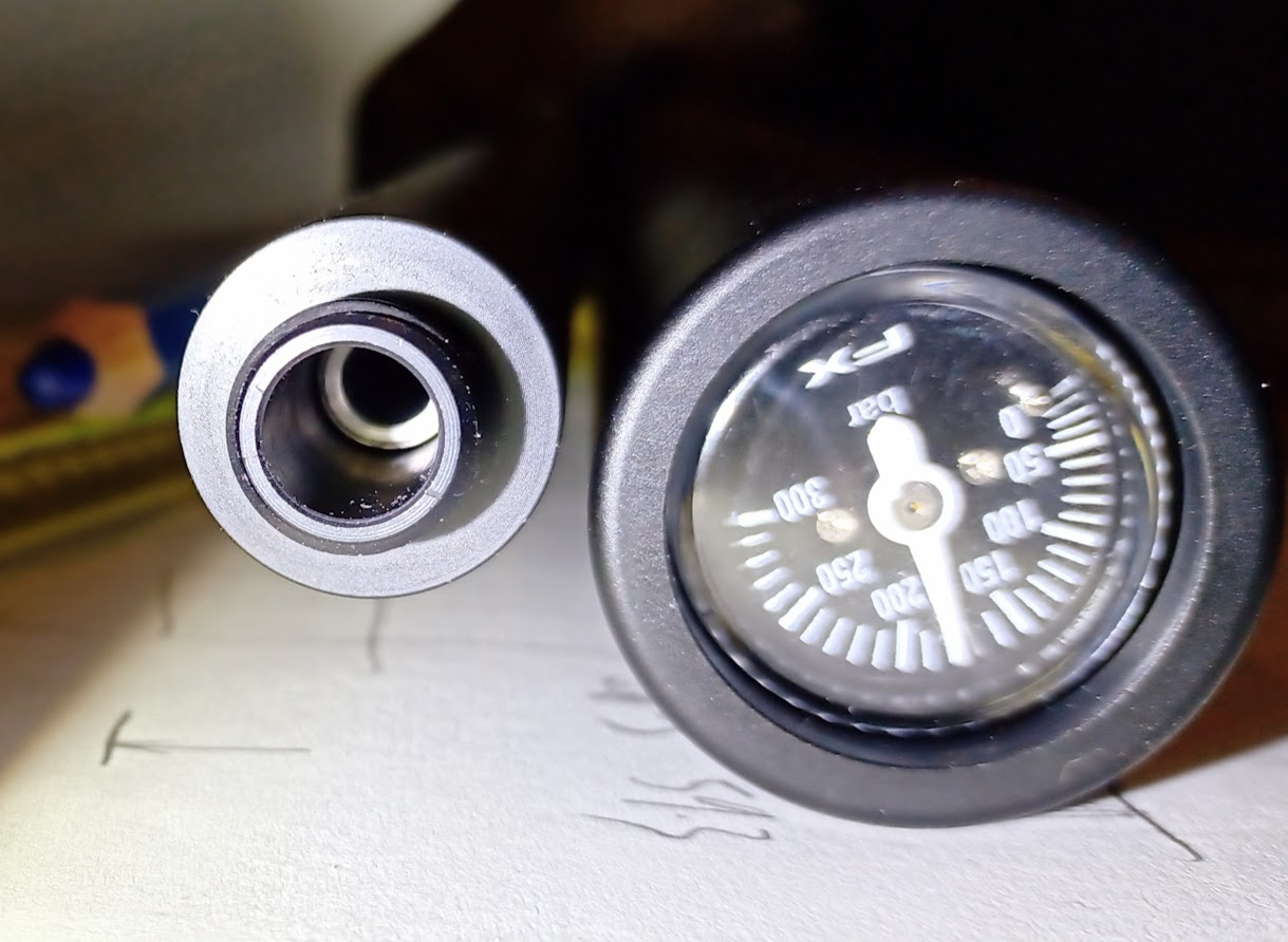

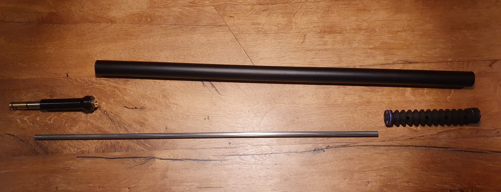

Is used a 600mm .25 liner in combination with a 700mm shroud (28mm) diameter.
I also swapped the cone part of the shroud to make room to use a power plenum on my DreamTac, which moves the shroud another 17mm to the front.
Shortening the barrel in an original shroud is the same principle, though I wouldn't shorten my compact liner too much.

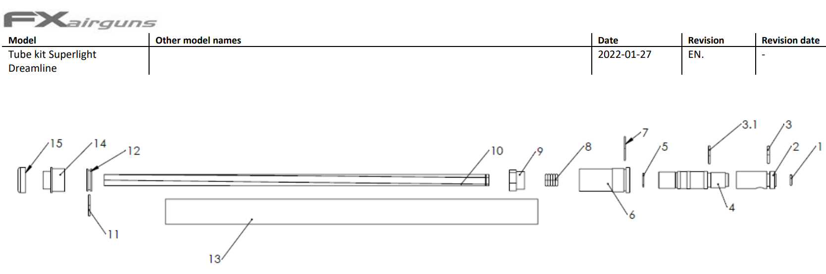

For the 600mm liner I used 3 spacers, which center the liner in the shroud (part 12).

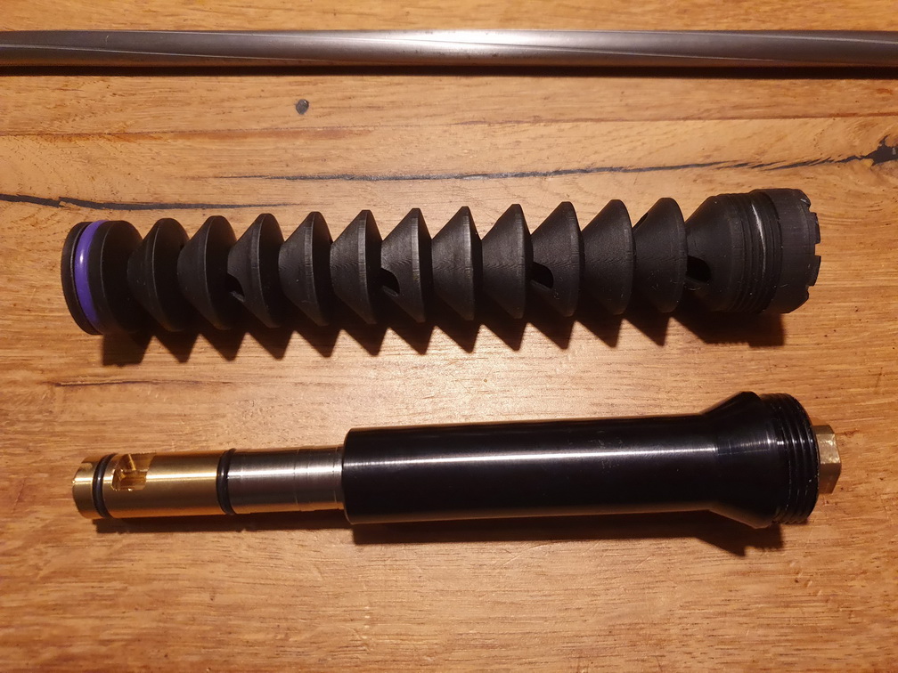

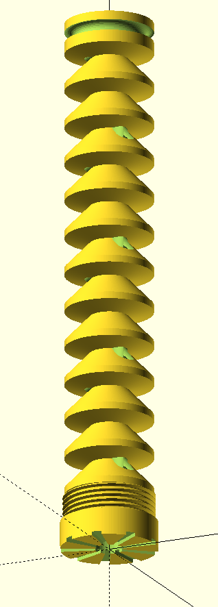

Now you have space for a 12cm long internal suppressor, I've printed one usin a resin printer.
I say the noise is comparable with my .22 barrel and Hugget suppressor.
