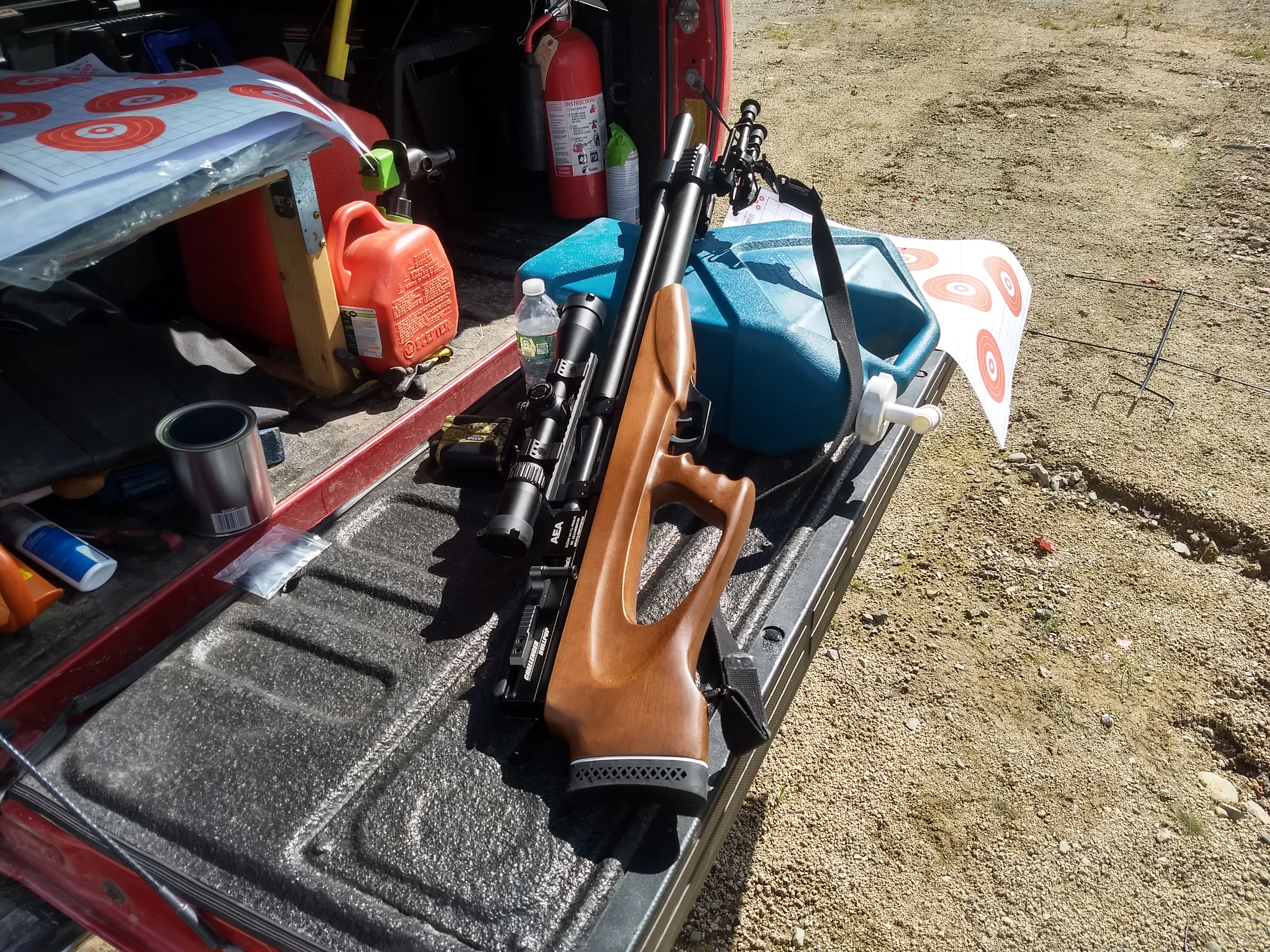

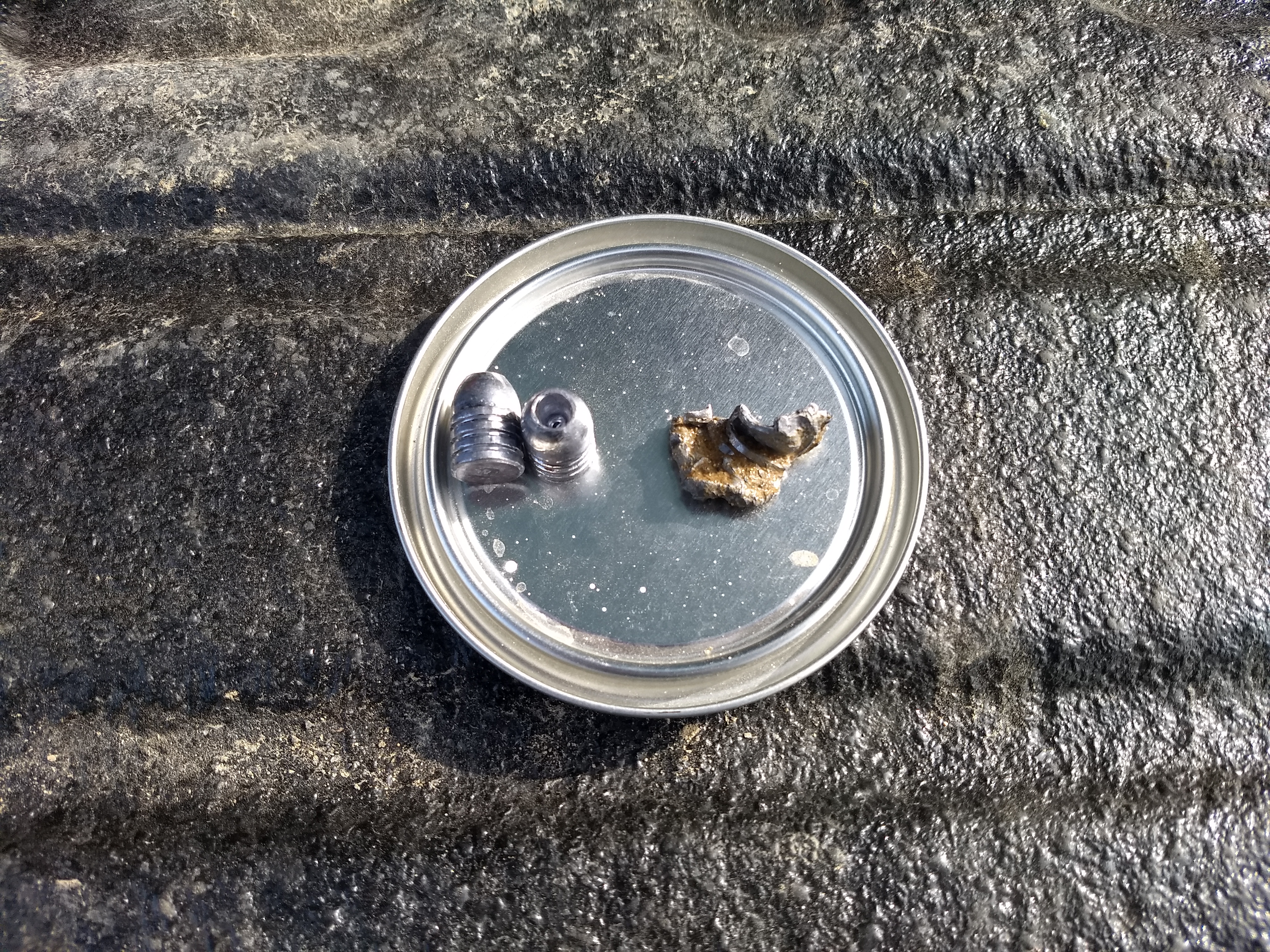

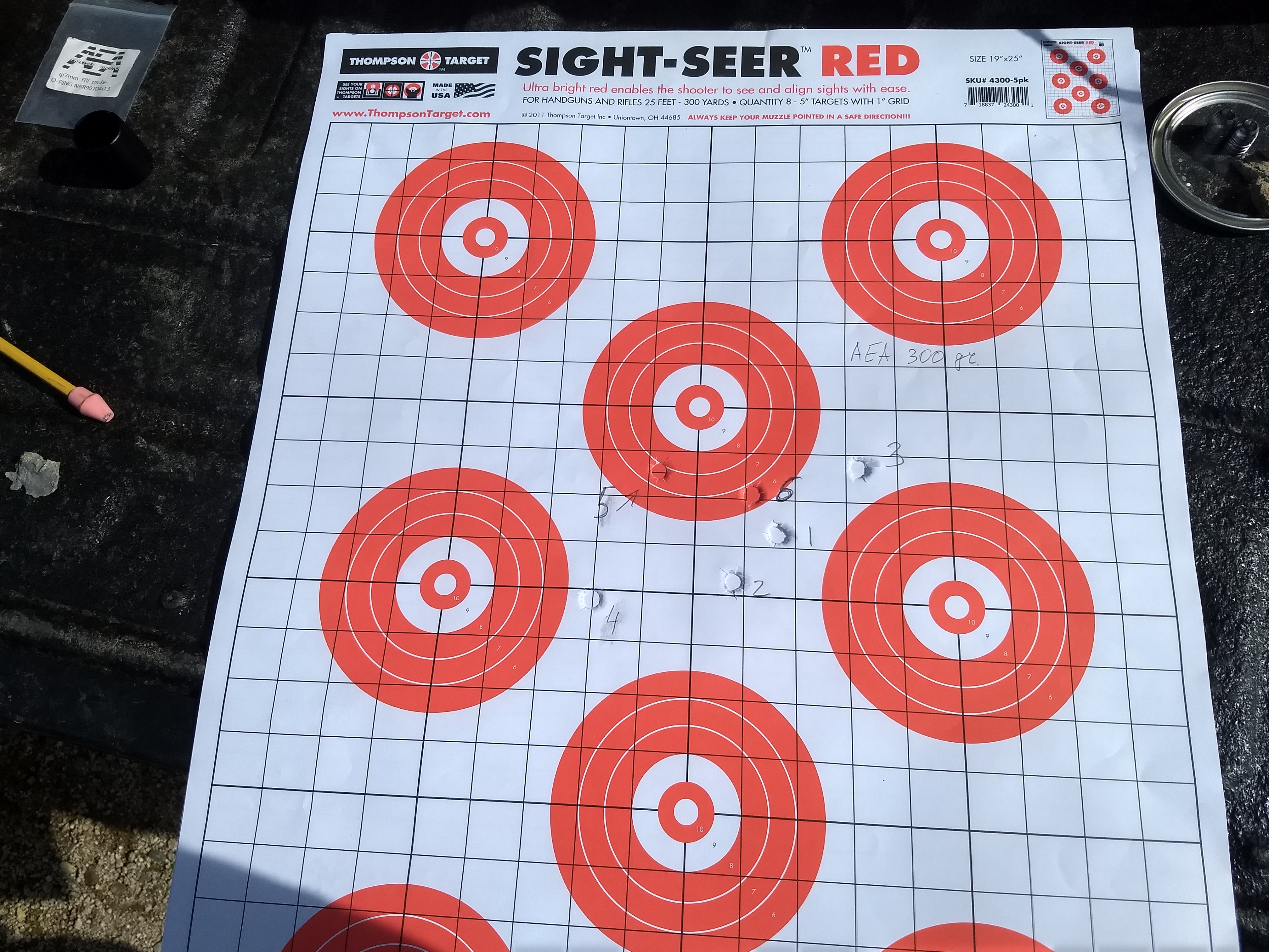

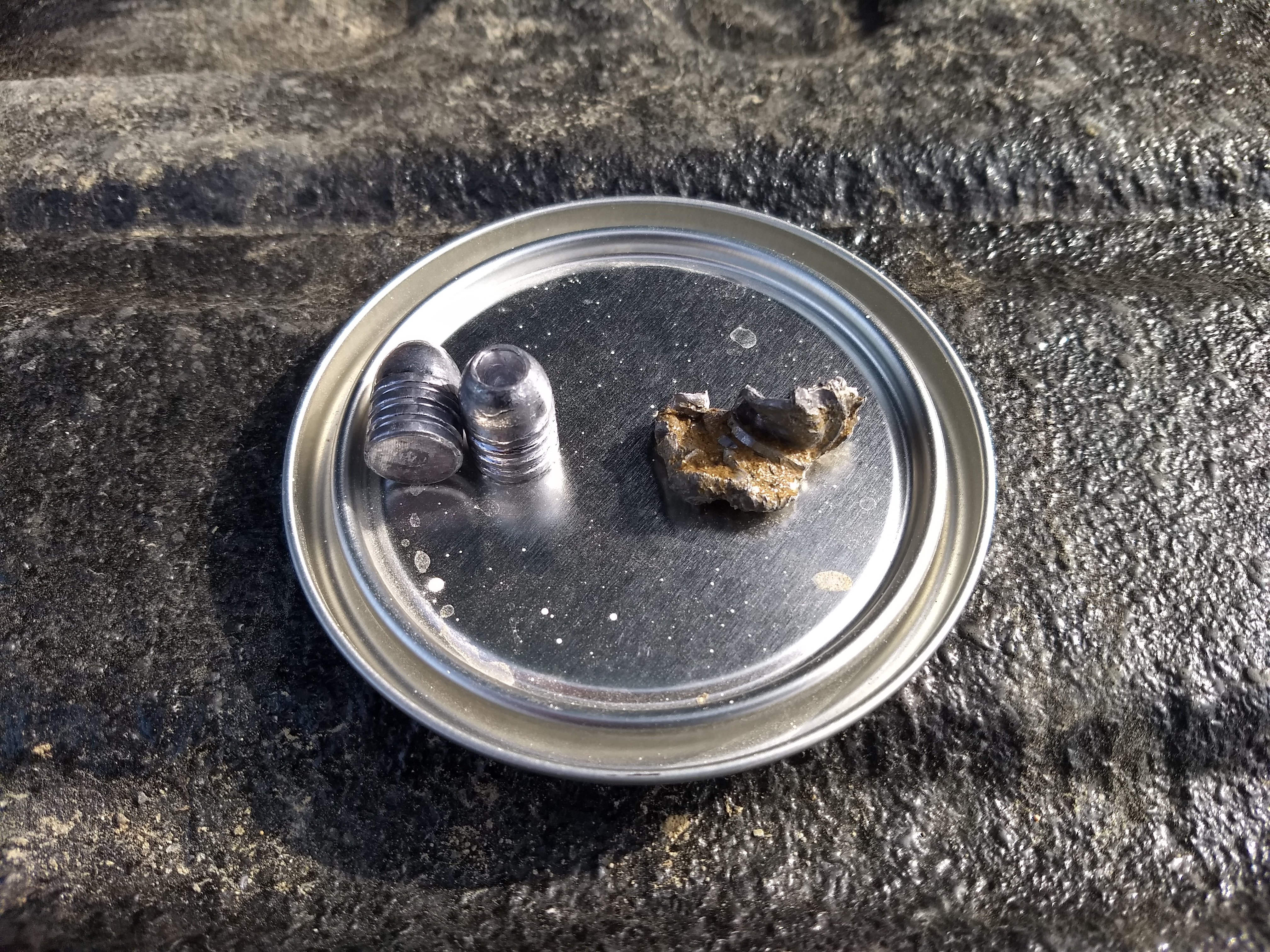

Ok, so I've sort of sighted in my first PCP ever: the AEA Challenger bullpup .510 + Swampfox Patriot 4-16x44 scope. I've shot two mags of AEA CNC-machined 300 gr hollow point and about a hundred of less than ideal, cheap 345 gr Ebay hollow points, all at 70 yards. Thoughts:
Cons:
- this damn thing is too heavy. Not comfortable to carry it around, impossible to aim unless supported
- butt stock sits too low, can only use an upper corner of it against my shoulder
- it self-disintegrates while shooting. Would be a very wise idea to take it apart, apply blue Loctite on every damn bolt and assemble it back. It was leaking out of the box because of a backed off bolt
- trigger is very stiff. By the time the rifle finally fires you pulled it to the right already
- safety is awkward: can't see if it's on or off. If you try to pull it blindly to "on" and you messed it with the trigger - the rifle may fire. Very unsafe safety
- time to fill from 2000 PSI to 4000 is about 15 minutes with GX-4 pump
- fill port cap falls off after every shot
- first shot at full pressure always goes low. Why?
- failed to cock the spring twice, had to close the breach and try again. Would have to remove the mag if I used one at the time.
Pros:
- cheap
- mag fed
- looks badass
- it is basically a rifled shotgun. Will kill anything. Recoil at full 4100 PSI is unbelievable
- 500 cc tube @ max PSI has enough air for 5-6 rounds. Wish it had a regulator
Now I want to convert it to a classic stock and buy a 3D printer to print magazines that will accept commonly found .510 slugs, which are tad longer than the stock mag will take. Need to move the bipod to the stock and put a better barrel band.

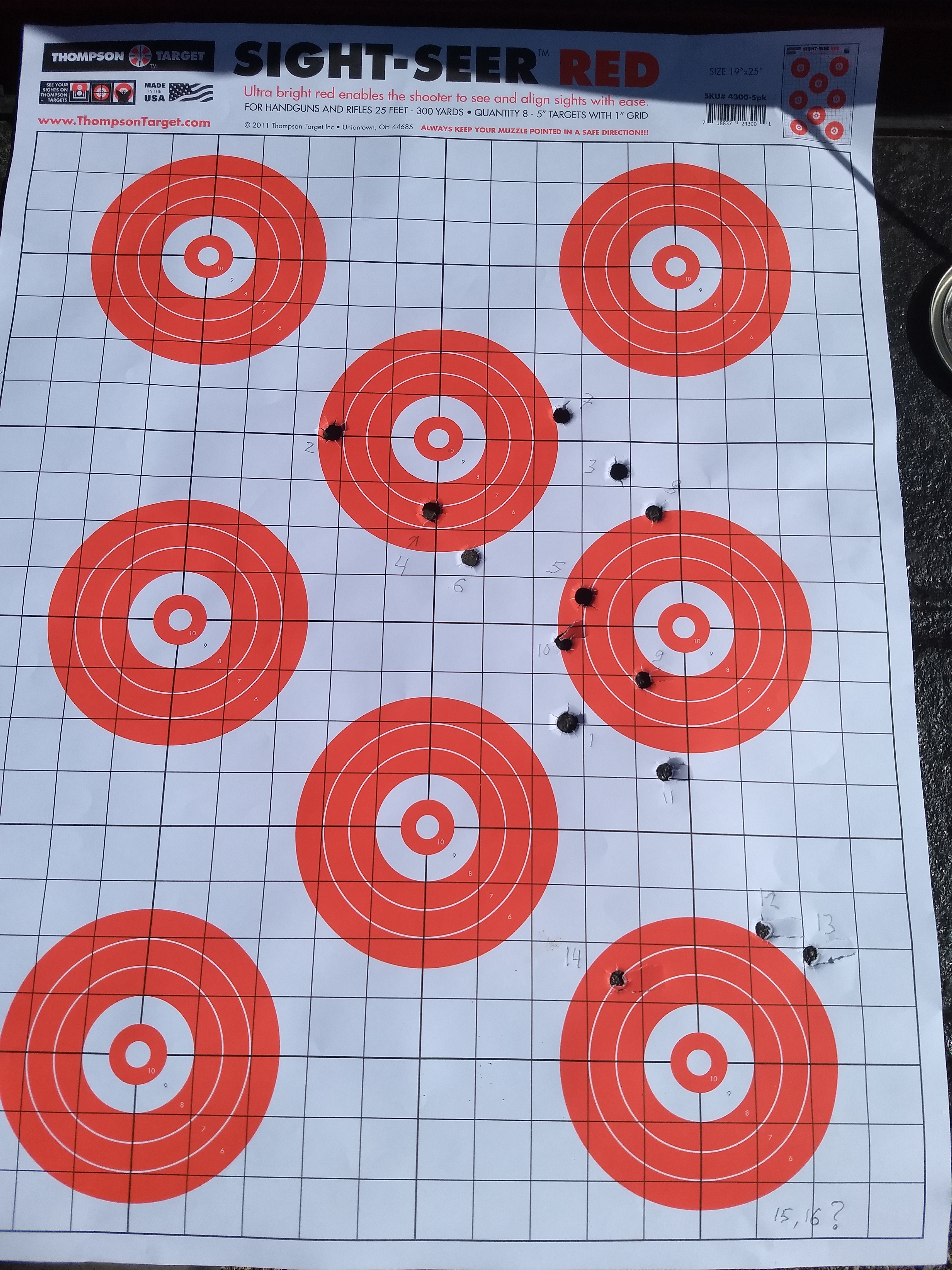

Also why it shoots to the right? The lower is the projectile's speed the bigger is the sway to the right. Is the barrel curved? With a higher FPS the slug rotates quicker and has more momentum, so it flies more straight, but as air pressure and FPS drop it starts to deviate more and more? Is it a plausible theory? I can actually check it with my long straight edge I got a few years for the engine rebuild. But that would suck if the barrel is not straight.
This is 16 shots done with one fill, till I was able to hit the target. Last 2 slugs were a miss.

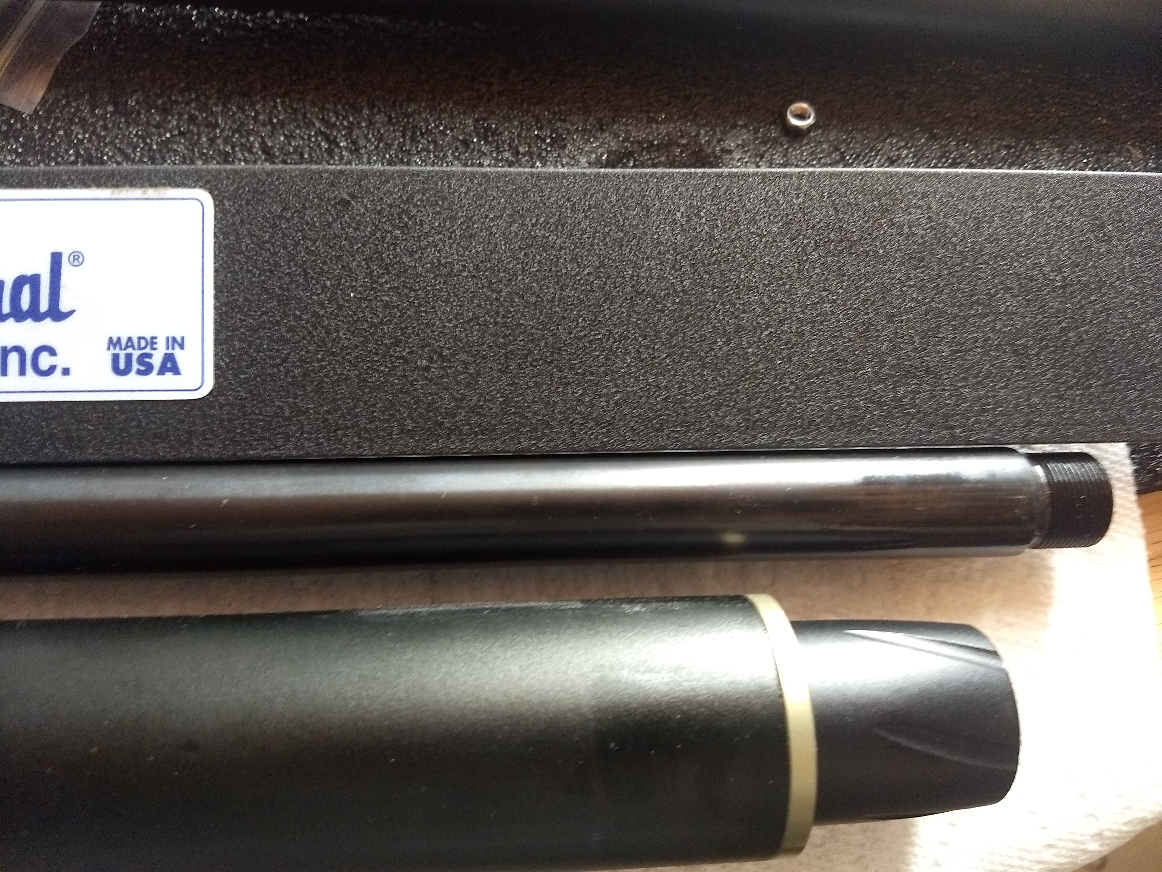

AEA makes there own barrels ......lol😆😆😆 Its just a crude barrel... I'd buy a American Green Mountain barrel or ER Shaw barrel...they won't break the bank...it requires a mill and lathe to fit barrel blank..sucks green Mountain blanks decent and cheap
Crappy barrel sucks indeed :( I'll try to measure the run out with impromptu "lathe" and give it a few smacks against a log like in this video:
Luckily I don't need much precision with this gun, 2-3" group at 100 yd would be enough to take down a deer reliably. All that I need.
I'm not a gunsmith, but have fairly large experience for a tree shade mechanic with fixing cars and fabricating small things/tools.
Reactions: RM.510bigbore
That guy in the video is 100 percent awesome in his info. I worked at ER Shaw Barrel s in Pennsylvania for a lil while. They straightened barrels in a rig between centers....they hit the high spot with a 10 lb rubber hammer...till straight... Then in the cnc machine to turn barrel to bore centers. Small caliber barrels are really crooked....Straighten your barrel and watch some videos on hand lapping with a lead lap...You seem very capable mechanically

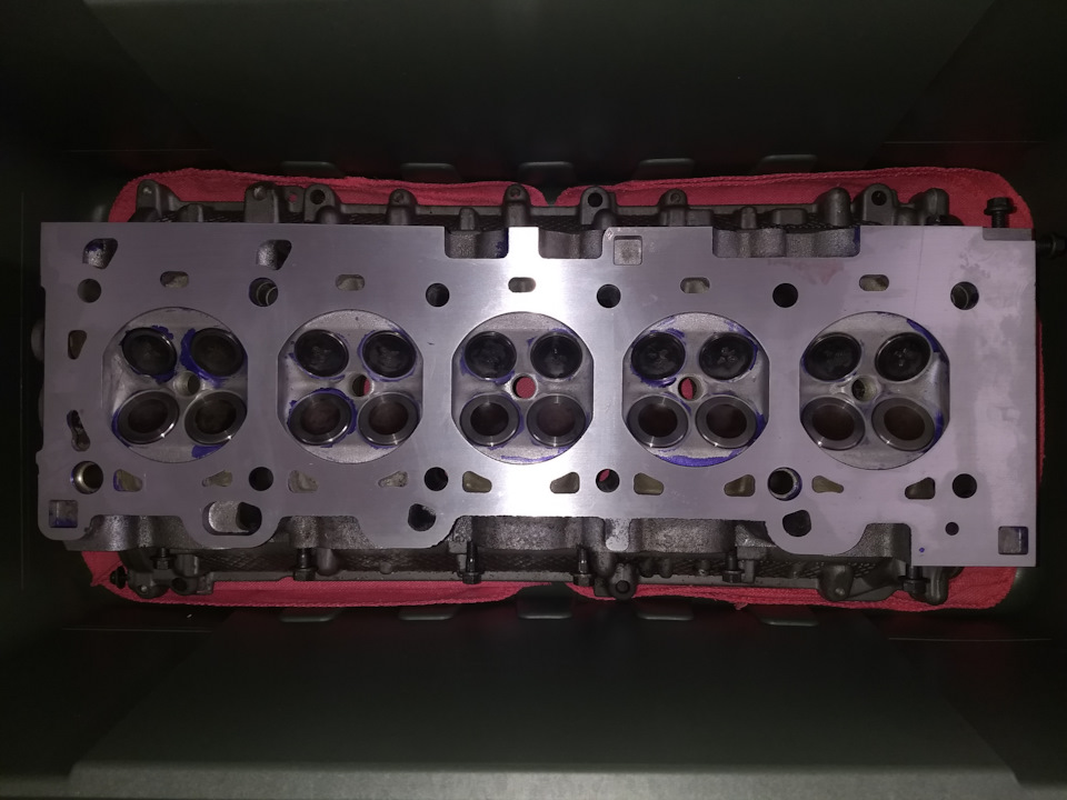

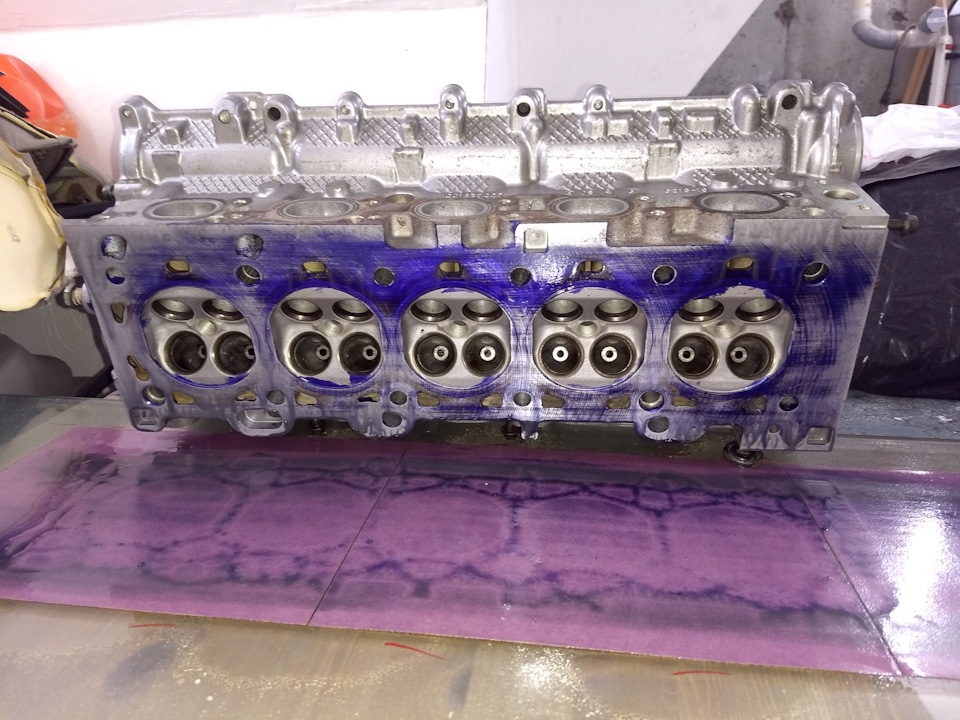

Ya, I'm a big believer in simple methods when they are in agreement with the physics. People laughed at me when I machined my engine's cylinder head on an IKEA kitchen table (good thick mostly flat wooden base) and a 3/8" thick piece of polished glass (flat to my smallest 0.001" gauge). The result was better than the factory machining, it turned to a complete mirror-like surface. The engine actually has a multi-layer steel gasket, which tolerates a lot, but I had to remove a few pitting spots from fire ring areas. Read a book or two, think about what you need to do step by step, don't rush it and check/measure often.

So I worked at Green Mtn for a bit. Among other things I straightened barrels.
We basically used a similar, yet more modern, approach as that old timer used.
Instead of a log we used gauge blocks, a dial indicator, and a 10T press(as the log).
Look down the barrel for concentric circles. Any spot where there are not circles but ovals indicates a bend(the high side is the thicker portion of the oval).
Yeah, thanks, @AmosBurton. I found two bends I need to fix. One is closer to the center, one is near the muzzle end. How do I fix that one? I think I need another rig to hold the barrel while I press it on my shop press...
Same way, use two blocks with v's cut into them, separate them a bit and put the bend in the middle and then press the bent spot.
