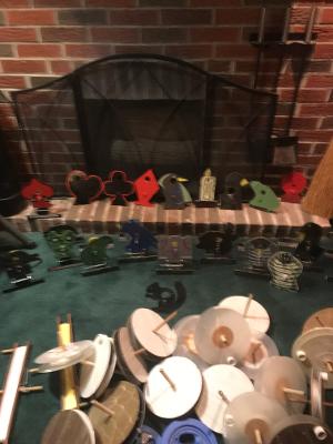

I just made 20 paddles. I used a hack saw and bench grinder. Made from 1/8" x2" plate. Not hard but labor intensive. Oh you also need a bench vise and big crescent to make the twist and a drill for the two holes.
I made 20 targets ready to introduce field target to our club soon as it warms up.

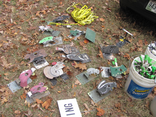

How do the clubs hold the targets in place? I am thinking of using 16x8x2 inch pavers. I don't like the idea of using clamps and want to leave the pavers on the course only taking in the actual traps. any ideas on mounting? JCS
Clamps were convenient for a TN State match some years back. Smaller 4x8x16" concrete blocks and clamps with block staying in place. Most targets, except those strapped to trees were clamped left and just moved a bit between shoots.

Everybody has their own system of setting/fastening targets. I started out just steaking them to the ground. Now we use patio bolts with anchor bolts inserted and screw targets down with a wing nut. Also have concrete bases with 1/4-20 anchor bolts installed. We built wooden platforms also with 1/4-20 studs for tree mounting. Lots of ways to do it.

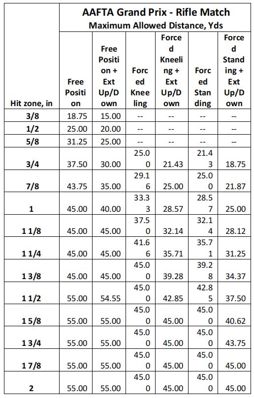

Hi Guys, Is there somewhere to find what yardages the different size kill zones are set? I plan to set them at any range from 10 to 55 yards but should start the early shoots with the targets set with the smallest at 10 and progressively to the biggest at 55 yards. Also plan on having a bonus target, maybe 1/2" KZ at 55 yards.
