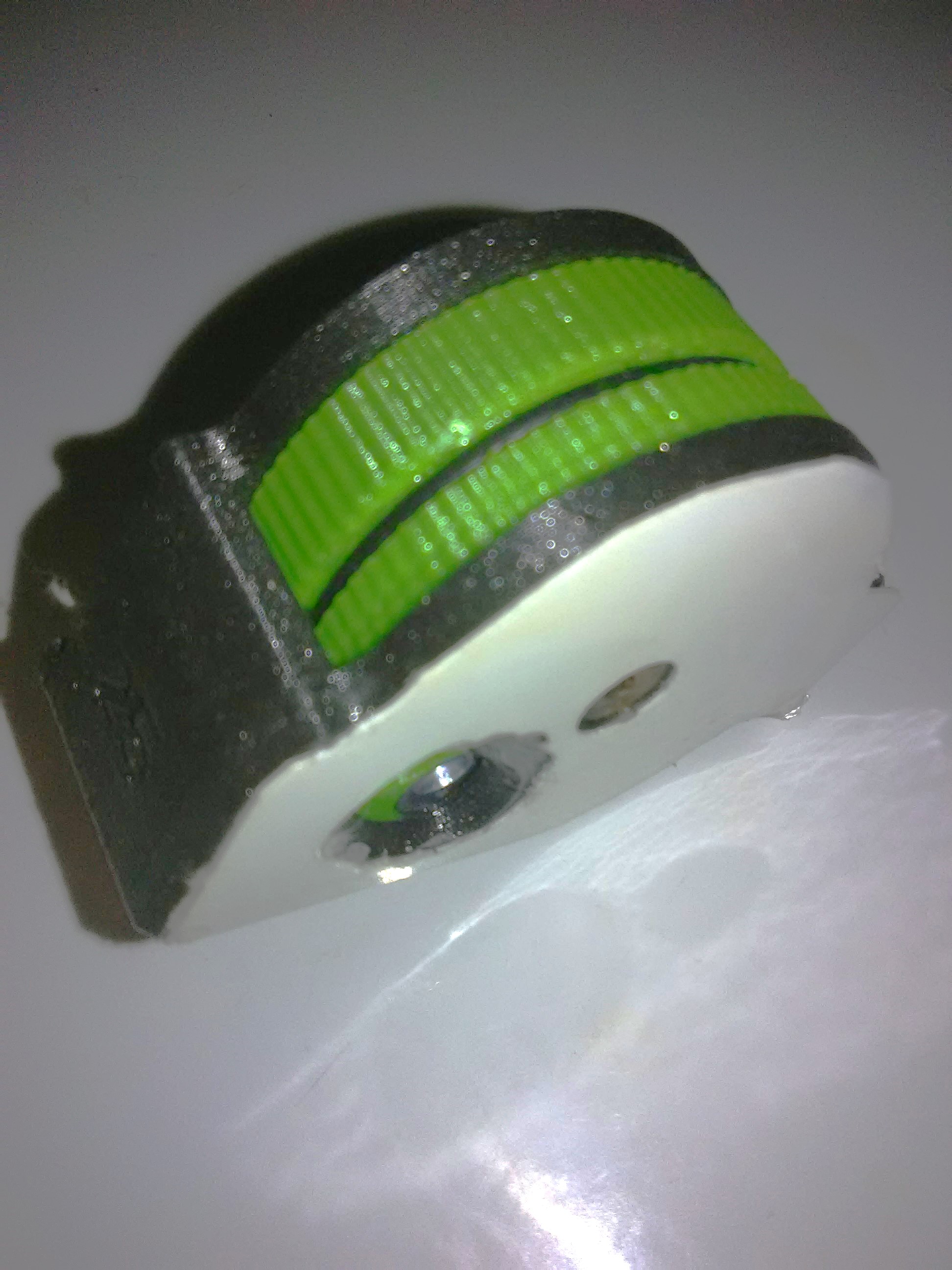

BUT The 10 shot clip is feeling a bit odd so I looked for a new one online and it seems to not be available? Anyone know is some other clip (marauder or...) might fit? Even with a little work?

Hi John - yes, Carm magazines makes both a single shot loader and magazines for the Gauntlet. I have a Gauntlet .177 and have purchased both from Carm.

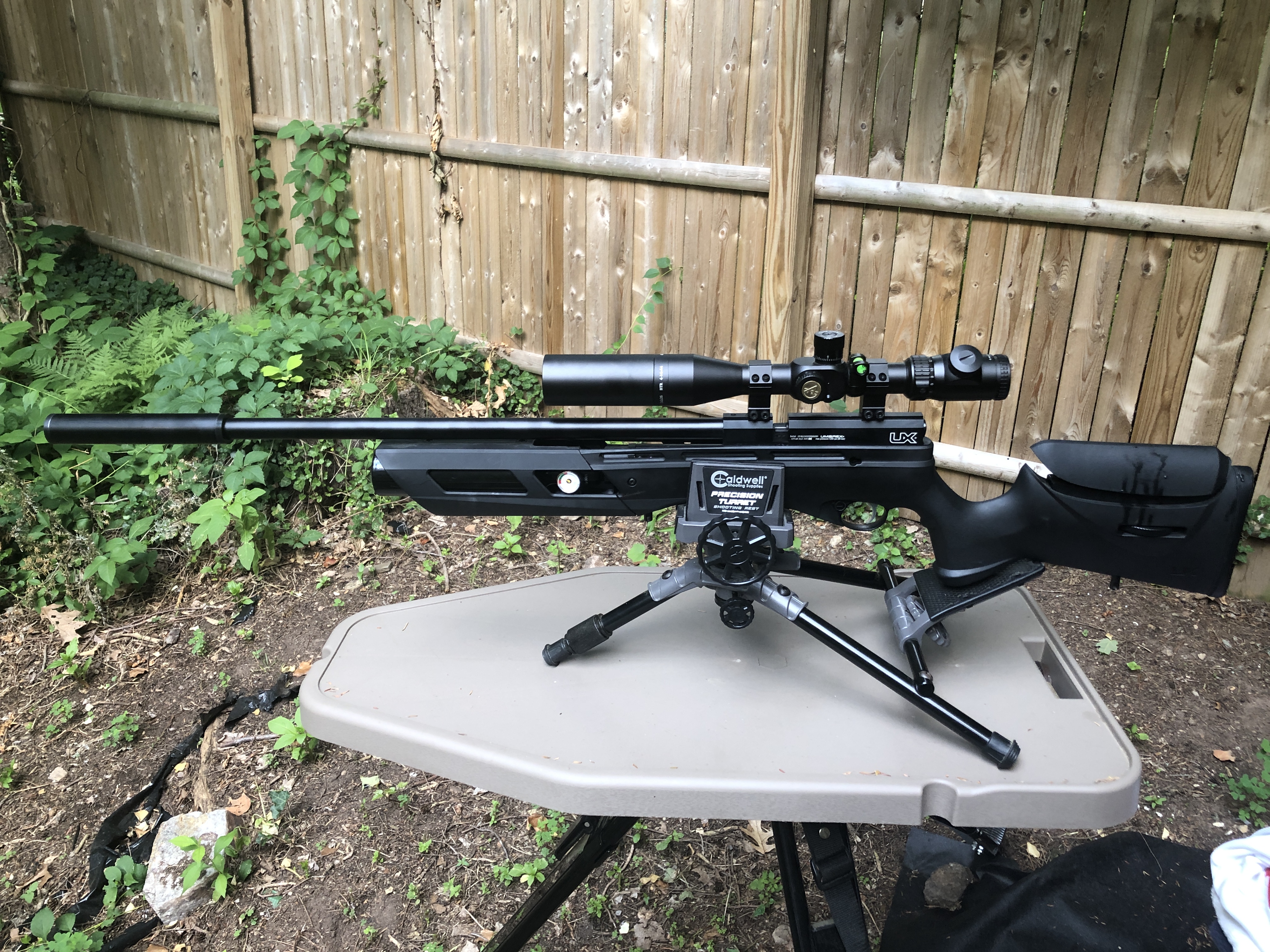

I installed the shorter shroud from Donny FL and polished up the trigger - installed a rudimentary 2-stage trigger from Hajimoto - otherwise my .177 Gauntlet is stock (still running stock regulator and hammer spring.
You must have a 12 ft/lb version as my “FAC” .177 has a very stiff bolt - using hard Crosman 10.5g it is a beast to cock.

It is non-adjustable currently, but I have Hajimoto’s “super tune” kit for it - which includes a hammer spring adjuster screw (requires drilling small hole in stock). When it eventually leaks, I’ll take it apart to fix leak and install hs adjuster at that time.

Everyone who mentioned the Carm mag thanks! And Steve your recommendation made me go look again. I had been to their page but only under umarex (a couple of odd parts period) but sure enough under clips they say something like Marauder/Gantlet/something. Which makes me think a marauder clip might work but I would rather but just one good one than several others.
