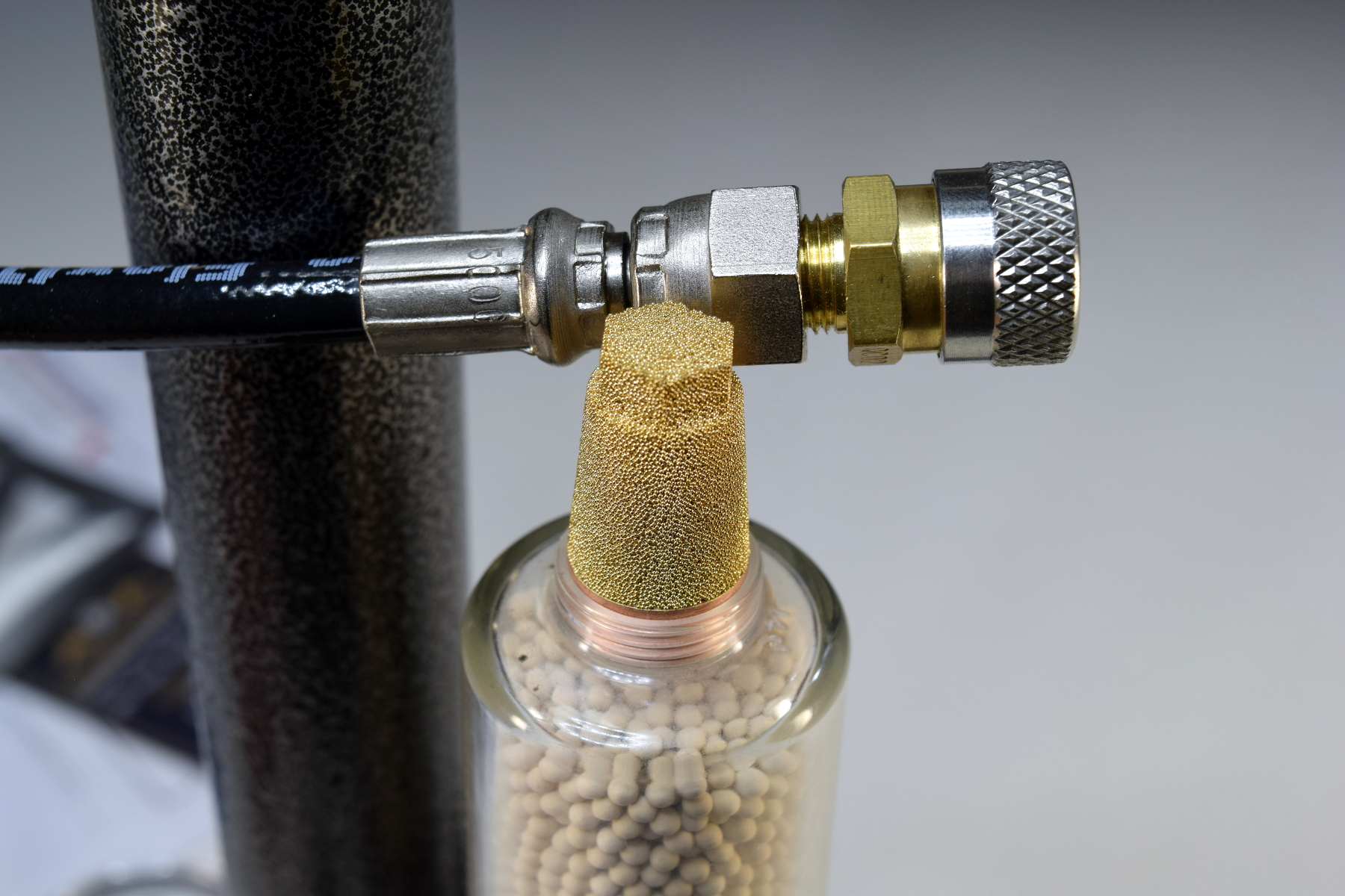

get the Hill MK5, with the filter. costs 4x as much, but it'll outlast your gun.
IMO, stay away from the $50 junk they sell on Amazon unless you enjoy repairing them regularly.
and the Hill pumps are WAY easier, smoother, less overheating than the el-cheapo version.

......I had 8 HILL pumps over the years from MK II to MK IV, they all failed way faster then my cheap China pumps,
all developed severe pitting on the main tube in short order, all needed a re-build in 6 months and a re-build kit was 38 buck plus shipping ( so the same price of a new China pump )
My current China pump has been going strong for 3 years and all I had to do was change twice the check valve o-ring and that takes all but a couple of minutes.
to buy a HILL nowadays is pointless in my opinion,.....hardcore handpumper for over a decade and a half, as mentioned had 8 Hills, also 2 FX and a couple Hatsans, the current 50 bucks China pumps are the way to go !

150 million percent disagree. The hill is no better and that filter that is supposed to dry the air coming into the pump well yeah right, pretty pointless in my opinion. I’ve had my China pump a year and a half and have only replaced 2 orings in it that took about 10 minutes.
