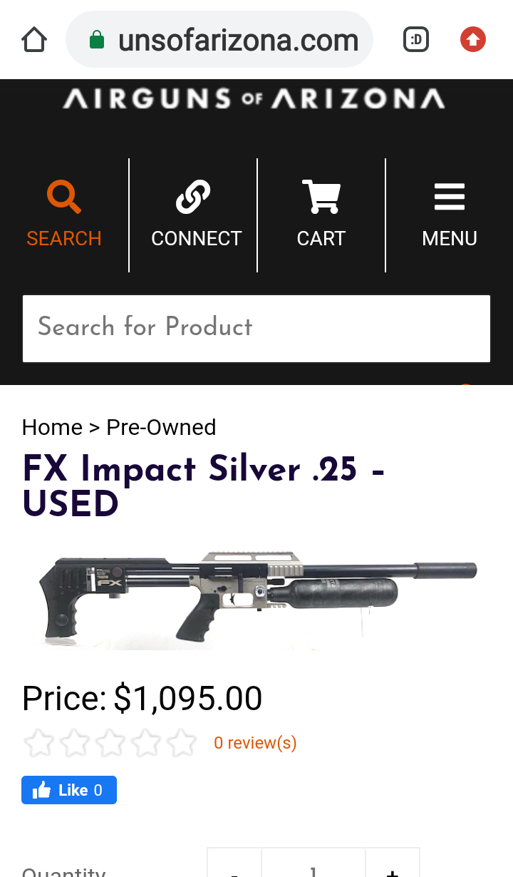

I’ve got an MK1 Impact and I don’t know if I should upgrade it, or sell it and buy a Maverick sniper. It’s completely stock...no larger plenum, no dual transfer port, no huma regulator, no STX barrel (has a 600mm ST extendable shroud I think...might be an STX because it shoots 34 grains like an STX), but it does have new gauges. I could probably sell it for a little over $1300. If I did, it’s just an extra $650ish to buy a Maverick. Could I upgrade it within that price limit?
Of course, I’d sell the barrel if I did upgrade it. The barrel alone would cost me like $400 though because I’m looking for a 700mm STX.
