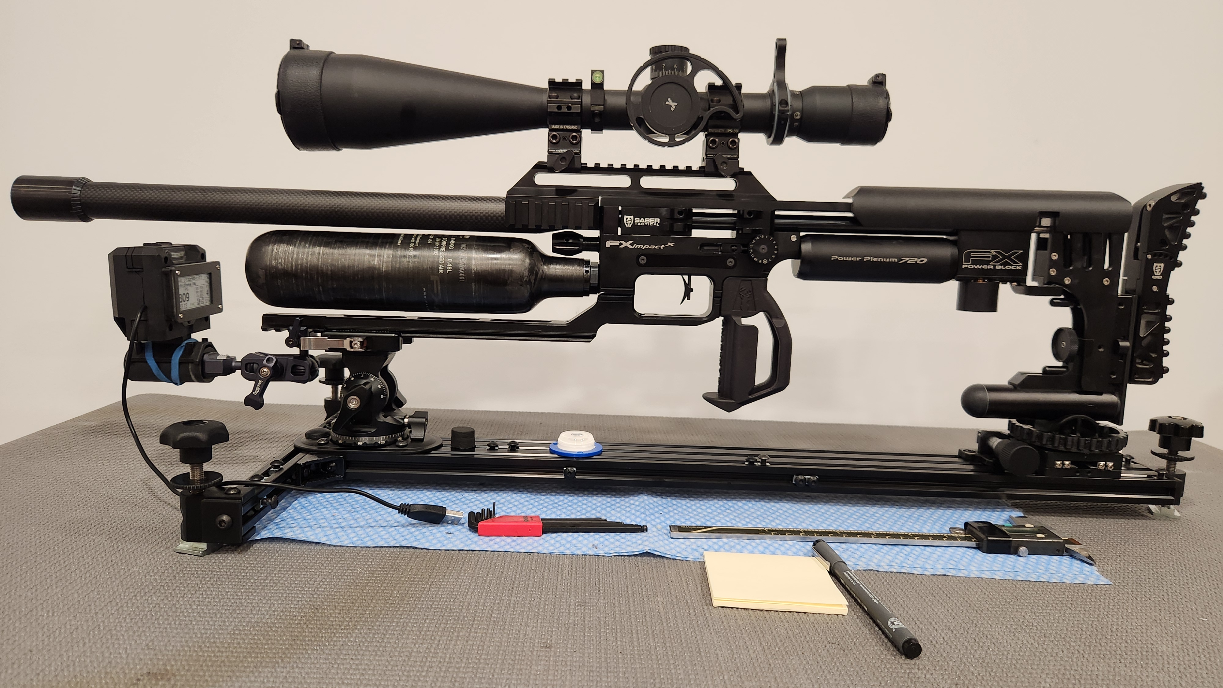

I have this FX shroud integrated tuner for my x700 barrel, I was using it with more less success in the past 2-3 years.
Tinkering now for a new season to swap the barrel on my Impact MK2 from .25x700 to .22x600, and maybe I would need to build one tuner for that shorter barrel.
I know what parts inside the integrated shroud, I may want to go now with an independent piece that just slides along the outer tube.
Show my how you managed?

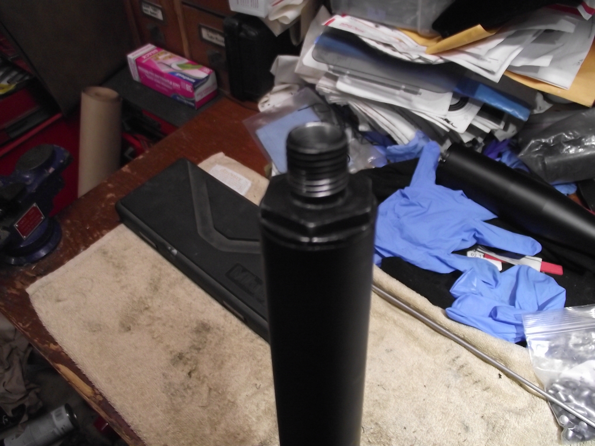

This just a couple random pictures, but I do this type design on quite a few of my High output PCP's.
Barrel gets held at receiver VERY securely. Threads on or added at barrels muzzle end.
Ideally thin wall SS or CF shroud.
Air stripper end cap when threaded on and snugged up places compression on shroud tube & barrel within shroud into STRETCH tension.
This design works exceptionally well IMO ;)

Each application will differ .... How one secures barrel within receiver to how one makes sure all the pieces are mechanically SQUARE to each other is key !!
If you require / want impulse air INTO the shroud ? your muzzle end tensioning cap needs to be vented.
Sadly no pictures at this time ... never documented this mod tho having done so numerous times.

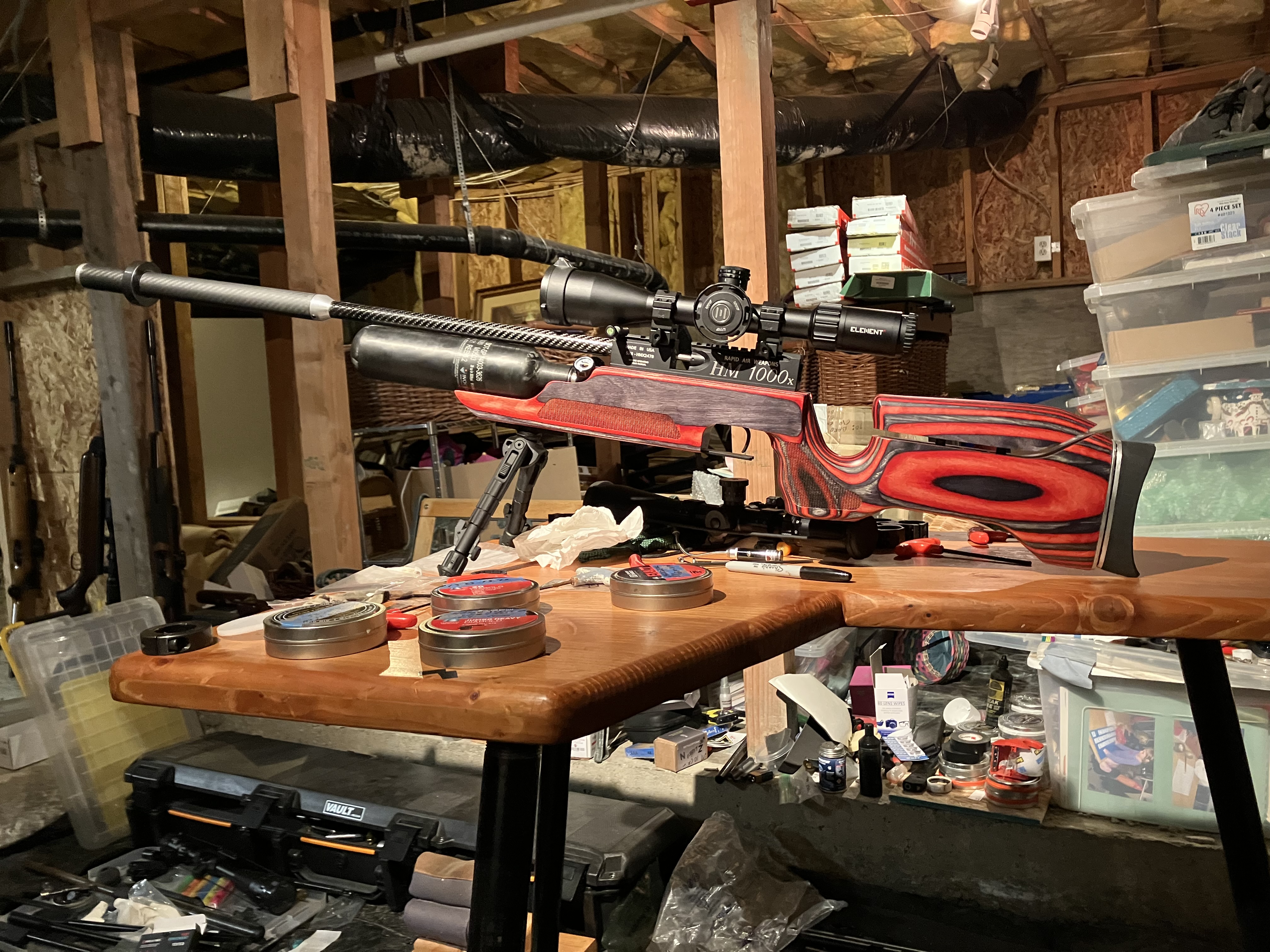

Here is an approach I took with a spring rifle.

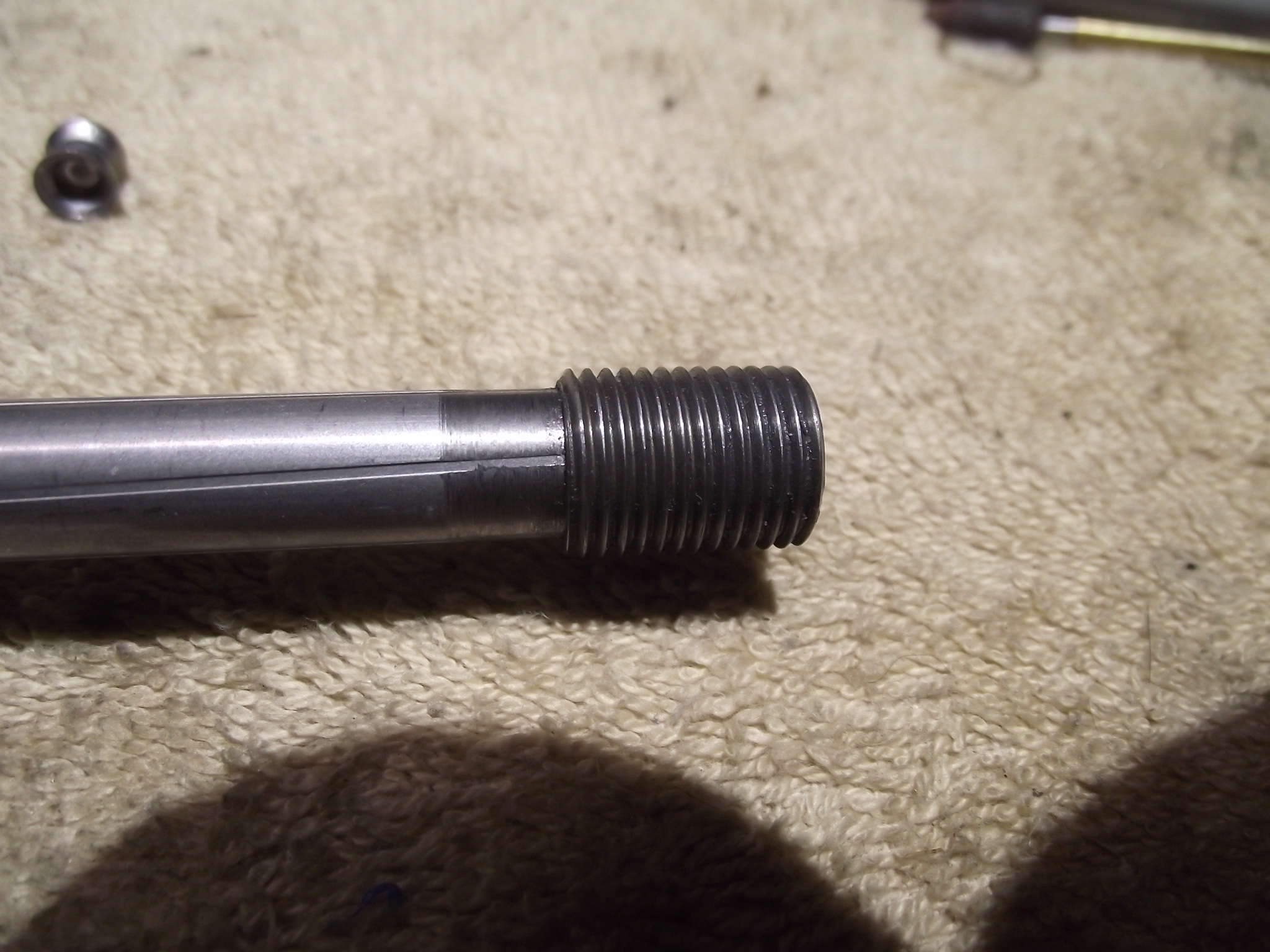

I assume this is an fx liner that you have sleeved for a different gun? If so, how did you securely fix the 1/2 unf thread to muzzle without it being pulled off hen tensioned and how did you stop air escaping pasted the rifling groove inside the sleeve?
Bb
Reactions: Bandito
Bb
A simple touch up of the barrels O.D. uniformity for the distance the threaded over sleeve would require. Barrel O.D. at muzzle and I.D. of threaded sleeve at a basic zero / zero fit. Loc-tite 680 when assembled and nothing moves under tension.
In the case of FX liners the above 👍

Thanks 👍 I sleeved a liner to fit into a Rapid, I did it the same way as you including the loctite but I didn’t do the tensioning for a couple of reasons
Firstly I wasn’t convinced that the loctite would hold it securely enough when put under tension (obviously it does)
Secondly I was concerned that the torque on the liner while tensioning it would cause it to twist inside the sleeve causing more problems than it was trying to resolve. I did come up with a solution where I could hold the 1/2 thread so that it didn’t rotate when installing the moderator but in the end, I couldn’t be bothered 😁

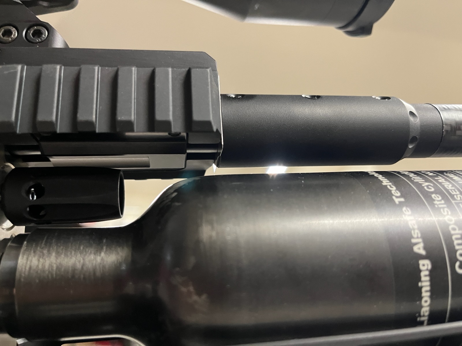

Yes. Some seem to be tensioned against a fitting that is tight on the barrel and not against the breech, like the new tensioner for the Ghost. This one also has the new barrel clamp. Belongs to @5Power
