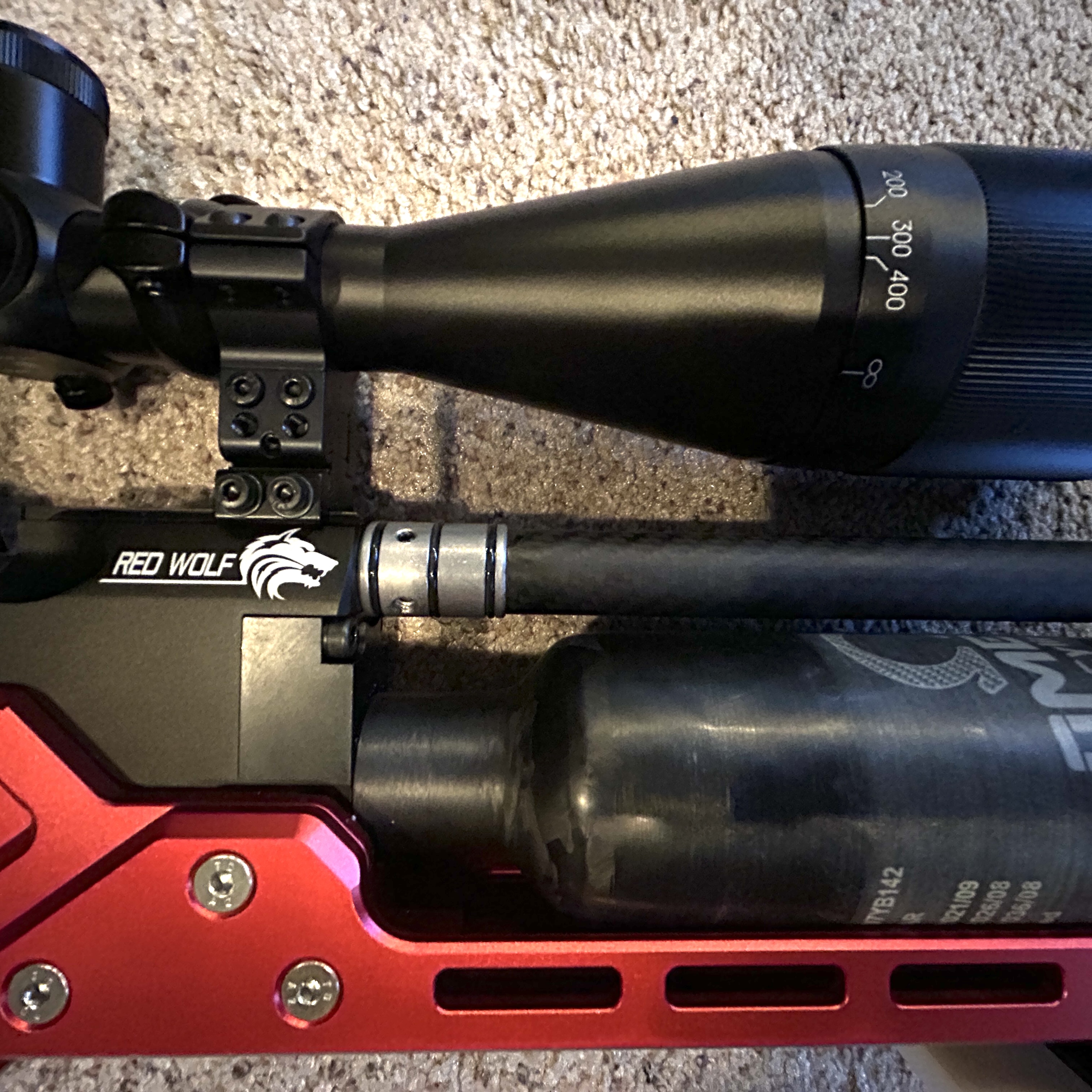

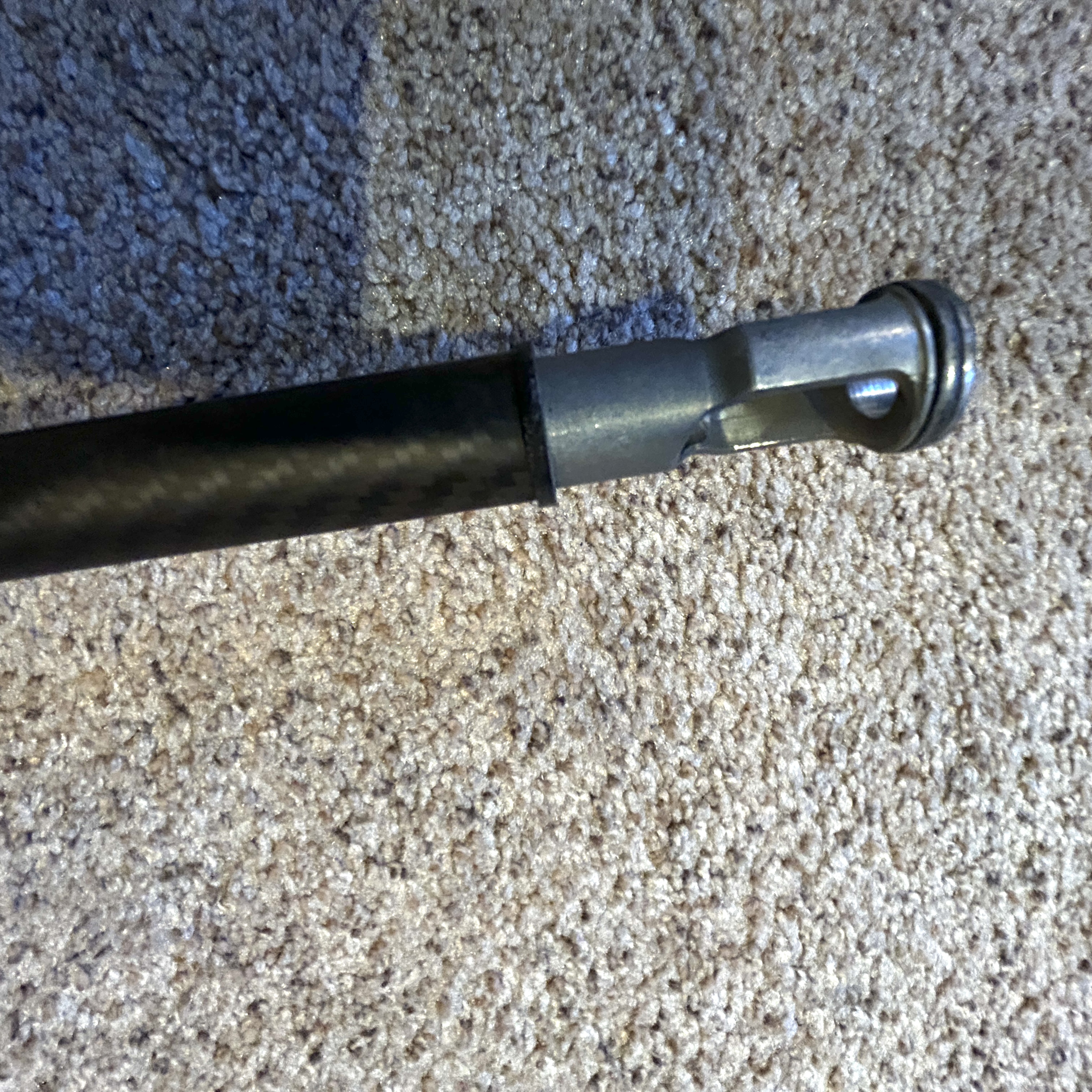

This is something I made for my RedWolf, a carbon fiber sleeve that fits tightly around the barrel and buts up against the factory aluminum block for the o-rings that the outer carbon fiber sleeve slides over, this intern fits tightly against the receiver allowing for different tensions as sort of tuner?
I have machined different width spacers for amount of tension I want, plus I can use this with out having to use the outer Carbon fiber sleeve.
I originally designed this to not use the outer sleeve and attach a moderator directly to the barrel in this configuration I really didn’t notice any improvement in accuracy. When I used both inner and outer at the same time it definitely changed the groupings to a more rounded less vertical dispersion group (much prettier!) but actual measurements only slightly better.
