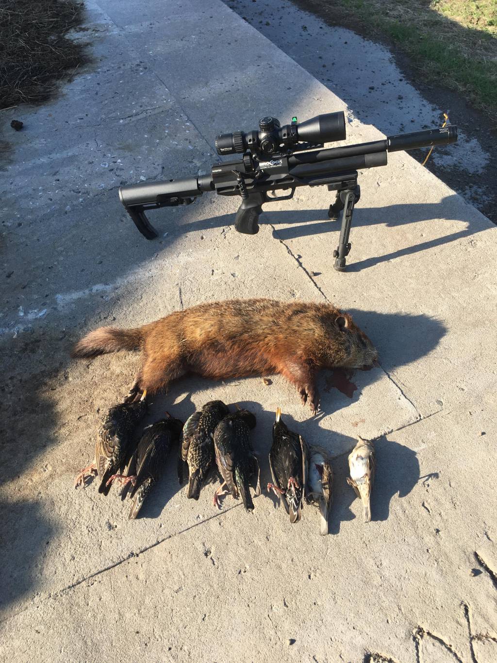

What's your fpe and shots per fill?
30-33 shots, 3 magazines from 240 BAR to 135 BAR, TP on high, 725 FPS avg., just under 17 FPE. This is how the gun came out the box, only adjustment I made was to lighten the trigger pull. If I had to pick between my Pathfinder or the Atomic? The Atomic without a qualm, powerful enough in actuality and can be supported with just a hand pump. SCBAs, fill stations, HPA compressors, not necessary. Just a hand pump and off you go. And unless you’re in an intense pesting environment or miss a lot, shot count is overrated. And for small game hunting in NYS the bag limit is 6. So plenty for a day afield of small game hunting. Hope that helps you and the OP.

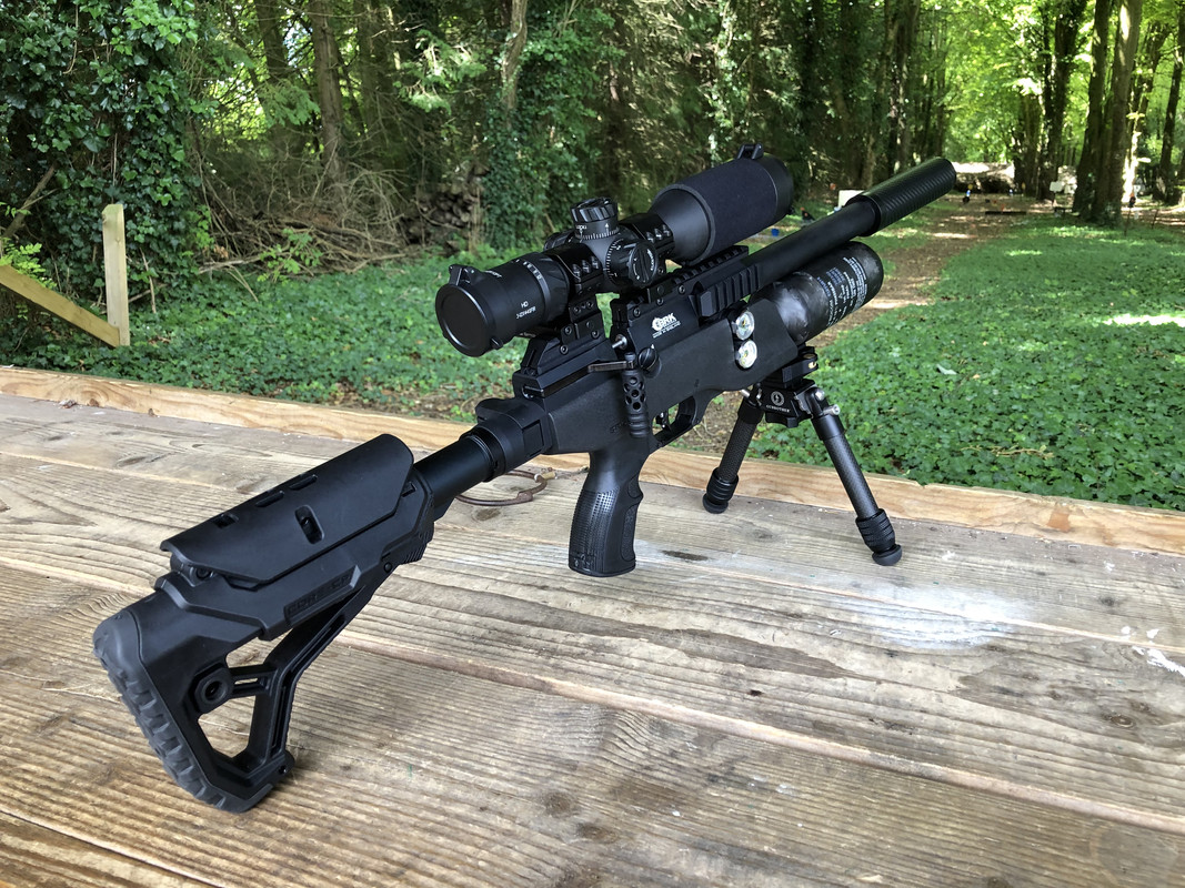

I agree, but the Ranger or Atomics come set up at lower power and pressures out the box. And the platform if not over scoped or accessorized. Is sweet handling, mild mannered, and accurate within its practical range. I simply love manipulating mine, effortless to deploy and did I mention simply deadly on small critters?
