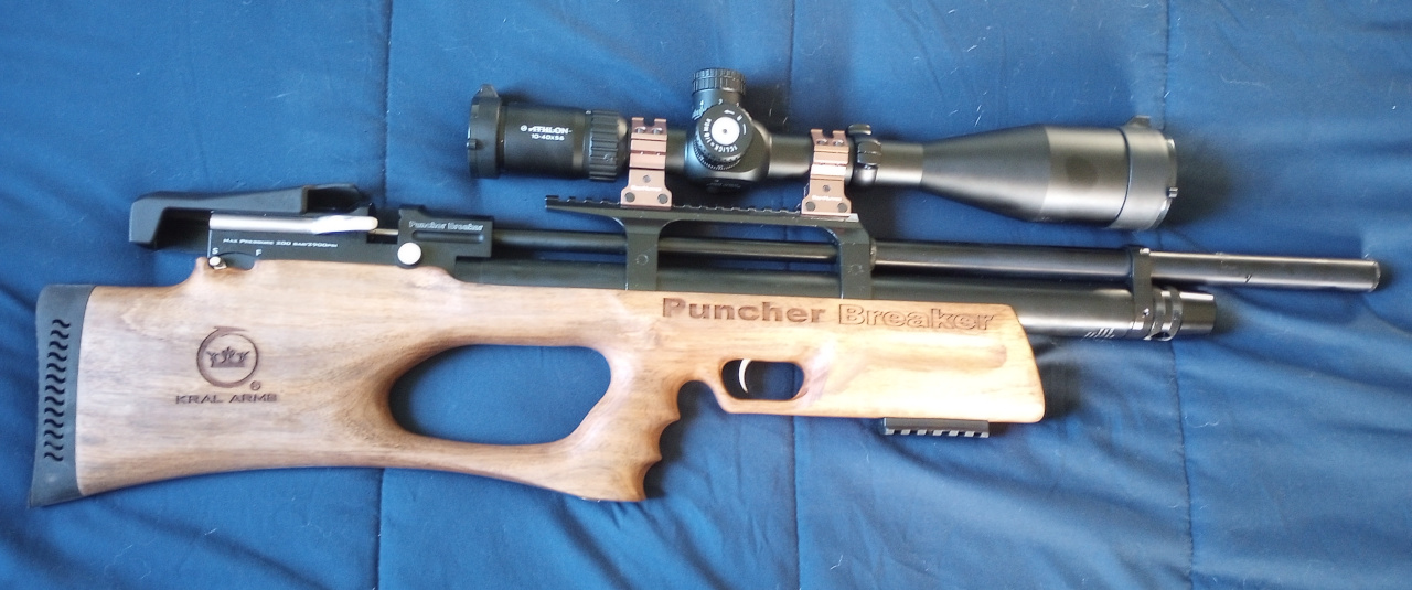

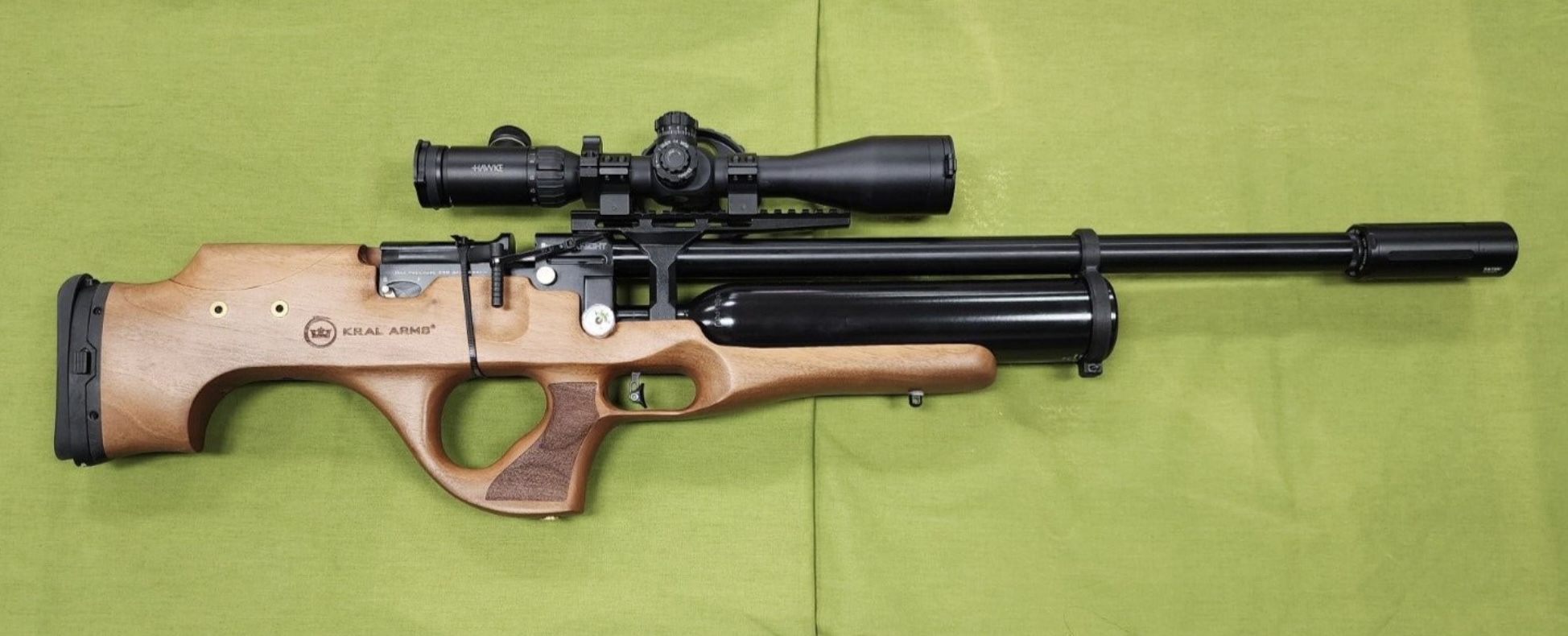

I just bought PA's very last Puncher Breaker with the wood stock. I was a little worried that, because it's the last one they had, that there might be something wrong with it. But 4 mags later it seems to be doing just fine. I need to get a foster adapter for the fill probe, find what pellets / slugs it likes and tune it for the best curve I can. But so far it shows great promise. I was getting 3-5 round single hole groups at 50 yds with Crosman Pirahnas and H&N 13 gr slugs. A few fliers and definitely has a power drop off, but that's to be expected. Excellent "out of the box" performance. Those of you that have PB's in .177, what slugs / pellets does yours like?

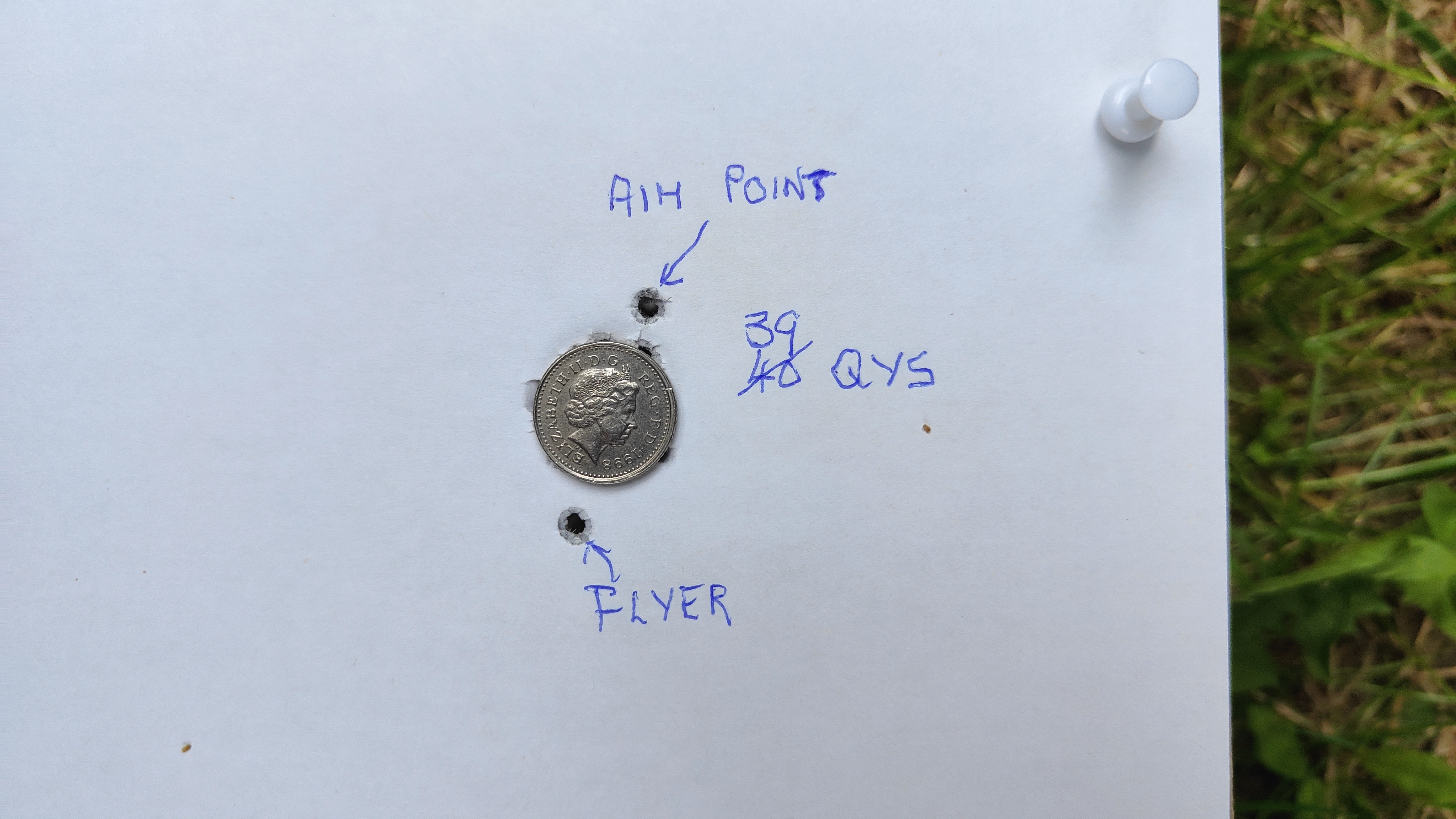

I have the NP02 Puncher breaker. The best pellet I have found for that barrel which has needed a lot of work is QYS DOMED in .177. It is now very accurate sometimes. For instance. Peeping our from under that 5 pence piece our smallest coin are 39 pellet holes at 26 yards my max. Thats a genuine flyer at the bottom. Five mins later I could not believe how many flyers I was getting. I really dont get it. I may re barrel it. Anybody know if a Lothar Walther barrel will fit. There is a second hand one coming up for sale. I have reduced the Choke from barely able to pull Patch through to about twice the effort it takes on my other guns. Bit scared to take it further. Still if I am going to change the barrel it really does not matter. Help needed.
I have the NP02 Puncher breaker. The best pellet I have found for that barrel which has needed a lot of work is QYS DOMED in .177. It is now very accurate sometimes. For instance. Peeping our from under that 5 pence piece our smallest coin are 39 pellet holes at 26 yards my max. Thats a genuine flyer at the bottom. Five mins later I could not believe how many flyers I was getting. I really dont get it. I may re barrel it. Anybody know if a Lothar Walther barrel will fit. There is a second hand one coming up for sale. I have reduced the Choke from barely able to pull Patch through to about twice the effort it takes on my other guns. Bit scared to take it further. Still if I am going to change the barrel it really does not matter. Help needed.View attachment 361313

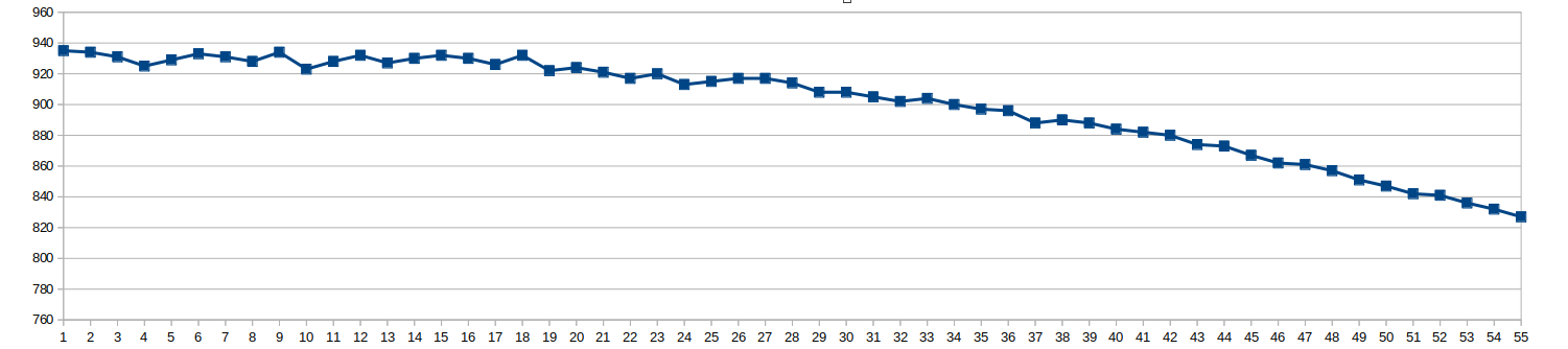

I shot 4 magazines of 13 gr H&N slugs over a chrony this morning. Starting with a 200 bar fill and stopping at about 130 bar, with the transfer port full open and the hammer spring all the way out, I thought it looked pretty good.
But then this evening, after the wind died, I shot another 4 magazines for groups and accuracy to 50 yds. It just would not group worth a darn! I'd zero with one shot, follow with another that was very close but then the next 3 would be 6 inches or further in never never land. I tried with and without the shroud, with and without a different suppressor, no change. I tried hand loading or magazine, no change. I tried slowing it down by turning down the transfer port, and the same thing would happen. (Edit: I also tried the 10.5 grain Crosman pellets, no change.) I'd zero one and maybe get a second shot that was close, then poof off to nowhere.
This is my first .177 caliber air rifle (although I shoot .17hmr a lot) so I'm scratching my head trying to think what might be going wrong. I looked at the crown and I didn't see any obvious issues. Any other ideas @Dr. Kralenstein ?
But then this evening, after the wind died, I shot another 4 magazines for groups and accuracy to 50 yds. It just would not group worth a darn! I'd zero with one shot, follow with another that was very close but then the next 3 would be 6 inches or further in never never land. I tried with and without the shroud, with and without a different suppressor, no change. I tried hand loading or magazine, no change. I tried slowing it down by turning down the transfer port, and the same thing would happen. I'd zero one and maybe get a second shot that was close, then poof off to nowhere.

Did you refill before the afternoon shooting? The chrony shows it tapers off. The small air tubes tend to get pressure fluctuations due to the low volume. I've had my np03 tubed gun do this before. It'll shoot great for the first 18 shots, then the next 2 change point of impact, even thought they're still going near the peak velocity. Its tuned around 805 with 25.4s for 20 shots, but 19 and 20 will shift a bit down and right, even thought they're going 795ish. Shouldn't be any change of impact, but there is. Also, the next shot will be 730s and then 680s.
That quick drop tells me the valve is burping after the pellet leaves and is causing turbulence behind the skirt and causes a spiral. Try and shoot with the sun beyond you and watch them. I bet they'll start cork screwing on the low volume shots.

Yes, filled it to 200 bar and shot it down to 130 bar, just like the morning shoot.
Could it be something as simple as the barrel getting fouled? I haven't cleaned the bore since yesterday and put maybe 200+ rounds through it since. Are these .177 barrels that fussy about fouling? I know my .22 barrels can go hundreds and hundreds of shots and I barely notice any change in accuracy.
