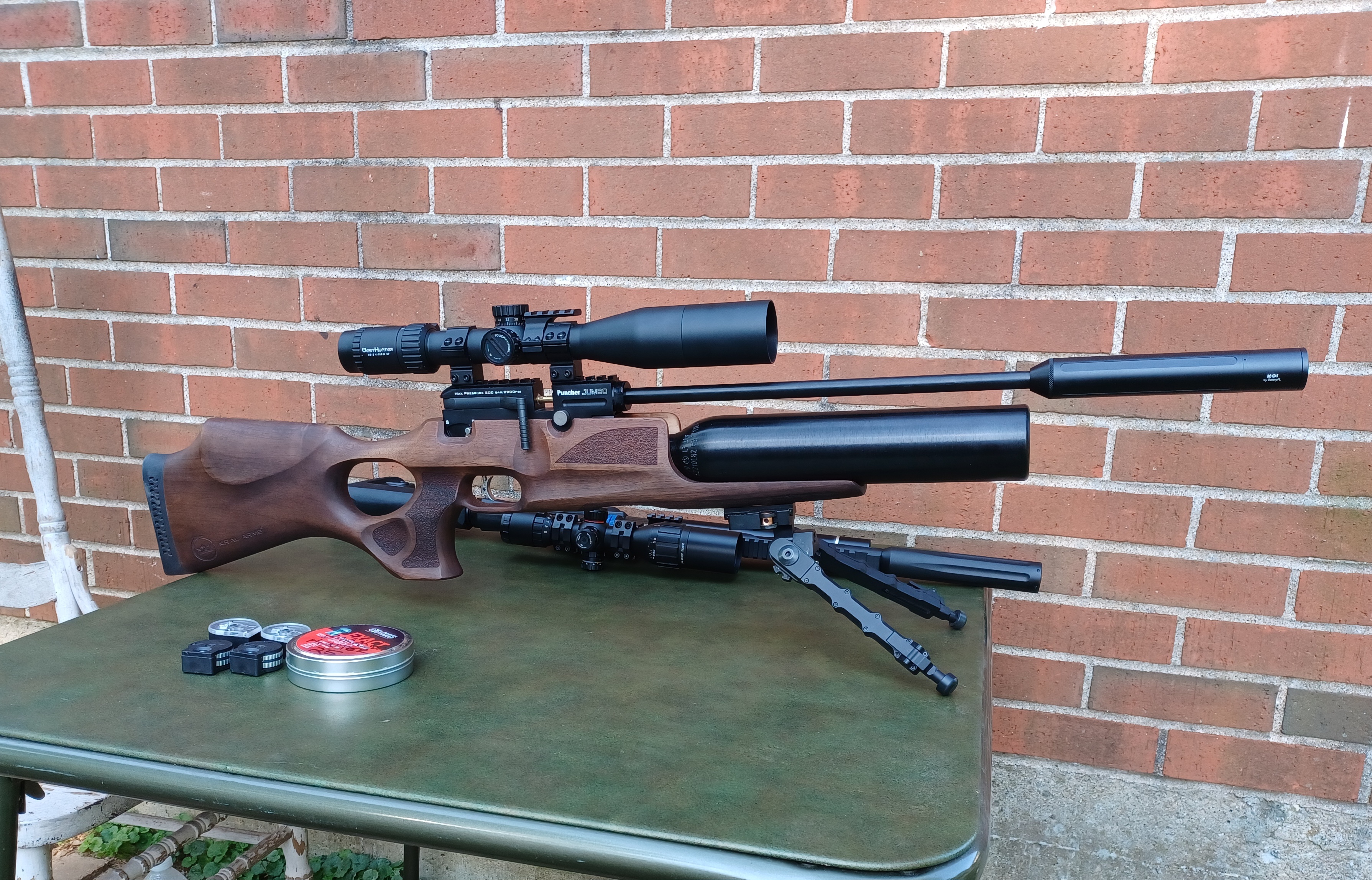

Just had the 25 cal jumbo out, on a bipod rest and shouldered. Getting eaten by bugs, but I still got some good groups. Only to 35 yards, but the groups stay pretty tight out to 75.
The left is baracuda 30.86 grain
The right is jsb 33.95 MK2
Both are 10 shot groups! The flier on the baracuda was all on that damn aphid crawling on my open eye not behind the scope 😆
