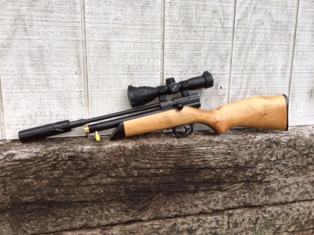

My Weerod
@Fuciliere Very classy look to that furniture, almost looks like a Air Arms TDR, but better because yours has a folding stock
Thanks Legionair, I didn't expect it to come out like that too, Idea was just in my head and I hate the thick handle and the ergo, so I just carved it out as it goes along and added the foregrip to make it easier to hold and shoot

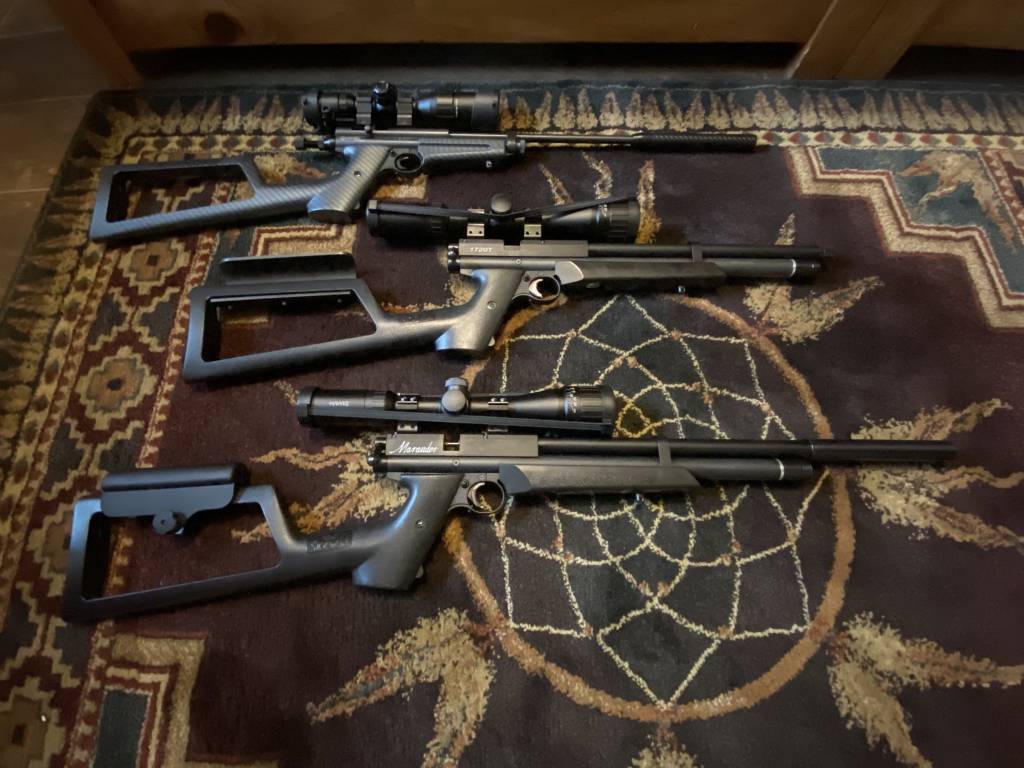

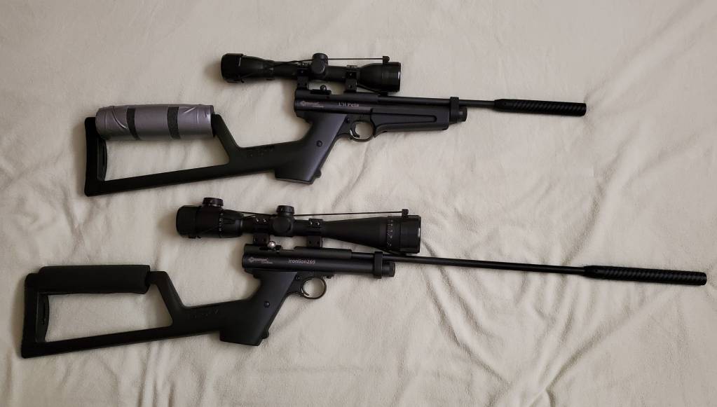

Crosman 2300S and 2400KT wearing matching Crosman stocks.
The shorter carbine is L'il Pete: 2400 chassis in .177 with 10" Walther barrel and a 5" TKO slip-on moderator. Currently using a simple 4x32 scope since my eyes aren't up to open or peep sights. Pellet on pellet accuracy at 10 meters with gun rested on a bag, getting ~60 good shots per CO2 cart.
Longer gun is Ironlion269: 2300S chassis in .177 with an 18" Crosman barrel and 6" TKO slip-on moderator and 3-12x44 Centerpoint scope. Like its little brother, the 'lion is extremely quiet and very accurate within the 20 yard limit of my range.

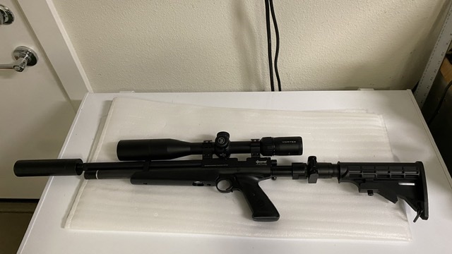

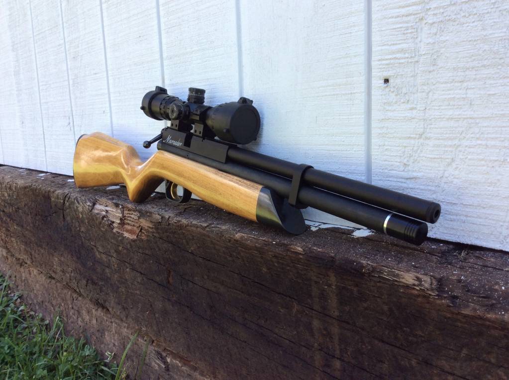

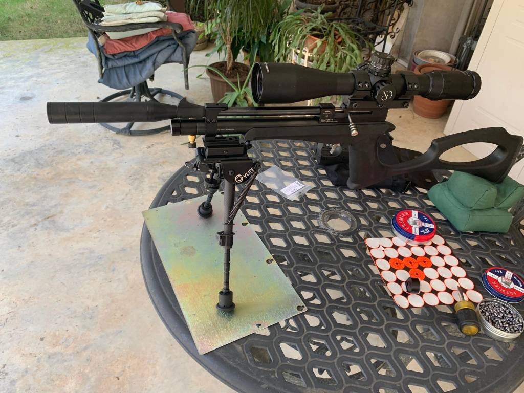

Diana Bandit .177
Pistol from AOA
Huma Regulated
Stock from Canada Shooting supply.
https://www.canadashootingsupply.ca/cp2-converter-kit.html
https://www.canadashootingsupply.ca/shoulder-stock-for-diana-chaser.html
Storm Rider barrel band from same.
https://www.canadashootingsupply.ca/diana-stormrider-barrel-band.html
Standard picatinny rail screwed in perfect on barrel band with no modification Cheap bipod Crosman Scope
Shoots dime groups at 15 yards 700 fps wth cphp and 720 fps with Crosman Destroyer 18 shots per fill (2 mags)
