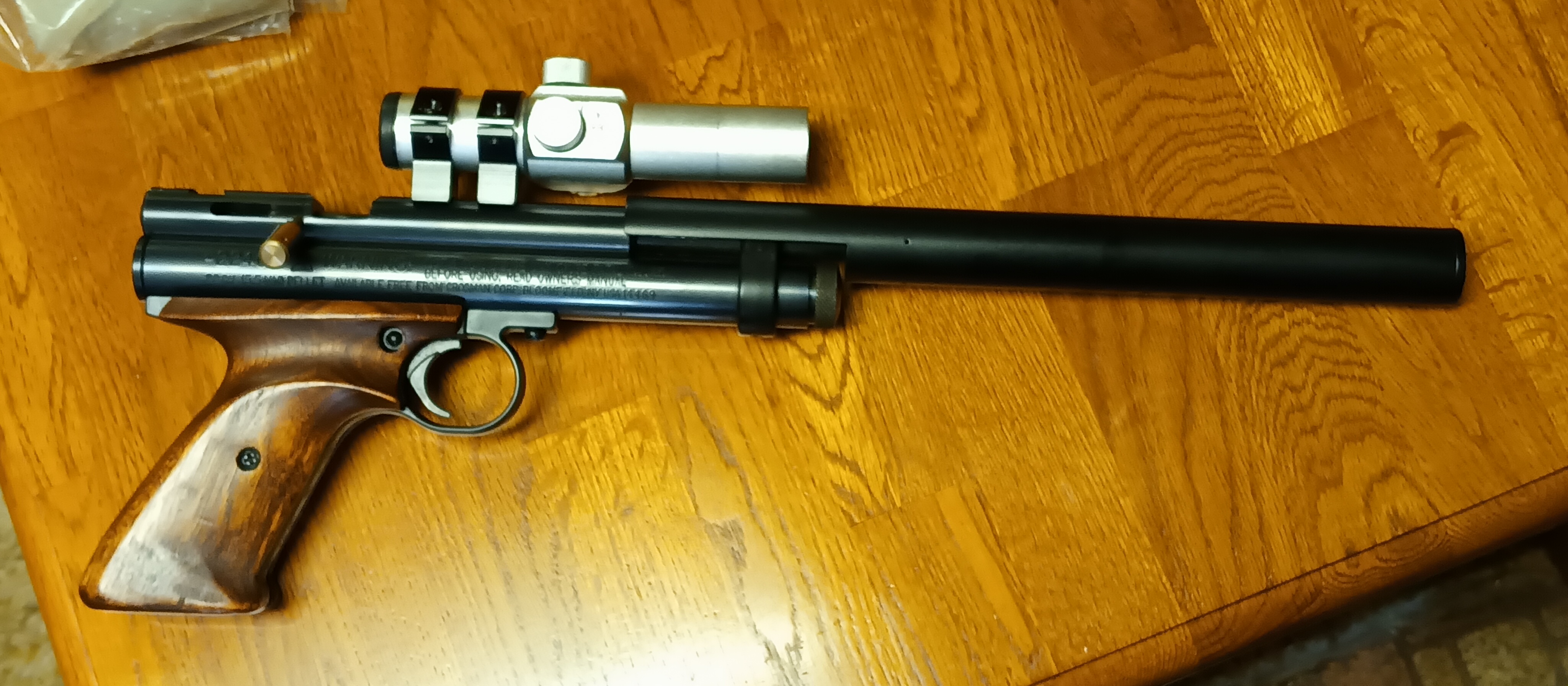

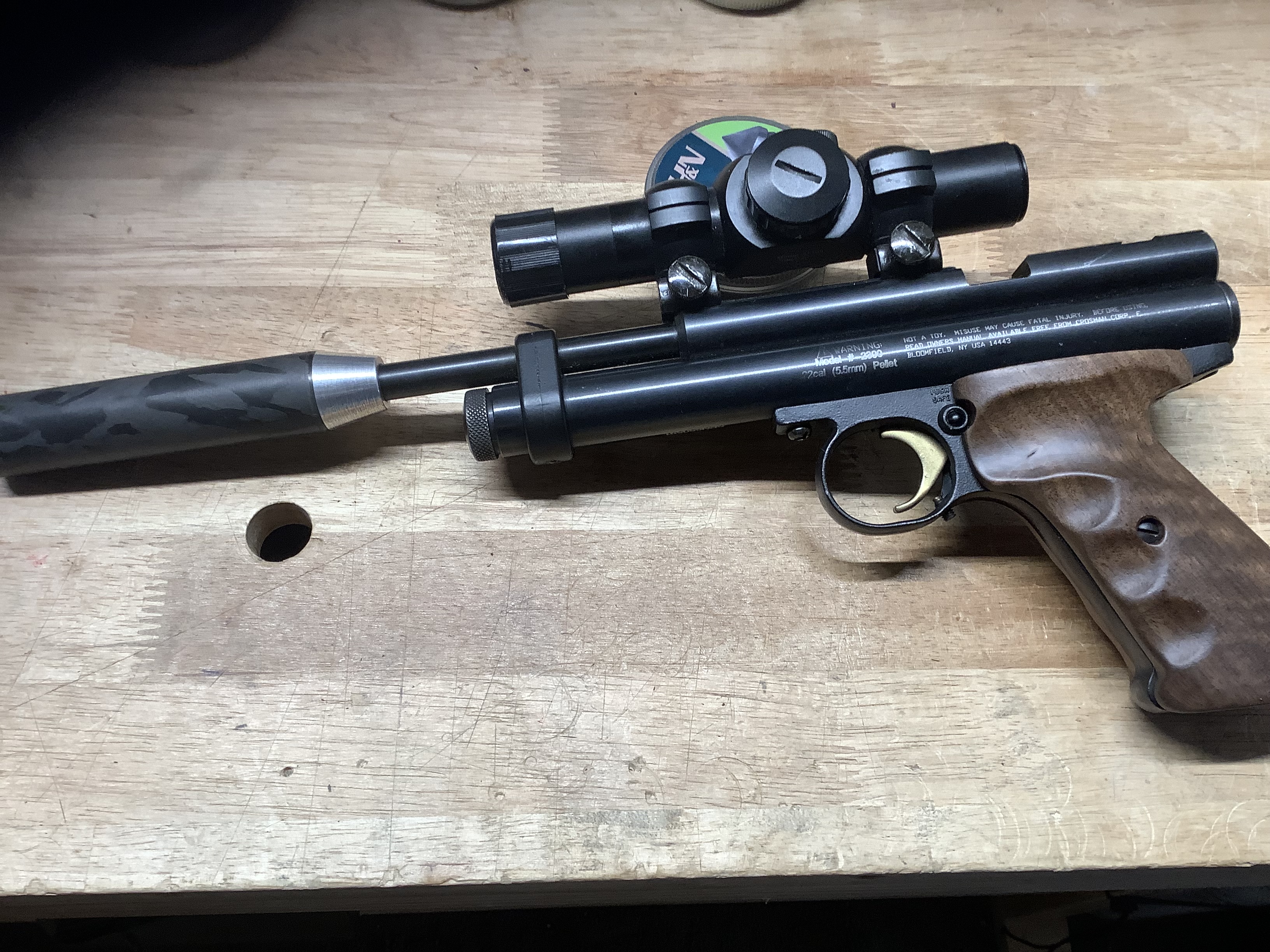

Here's mine,
10" barrel off a 1322, my own trigger sear, my own full length shroud/moderator and bolt handle. Millett red dot was a craigs list special, 10 bucks. Grips were blanks off ebay. Quiet and accurate like it's supposed to be.

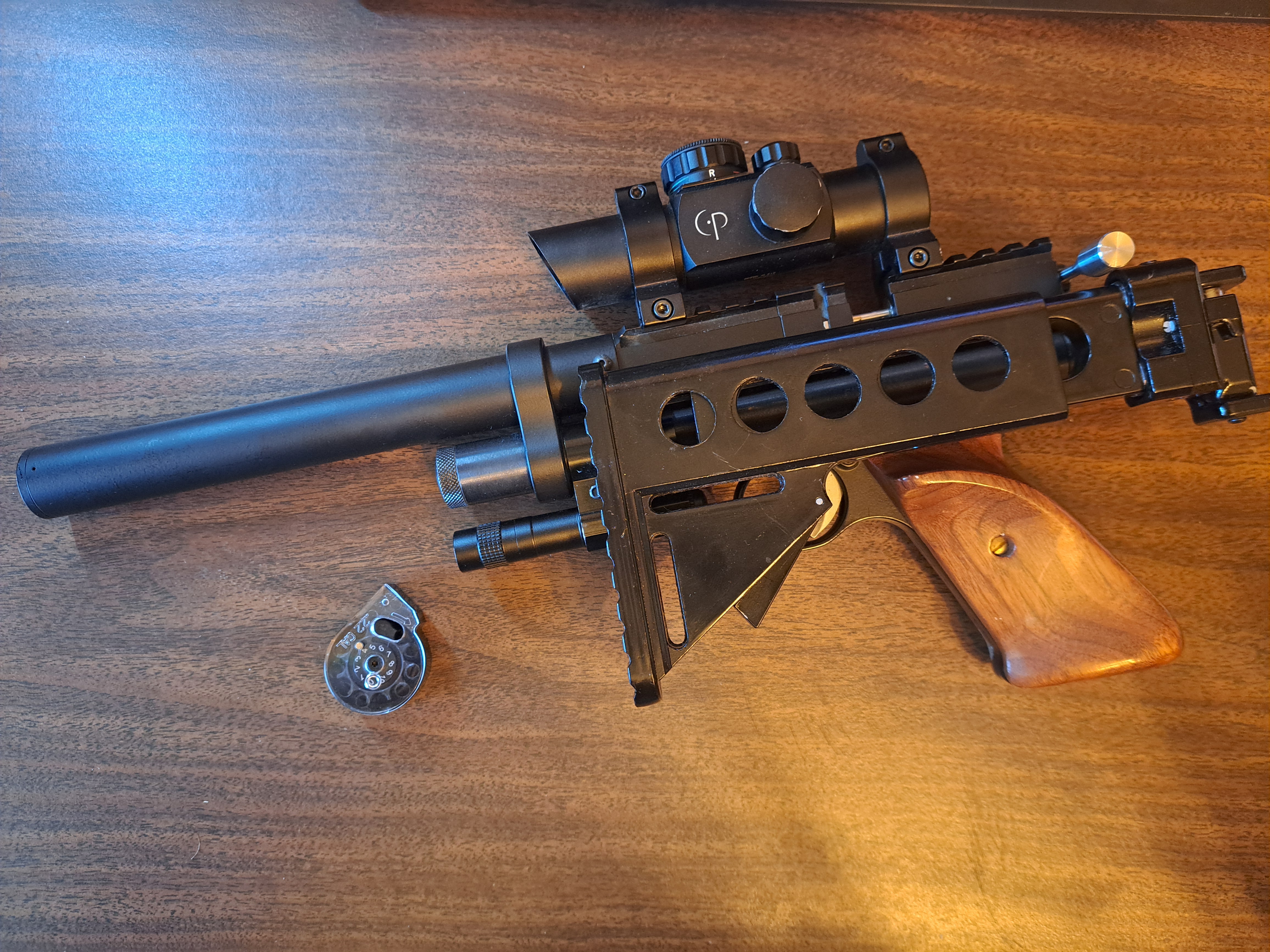

I run 14.3gr domed in mine, no jamming at all which I attribute to the rounded nose on the pellets. I get about 35 shots per cylinder but limit it to 30 and dry fire the last few until it goes full-auto and dies. Otherwise it could jam as the auto-loader isn’t fully cycling. That’s something to avoid because some of the auto-loader internals are a bit delicate and you don’t want them getting “slammed” against a solid stop.
I also extended the barrel and set the gap to .002”, and that definitely brings up the fps
