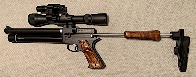

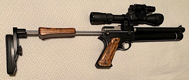

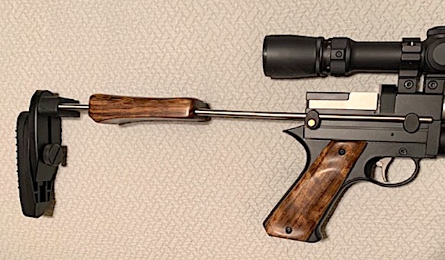

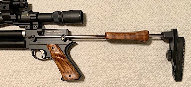

I'd found the least impressive part of shooting the PP came from making cheek contact with the steel rods of the retracting shoulder-stock. Besides a distinct “Oh, that’s cold” impression, the thin rods not only don’t give a comfortable ‘cheek weld’, but flex a bit in use; none of those distractions contributing to the level of concentration required for precise shooting.
Unfortunately after discovering a custom wooden cheekpiece solved the cheek-weld and flex issues, I also discovered a matching piece of Shedua large enough for a set of matching grips. DOH! Well, I was looking for a project to get me through the pandemic shut-in, and the shut-in is dragging on… and on. I’m pleased with the custom grips and cheek-piece; nice cherries atop my sweet, sweet 'Little Sidekick' pesting rig.

.22 Artemis PP750 sidelever PCP pistol/carbine
