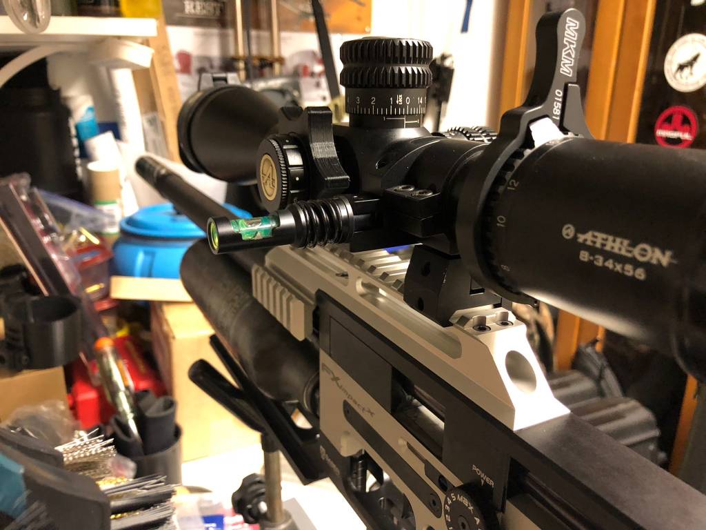

Heres an alternative option from MK Machining. A star studded 3D print parralax wheel. They carry these for all model athlons. My helos knob was tight, also, till I pit this on. I have these stud wheels on all my other scopes as well.
