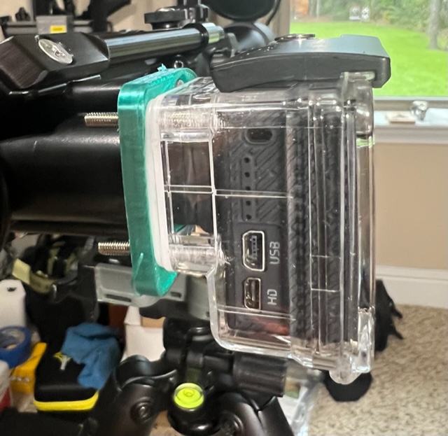

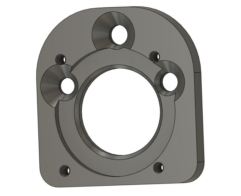

This is an adapter made for Firefly 8SE and GoPro Hero 3/4/5
-Adapts Sideshot (Phone version) to Firefly/Hero
- This adapter plate leaves plenty of room for the three counter sunk screws to sit just below flush when attached (no interference with GoPro/Firefly). The smaller holes that hold the camera case are 2.3mm in diameter.
- To use this part...You will need 4 M2.5x12 Countersunk screws. M2.5x10 will also work (measured from the start of the threads to the end of the screws). They will screw into the plate firmly with no nuts needed.

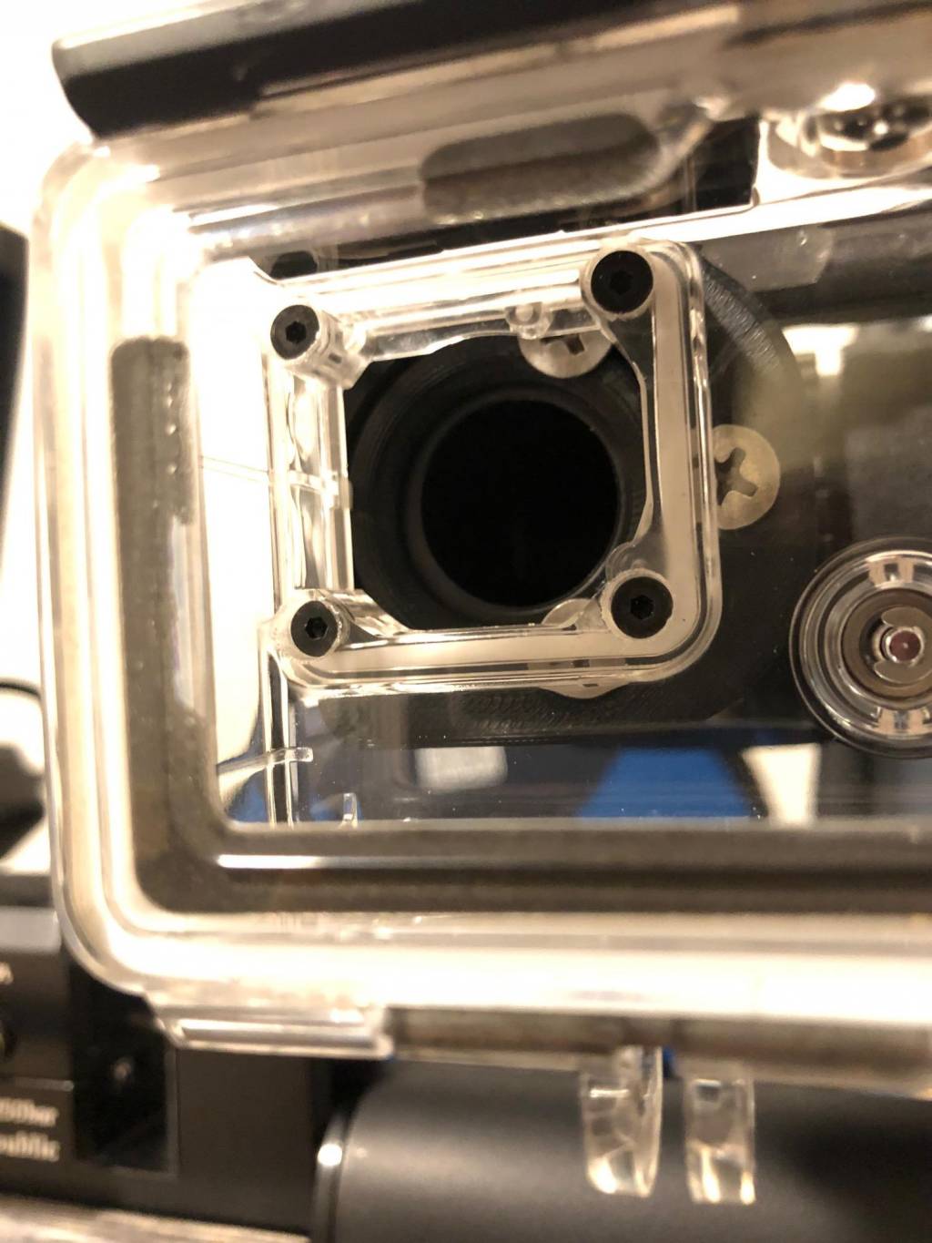

-Drill out the existing holes in the Firefly case/Hero case with a 3mm drill bit and counter bore with a 5mm drill bit.
- I can provide .STL's for any degree of offset if needed (although I had perfect alignment).
- Print out of PETG, ASA, ABS or any other durable material. No supports needed.
