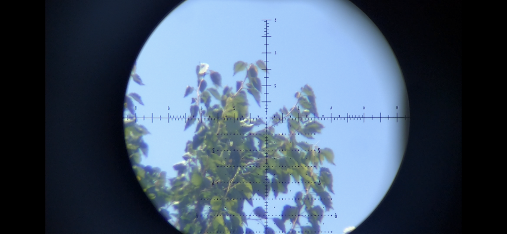

Sideshot with go pro 7 black.
Just mounted my sideshot with the go pro 7 black, just did a quick adjustment on the eagle vision lens.
Can i get better quality out of it? its at 1080P 120fps on a helix ffp.
How can i get rid of the black shadow around the ring?
There’s a lot that goes into getting it really clean! I transfer my side shot between 3 different scopes, and each scope requires a different adjustment to the lens. I have my lens marked so I can easily adjust when doing so. In order to get the results I wanted, I literally spent all day recording clips and making adjustments. Sometimes adjusting the optical focus on the eyepiece of the scope helps clear up the image as well. The best way I have found to get a crisp image is to focus the lens on the reticle it self and not on what your looking at through the scope. Once you get the reticle nice and clear then you can experiment with very very small turns of the lens and see if it improves any. I also took some painters tape and rolled a small piece inside out to place around the lens so It doesn’t move. It takes some trial and error to get things “right”! Hope that helps some!

This is a subject that I have poured more time into than any other accessory or shooting peripheral aspect of air gunning. That said my experiences are mine and not necessarily the most efficient or the most direct resolution path to a challenge but they work.
The GoPro requires a lot of time to initially adjust and mark focal points on the camera and the lens to make your life easier. An external monitor so you can live feed is a huge time saver as well else you will need to make multiple record and review sessions with small adjustments until you get things right.
The dark shadow you see typically rears its head at the extremes of a scope's magnification range. This is due in part to the fact that the higher the magnification the narrower the sight path becomes, so if you nail the concentric sweet spot using the high magnification you are typically good to go at any lower magnification. Now obviously as you are setting the scope camera mount up initially you will want to use minimum magnification so you can achieve the proper eye relief and general alignment but for the nitty-gritty stuff, you will need to increase magnification.

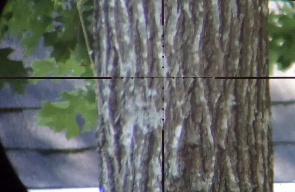

    During the filming of this video, there was substantial heat haze or mirage but both cameras were exposed to the same condition. As I am writing this article I am thinking that I may install a new EV 1/18" lens on my GP7 and try again as I have an early version lens currently on the GP7 and it MAY be cloudy or out of spec.
    One of the most annoying things that I experience is if I have the GP7 with EV1/1.8" Lens installed and crystal clear that the crosshairs will blur out as I change magnification which the only way I have found around this is to set the scope at let's say 18 magnification and adjust for extreme clarity and never adjust the magnification again which, to be honest, is not really an acceptable option as the optic has a 5-25x usable range.
    The YouTube Channel EdGun Leshiy Channel even speaks to this reticle focus issue and if you watch his setup video you can see that he edits the reticle in and out of video and he has a fixed power scope mounted in this video. The video will start at the part I am speaking of.
    https://youtu.be/OBfRLp39JiU?t=478
    Now he could adjust the focus on the lens and get the reticle sharp but he likes the option to in post-editing turn it off so you see the pellet in flight better. The thing I want to point out here though is to look at the target image clarity, you notice the same cloudy, slightly milky, not as sharp an image that you know you should have what you and my video show?
