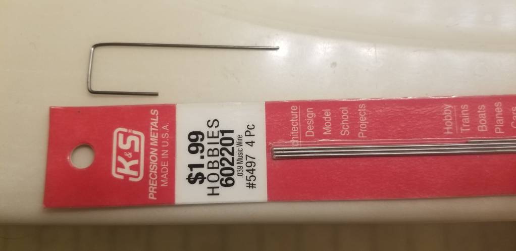

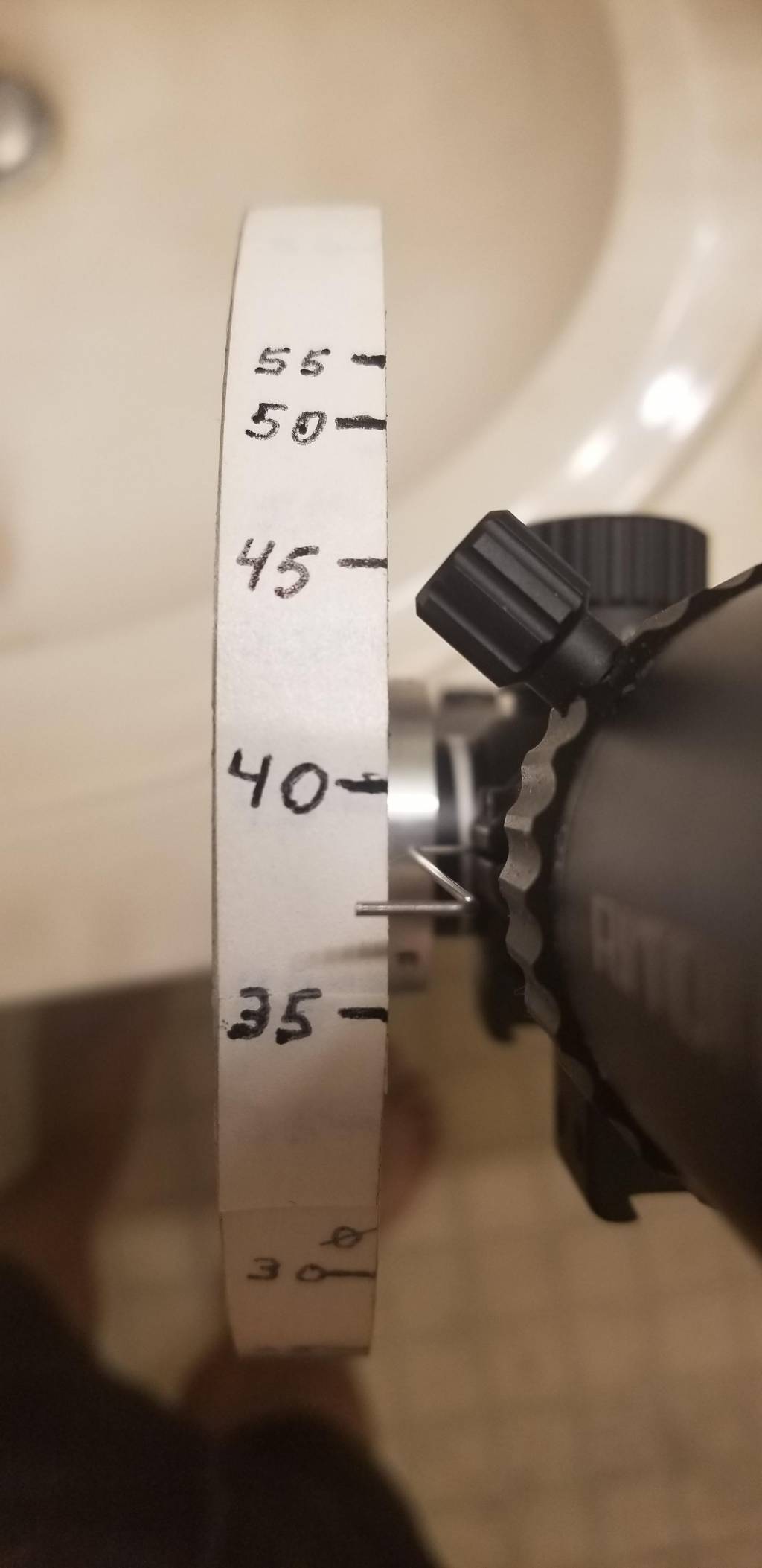

Merry Christmas Ronnie. Just go to your local hobby shop and get some thin metal rod. You can bend it to any shape you need and various thicknesses available. I just determine what shape I need and bend it. Then I pinch it in the split line on my scope ring. Works great for my needs! This one, the long leg pinches in the ring split line and the "U" shape straddles my side wheel so it looks like a solid bar across the face of the wheel to show yardage mark. The bottom pics shows another I made with just one bend pointing on the wheel face.
I like the top one (it looks cool across the face of the sidewheel) but prefer the bottom one as it is less likely to be tweaked or bent when squeezed on by the foam pads inside my hard case
