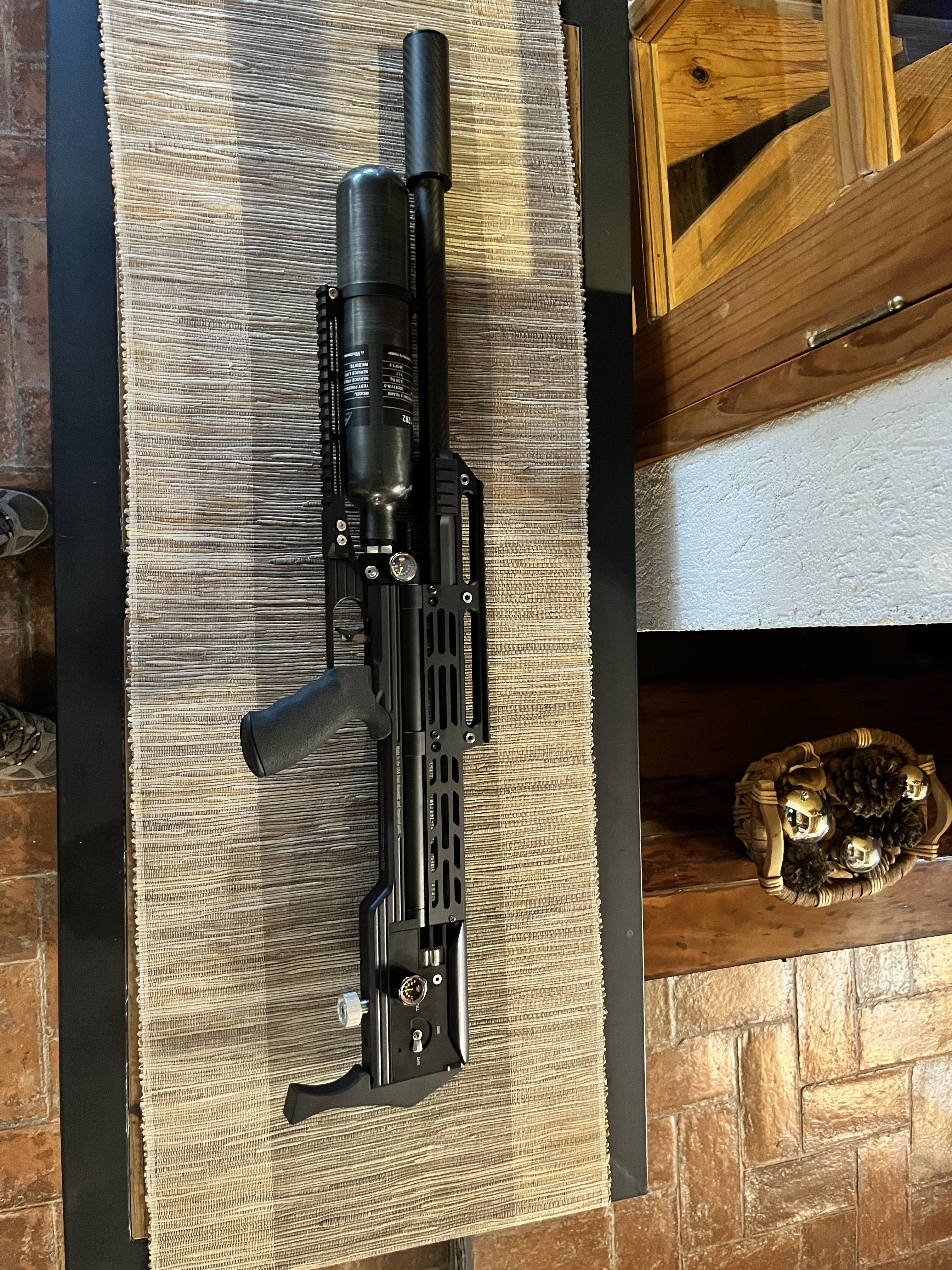

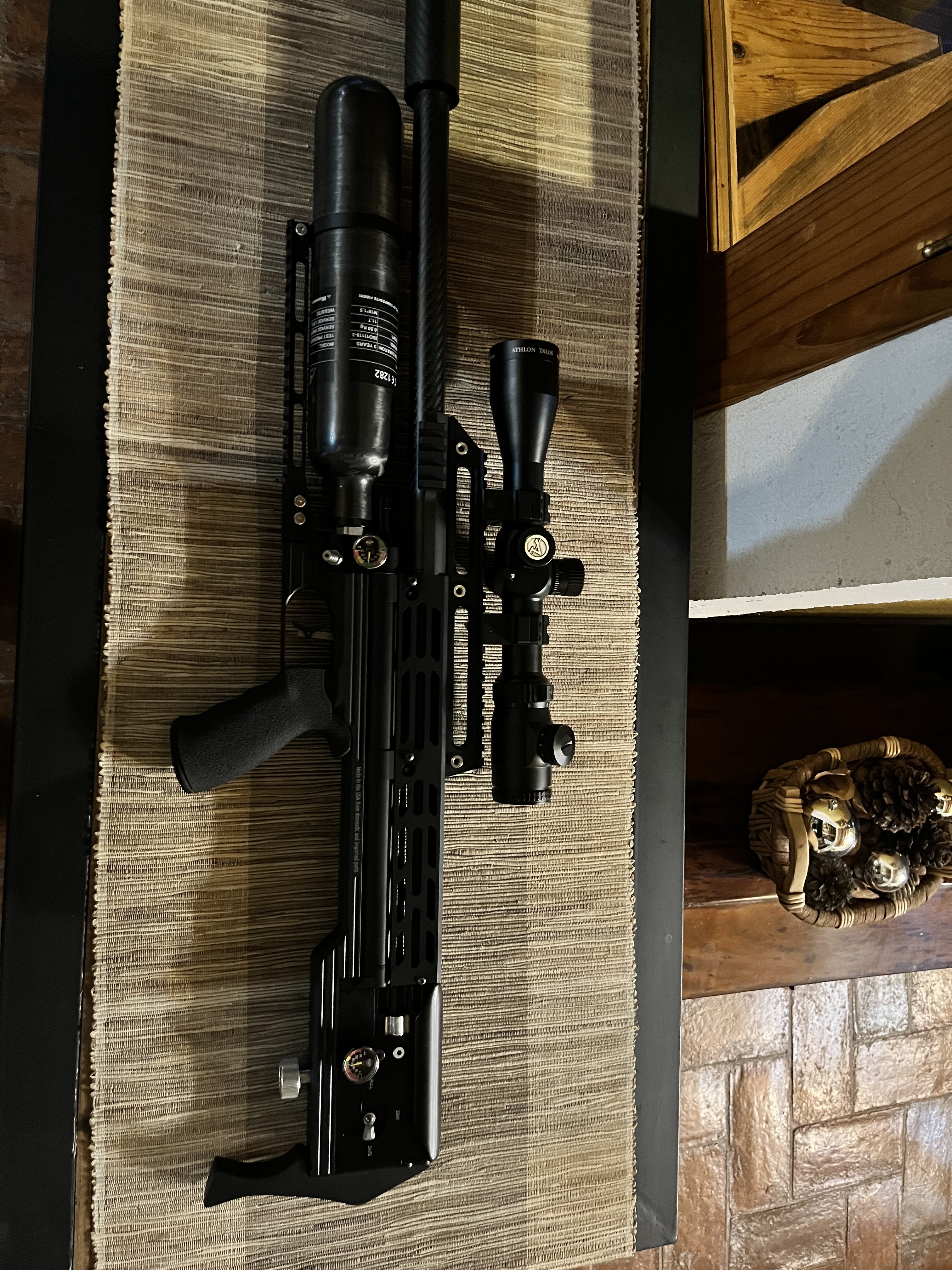

These are my first comments on the Sidewinder .30 Cal that I just received.
The rifle arrived filled at 250 bar and regulator set at about 149 bar.
The rifle feels really light.
My Daystate Wolverine HP. 25 Cal seem to be louder.
Total length is perfect for handling.
The ergonomics are the best I have seen in an air rifle (even better than the Uragan). The one who designed the ergonomics of this rifle is a genius.
The trigger has a long midle weight first stage and shot is not so predictable. But is not bad, you get use to it.
The Sidewinder has a safety/Semi/full auto selector and a safety in the right side above the trigger.
Magazine is all metal and very well designed.
With 12 pellets the rifle was dully zeroed.
At the end of this first zeroing 15 shots session I was able to hit a stone the size of a golf ball at 190 yards. The rifle seems to be really accurate and consistent.
View attachment 339510View attachment 339511
Tomorrow I will make groups and I will measure fps.
