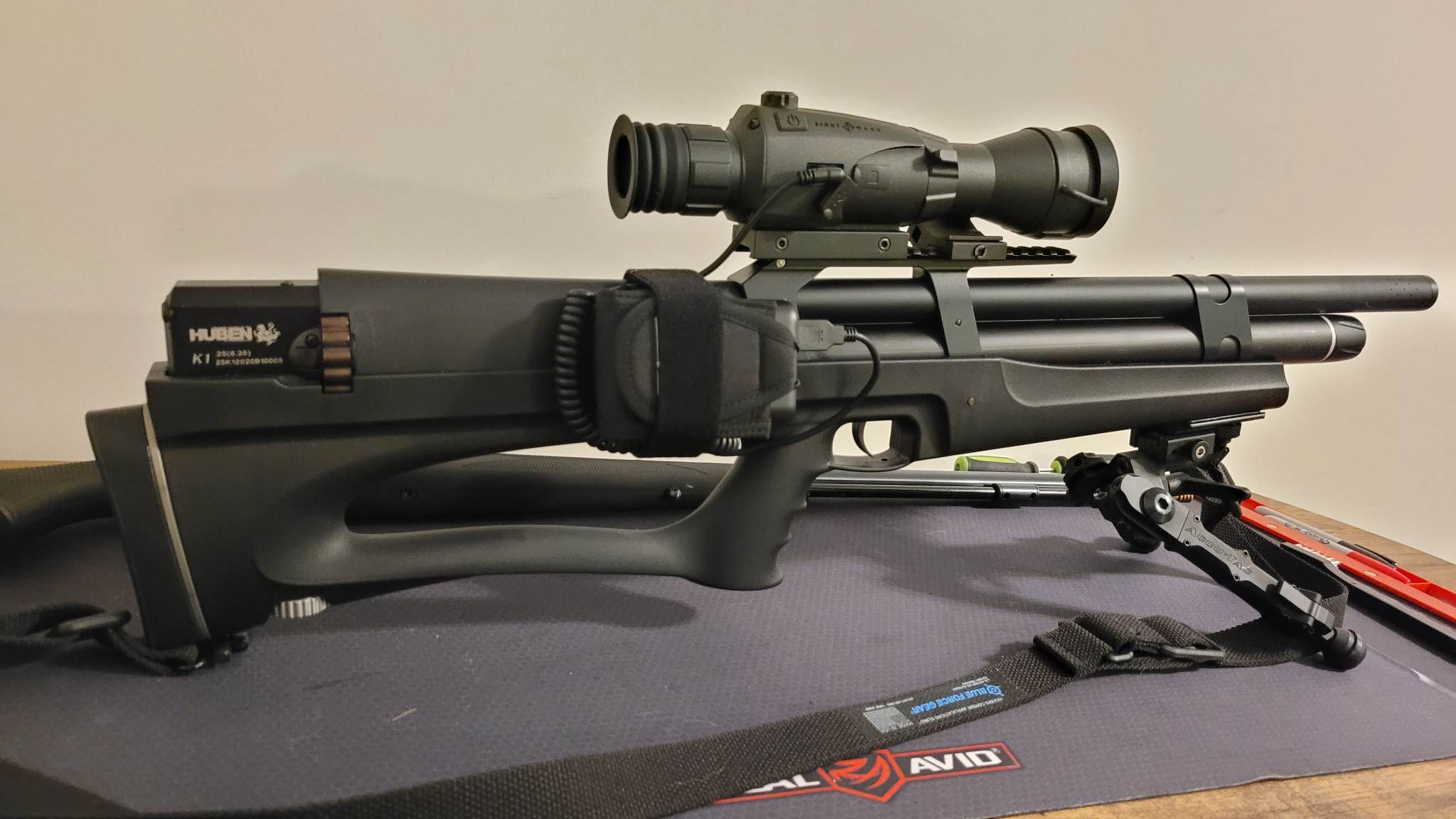

Hey we are pretty close to one another!!! My huben as of last night
Reactions: Stackofhay
North Shore of MA here - Nice gun! I've been thinking of getting the Accu-Tac bipod - how do you like it? I'll send a PM if I'm heading your way - maybe grab a cup of coffee!
I have had UTG , Accushot and 3 different models of Accu-tac. The other 2 models for my uses were complete overkill as this BR4G2 model is just awesome, its the smallest of their line up and it is super stable. Like scopes, getting into a high end bipod, youll never look back. It outclasses the Accu-shot (atlas) bipods in every way.
I grew up and work in oxford, ma, not too familiar with north shore but thats ok
