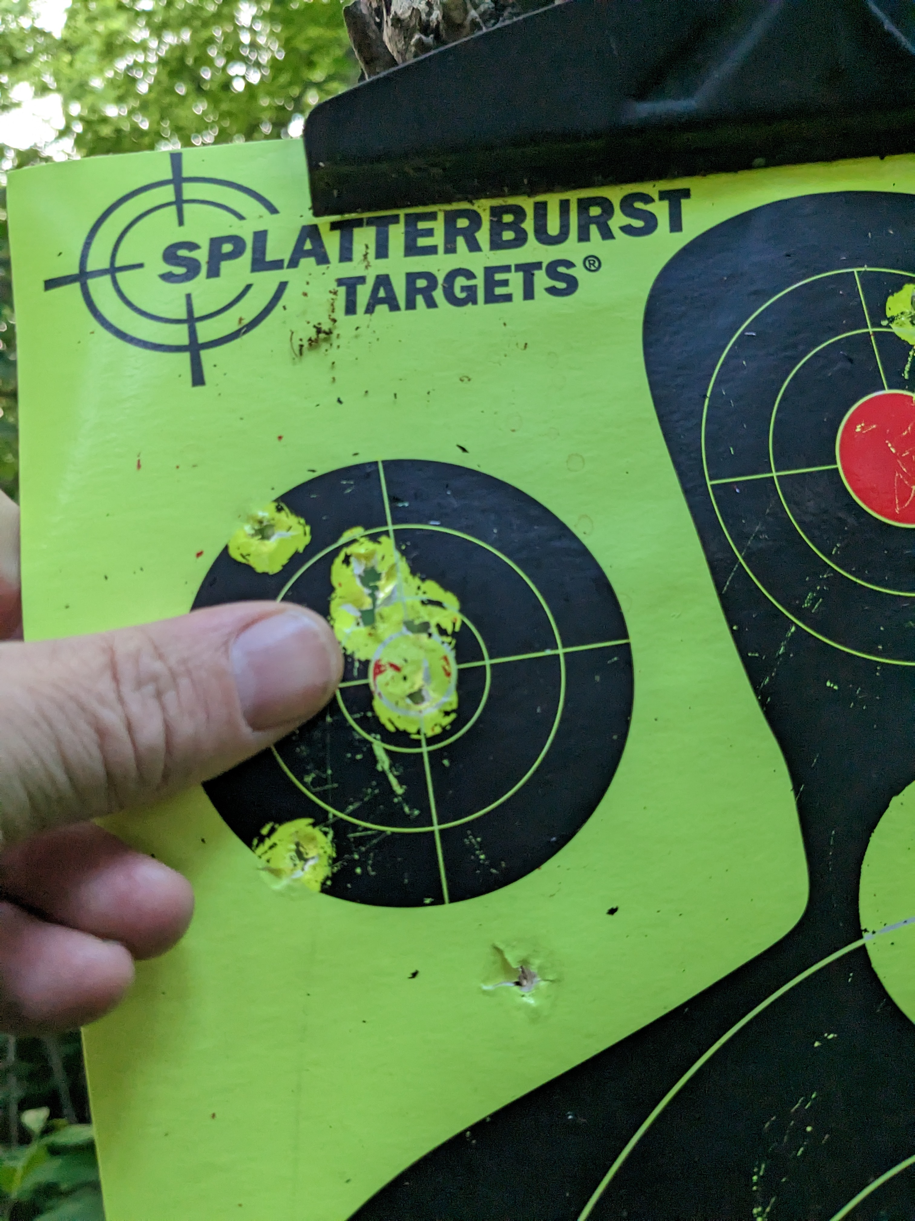

on my huben .22 i get 3 mags (57 shots) from a 4500psi fill.
Shooting jsb rdm @ 950fps, and this is a 5 shot 100yard group with the upper and lower shots being sighters.
