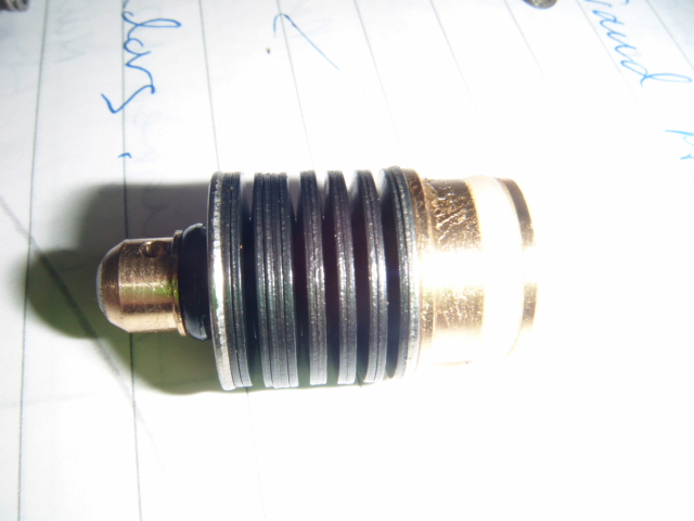

Here are the results
)()()()()( - 1100 psi - stock
)()()()()( - 700 psi
))()()()()| - 1100 psi - ? doesn't seem right
))()()()()( - 1550 psi
))()()()((|| - 1500+ psi
()()()()()( - 1500 psi
()()()()()( - 1400 psi
Washers marked with a carat are the non-stock washers. They're .1mm thinner which has proven useful for tuning down a little (I don't want to go over 1.5k with a 1.8k burst disk in).
I have lots of springs and shims left over, so let me know if you'd like some.

So I bought the washers you had. When I took apart my regulator, I had a different setup for the washers. I had the following:
It says it's rated for 1100psi output (like it should). I don't have my tester in just yet to see what it puts out stock, but it should be, according to your original diagram, it should be around 1500psi and not the 1100psi it says on it. I ordered my air rifle at the end of November in 2020 so I should have the V2 version of it. It was brand new as well. Could it be possible that you messed up with your counting of the washers?

heres mine on 8FPE its got 13 bellvilles and 2 flat washers? I assume you I refers to the silver flat washers?

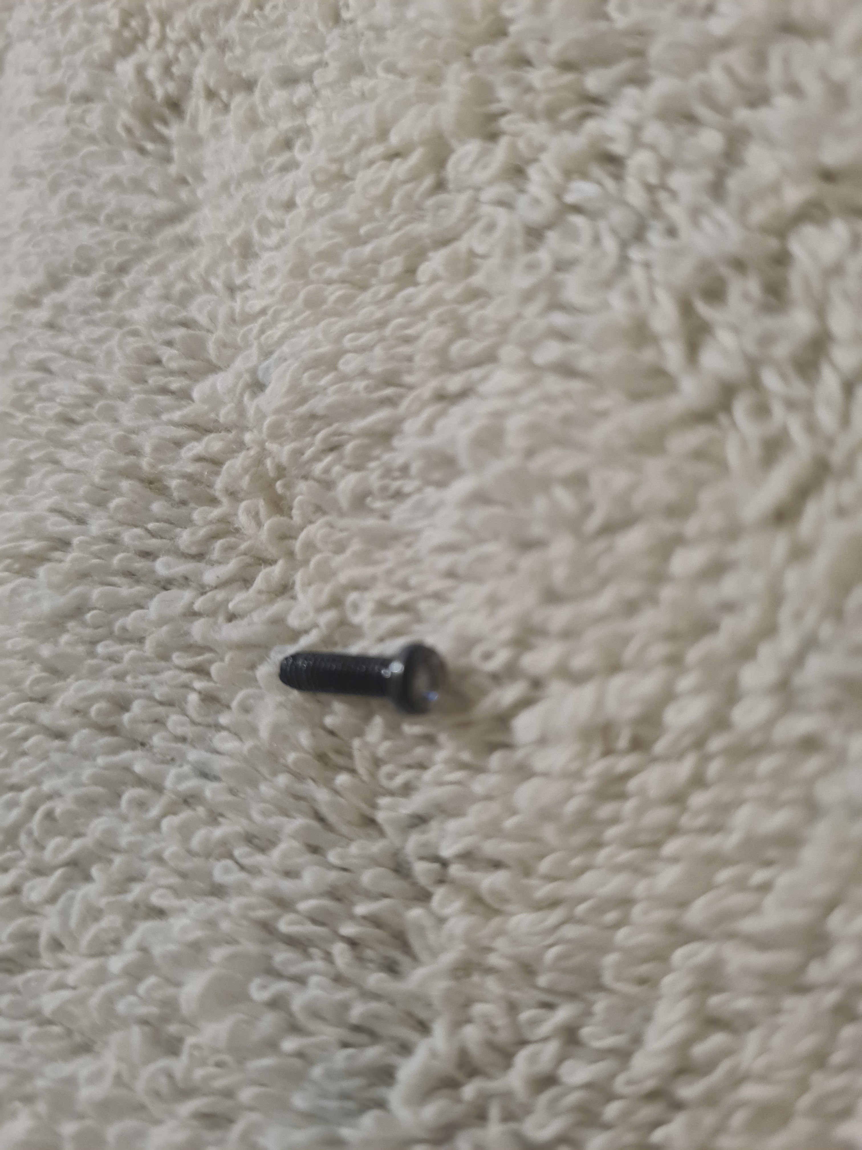

It's a bolt with the head drilled I used a left hand thread drill ( bolt extractor ) I also drilled out my magazine chain and put washers on each chain so they hold the pellets instead Of the 4 plastic flutes that damage the pellets , also changed a few other things inside (can't help myself I'm always tinkering with something in the workshop) Hope this helps others Mark Hall
