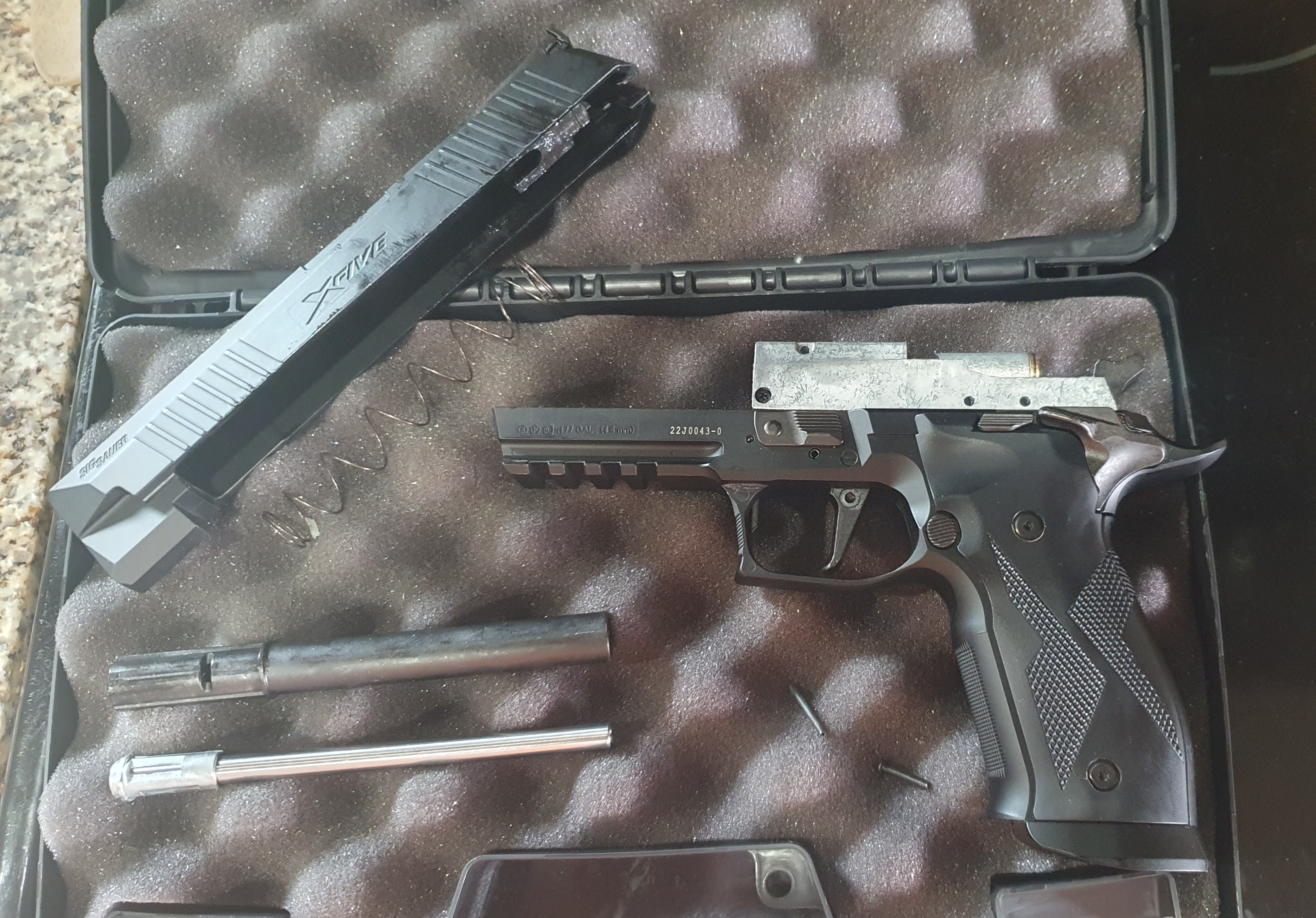

would love to be able to remove the slide so i can work on taking the wobble out of the barrel.

I had one of these, there is a roll-pin forward of the trigger, knock that out then the slide 'blocker' drops down, and then you can pull the slide all the way back over the hammer and lift it up and away.

i hadnt noticed the slide blocker drop down the last time i had the pin out,
came apart easily and can now tighten up the bit of slop in the barrel :cool:

Sorry, how do you exactly knock the pin out? Mine does not want to move at all, I even deformed it by applying force. I need to disassemble the gun because I got pellet stuck and I can't remove the mag.
