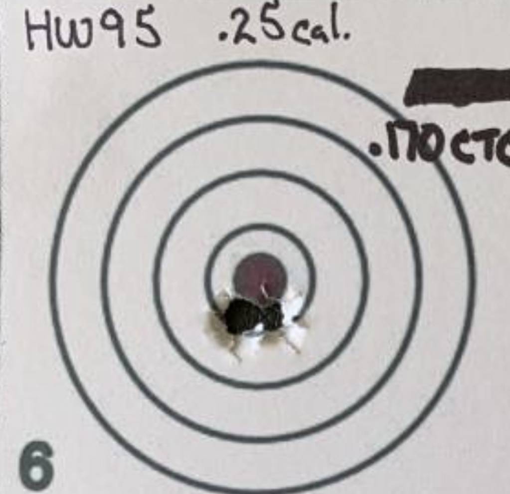

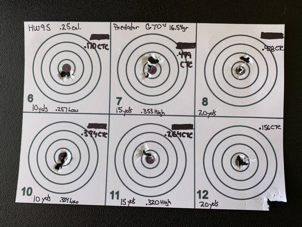

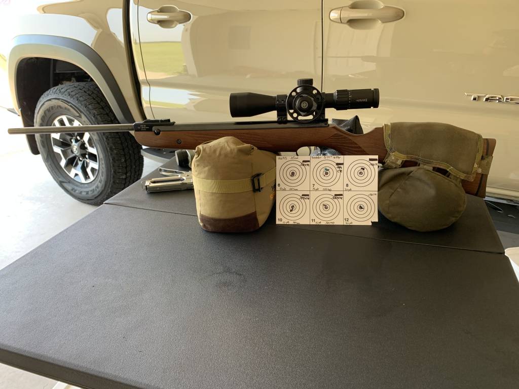

Got a ways before it’s time to hunt rabbits here but with me waiting on a tune kit to get my HW97 back up and running I decided to find the best zero for hunting using just the main crosshairs. Started out by sighting in at 10yds then shooting groups at 15yds and adjusting my zero till I had a POI that worked well with both yardages. Once I had it where I wanted it I shot two 5 shot groups at 10,15 and 20yds to see where my POI was.
HW95 .25 cal.
Prdeator GTO’s 16.54gr
Hawke 4-16x44 Airmax 30 compact

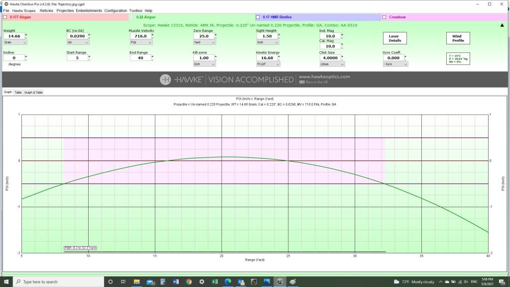

Looking good. Here is my Hawke Chairgun trajectory chart for my HW95L .22 with a 25 yard POI. I really like that scope.

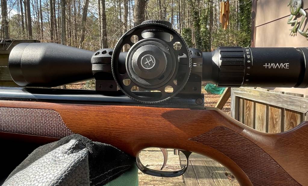

This Hawke is going back for warranty, it’s got so many black specks inside the lens now that it’s quite annoying. Just waiting for my Athlon Helos 4-20x50 to show up one of these days so I won’t be scopeless. I haven’t been very impressed with this Hawke since the day I got it but really wasn’t expecting that much from it just on its price point. The day I took it out of the package you could turn the turrets and(not really sure what to call them. Take the caps off and the turrets go inside them.) they would actually turn. Just using my fingers and I screwed them in tightening as much as I could. Figured no way it would ever hold zero but so far it has.
