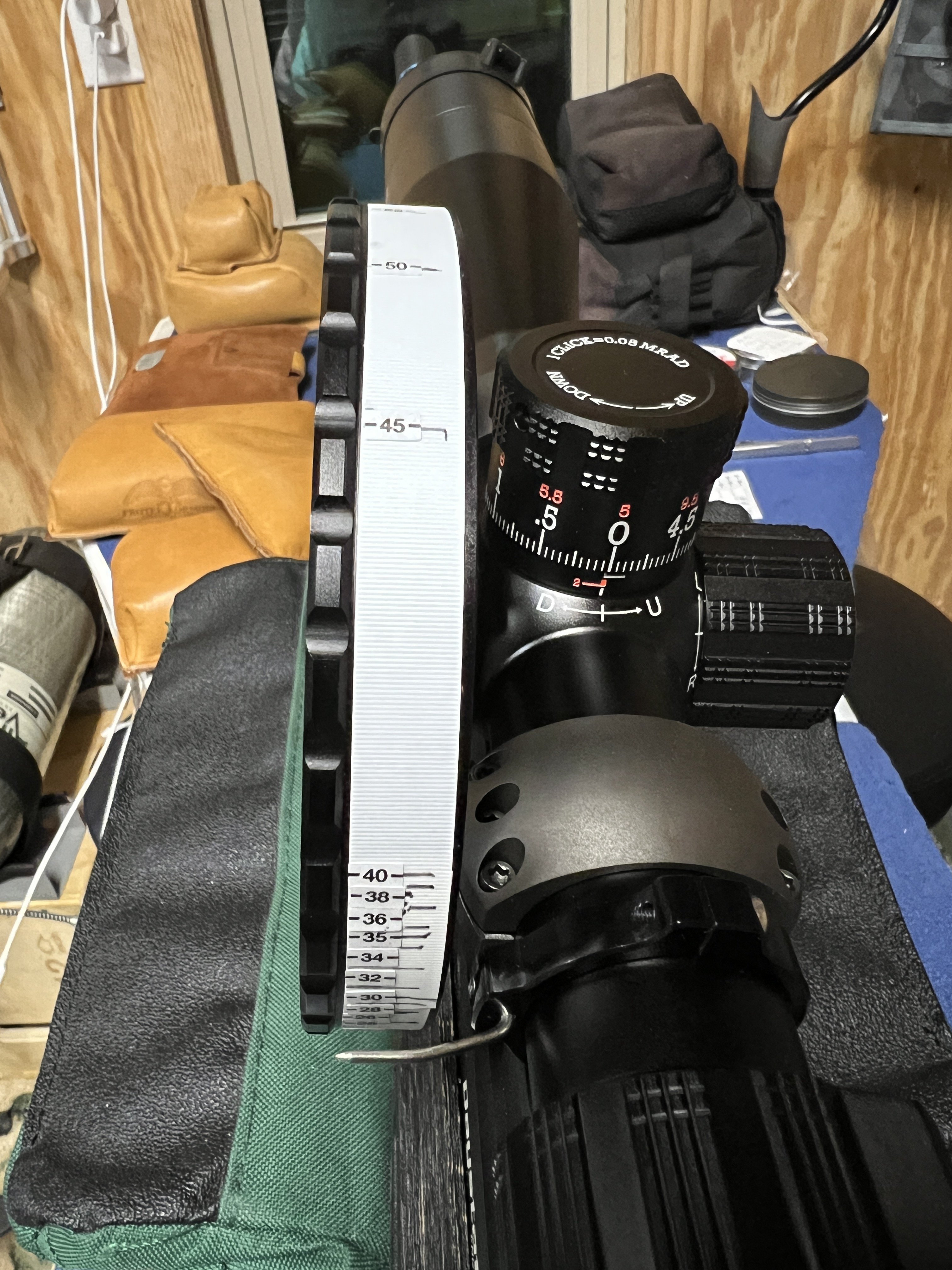

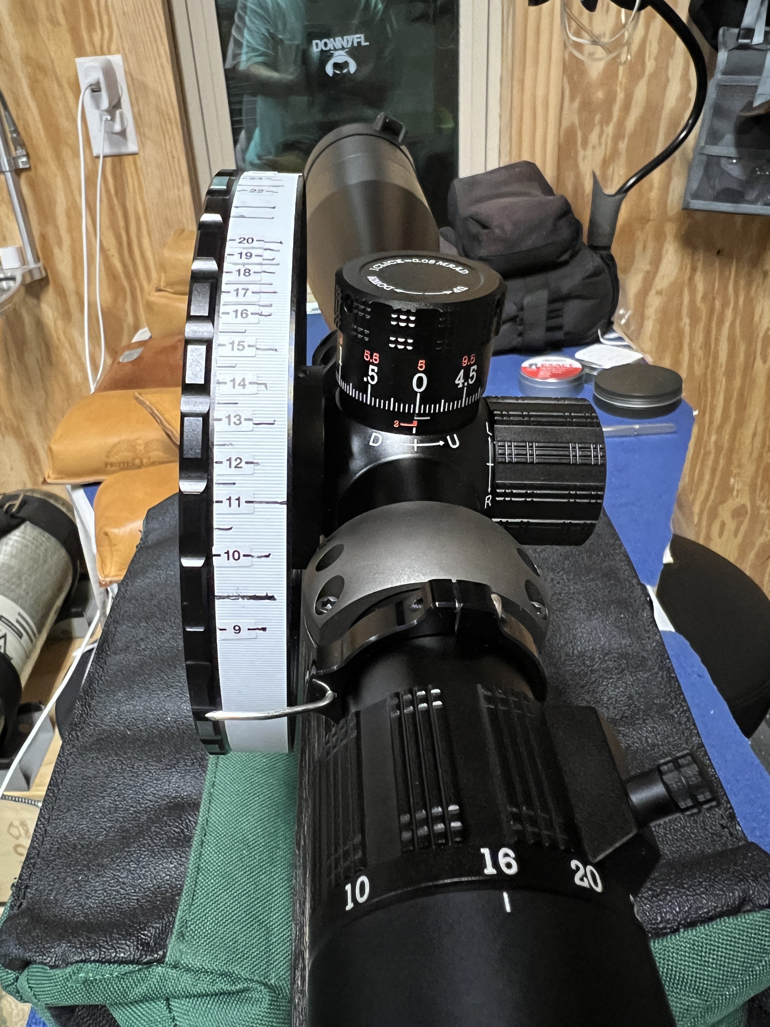

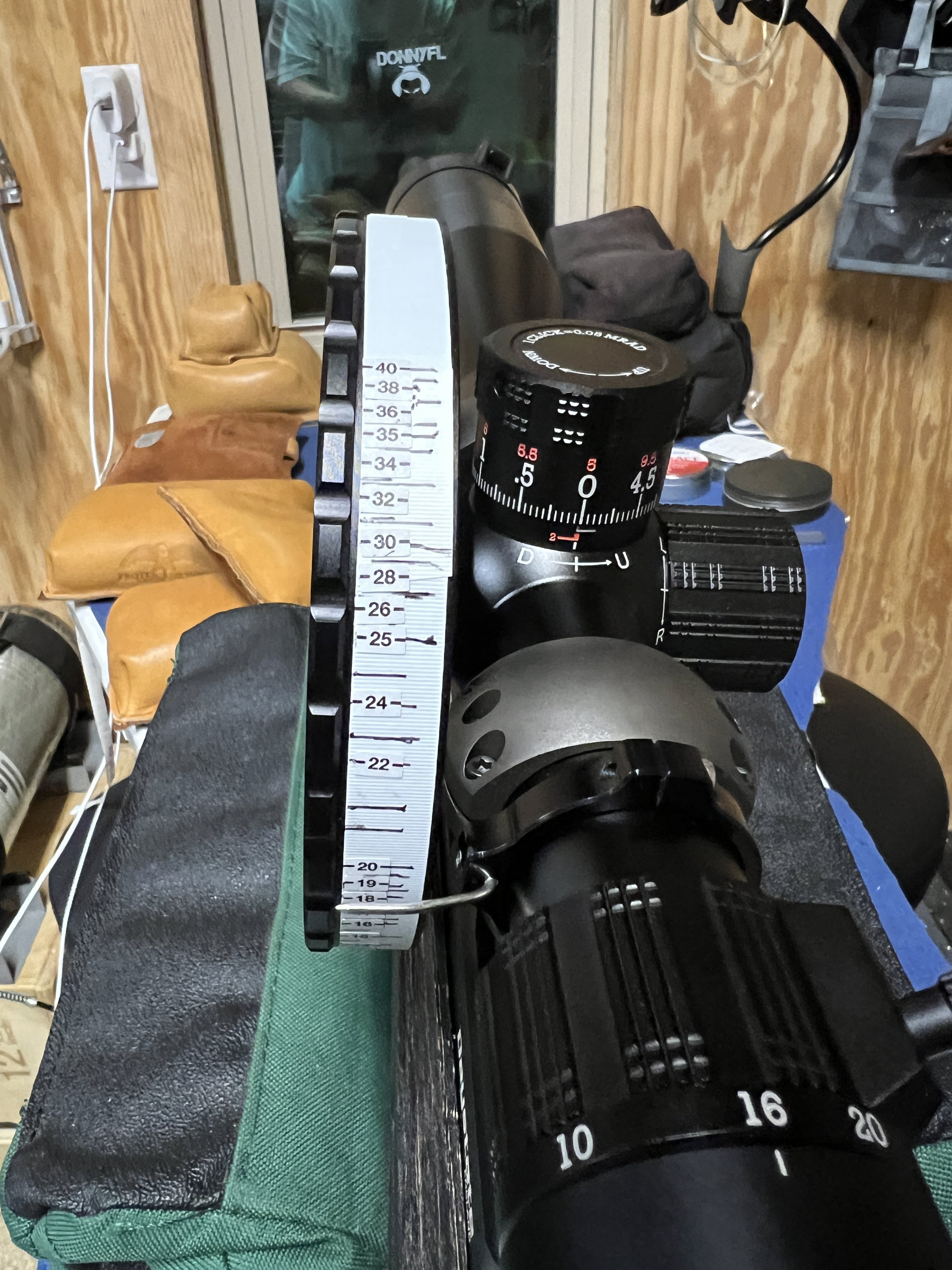

Well my wheels not completely setup yet but still fascinating stuff. Very very repeatable and from 8.5 yards to 40 yards it snaps in pretty clearly.

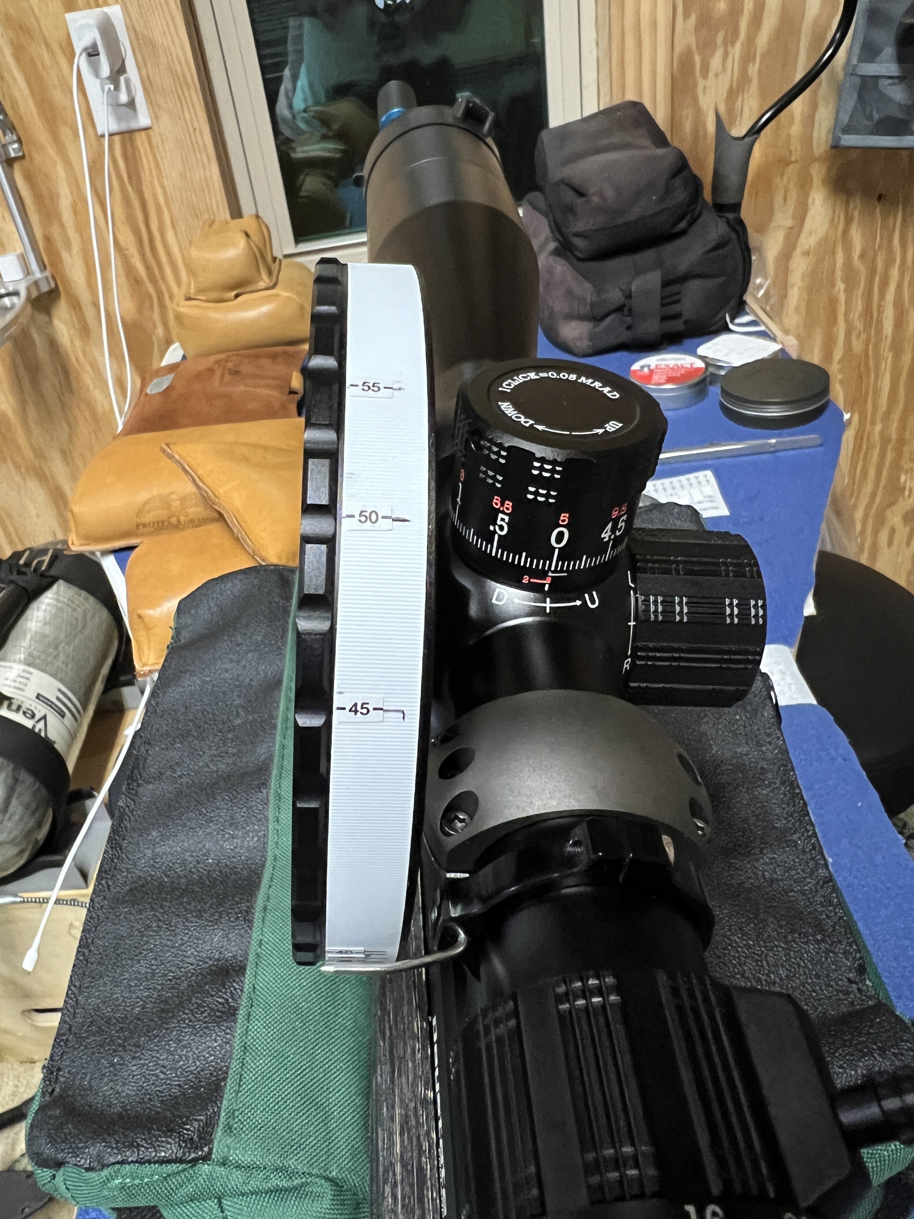

Look at how the numbers spread out across the wheel 40-55 is crazy spread.

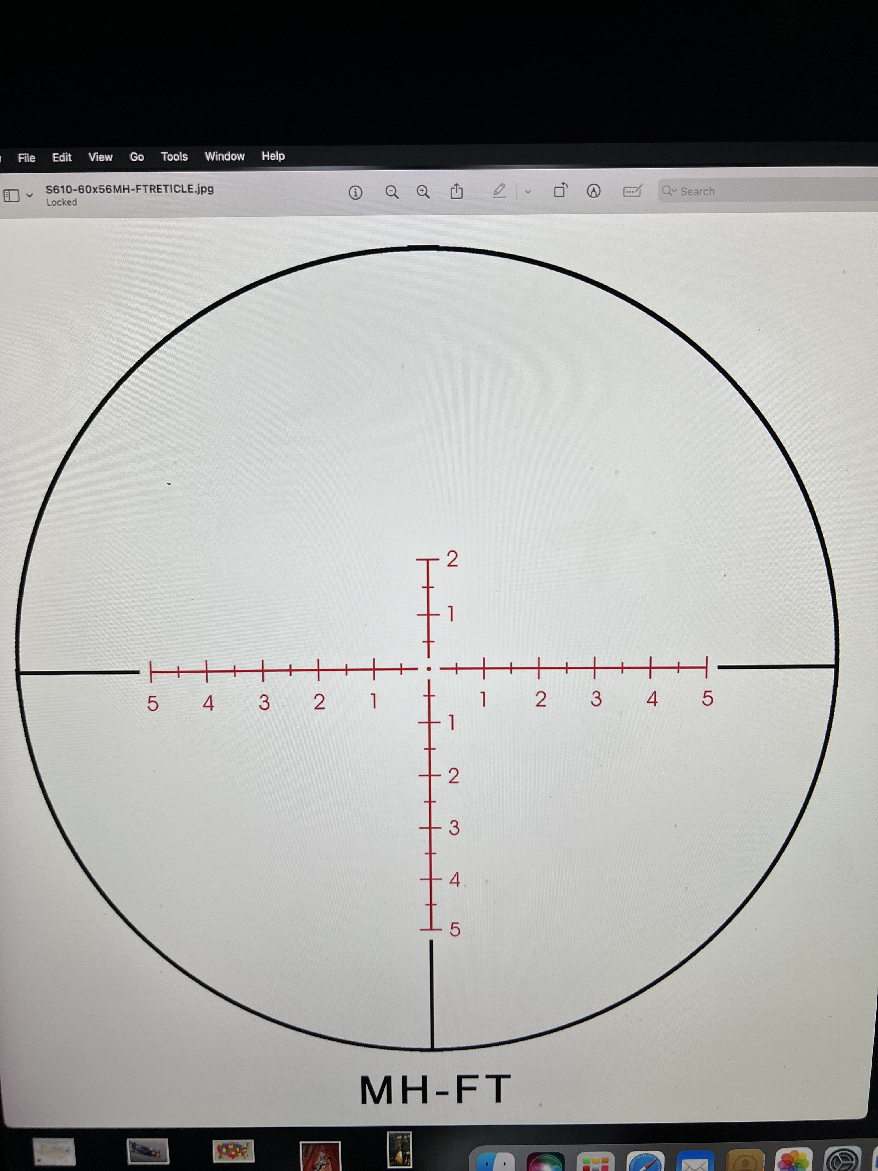

The MH-FT Reticle is obviously meant for the clickers... for us HFT folks this means it lacks enough ticks /hash markings on the reticle to help with dicey detailed holdover points... maybe i need to shoot open or unlimited? Dunno... never tried clicking or WFTF. Maybe time to learn.

Day one: i intentionally set up my initial wheel markings on the sightron oem parallax wheel, end of day, on a dark cloudy course...
i call these initial markings my rough in numbers ..
Day two i come back and recheck those initial marks to validate my ranging wheels initial markings and my tired eyeballs (yep our eyes can change).
The parallax wheel was absolutely spot on from 8.5 to 35/40 ish......so out to 40 yards ranging repeatability is perfection.
But like all scopes, i've tried to date, including: March FT, Nightforce NX8, when limited to 16X for HFT 40 - 55 is problematic. how so?
I had to completely redo the marks from 40 - 55 yards (they spread out even further) i believe that lighting was a big contributor to this. Since i've posted pictures of the initial markings I'll post another this weekend of the new 40-60 distance markings on the wheel - as i'm rechecking my wheel and dope today.
Here's what the initial dope looks like - try to compare my holdover points to the reticle and you'll understand more.
Thanks for the S6 model 66007 review so far. I love that lighted reticle. My 5-35x60 S6 has only the center dot lit and had difficulty with it this weekend on the darker targets in the shadow lanes. Using holdover was very hard for me to see where I was on the target. It seems to me that even my center dot doesn't illuminate as well as some scopes I have. My old Slll with the Hector illuminated reticle (Xtree) is still my favorite reticle. That scope must be at least 10 years old now and it still works great. Looking forward to your thoughts on how well it rangefinds for 40 to 55 yards. When it gets hot out my S6 marks seem to stretch out over 50 yards from where they were scribed on my comma in cooler temperatures. Quite significantly?
My latest Athlon ETR UHD 15-60 X56 maybe even worst in the shadows with the very ultra thin reticle. :rolleyes:

The MH-FT Reticle is obviously meant for the clickers... for us HFT folks this means it lacks enough ticks /hash markings on the reticle to help with dicey detailed holdover points... maybe i need to shoot unlimited? Dunno... never tried clicking or WFTF. Maybe time to learn.

I had no trouble with my holdovers either, so the MH-FT reticle will work if you’re paying attention; and it’s illumination is very nice.
