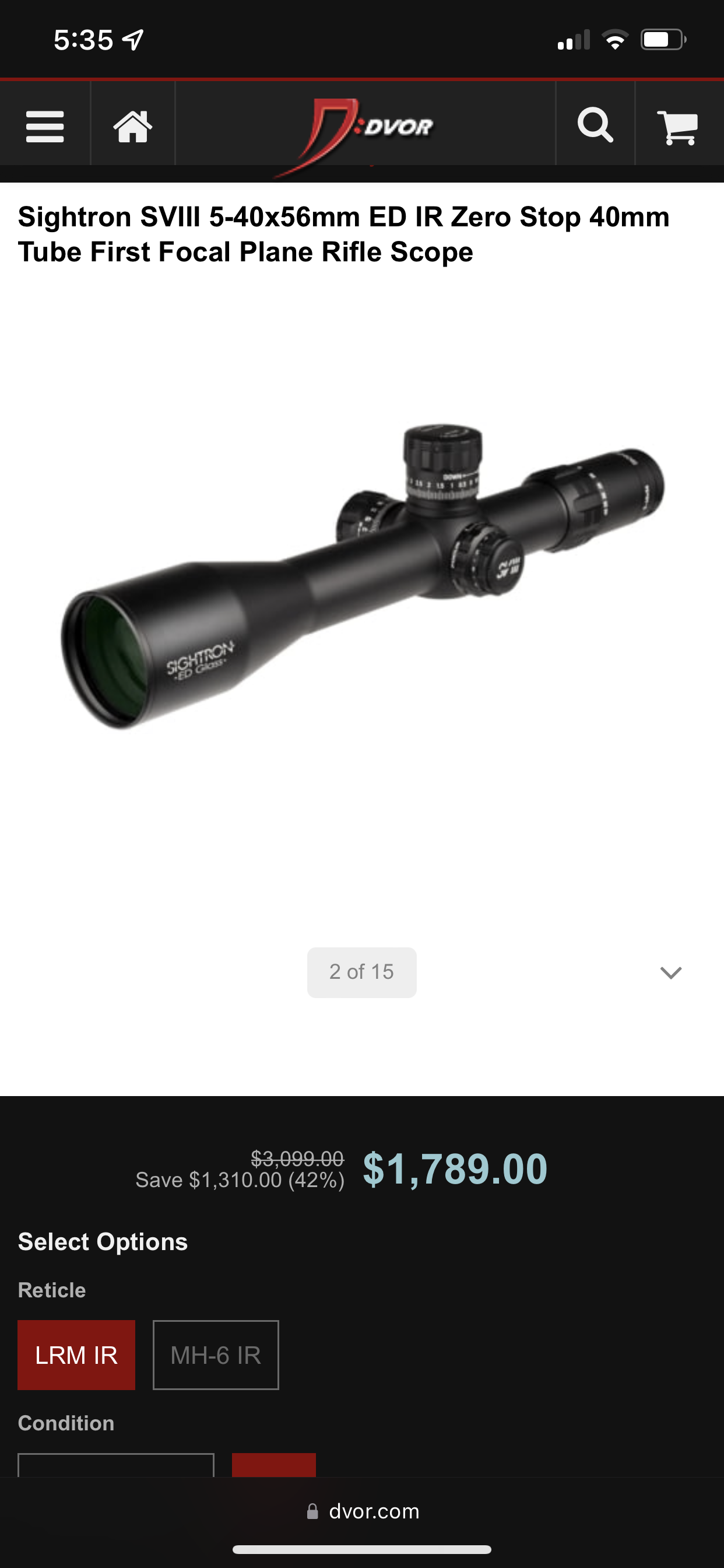

@cavedweller Still investigating. I went to Sightron’s site because the Amazon page lacked pertinent details. For instance - in regards to the 25003 model it is a SFP scope, but Amazon doesn’t say this in their description. The ED scope is a FFP scope. The 25003 has a 30mm tube and 60mm objective, focuses down to 13 meters. The ED FFP scope has a 40mm tube with a 56mm objective, zero stop, seemingly higher quality glass (low dispersion), and focuses down to 10 meters. Basically at first glance the ED FFP model appears to be the newer version with more features. They both have different reticles. In reviews of the 25003 model, some reviewers complained of a lack of features for the price point. Still looking at the details.
These links are better sources of info: https://sightron.com/products/sviii-ed-5-40x56-ffp-ir-zero-stop

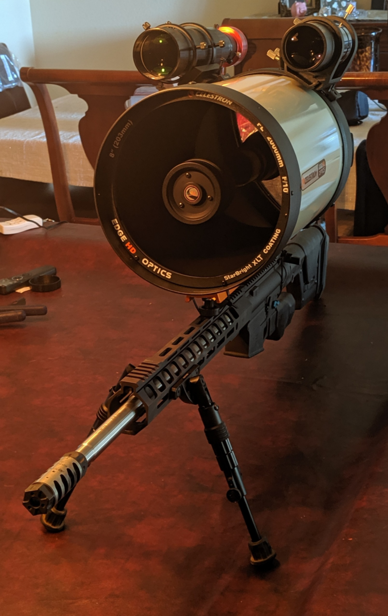

Soon I’ll be able to say: my erector tube is bigger than yours! 🤨😆🤣
