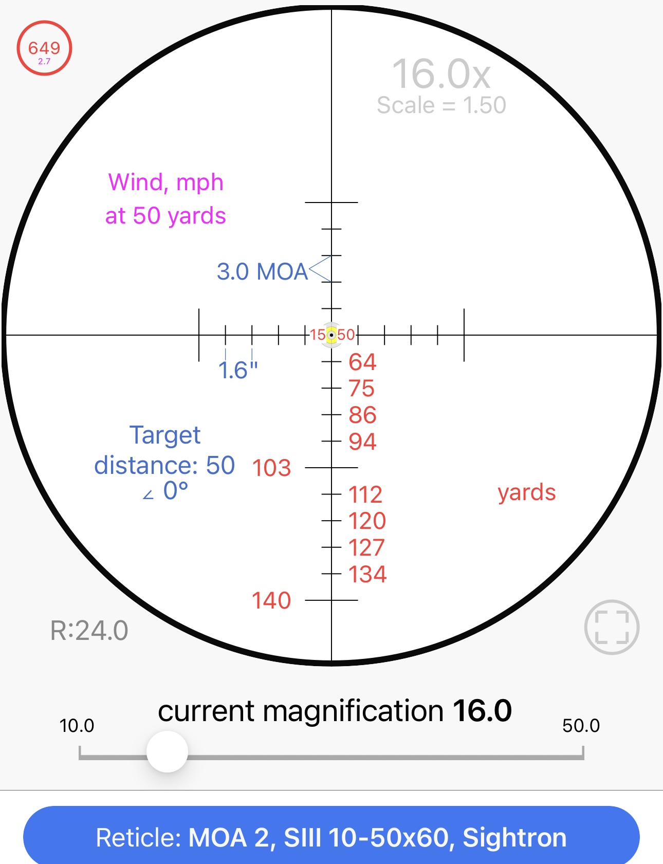

I personally like the Sightron MOA-2 reticle and have never found that it doesn’t have enough detail. The MOA reticle is layed out with 1/2 marks at the center and is 3 MOA between full marks at 16x. It turns out that 3 MOA the same as a 1.5” kill zone at 50 yards.
If we were shooting in the UK or Europe a MIL radian reticle would make sense since they measure their courses in meters and kill zones in millimeters. We happen to be shooting courses layed out in freedom units and most of us think in freedom units.

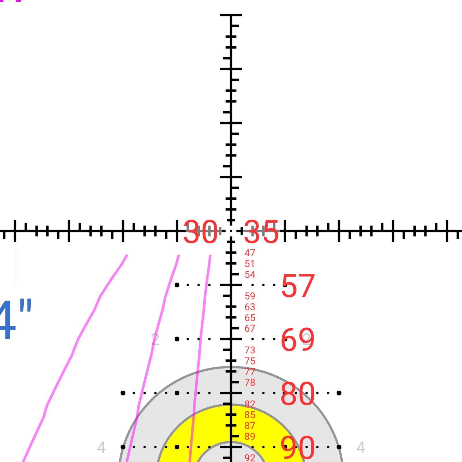

Here is the reticle for the Riton X3 for comparison, in case anyone cares. Strelok cut it off, but you get the idea.
