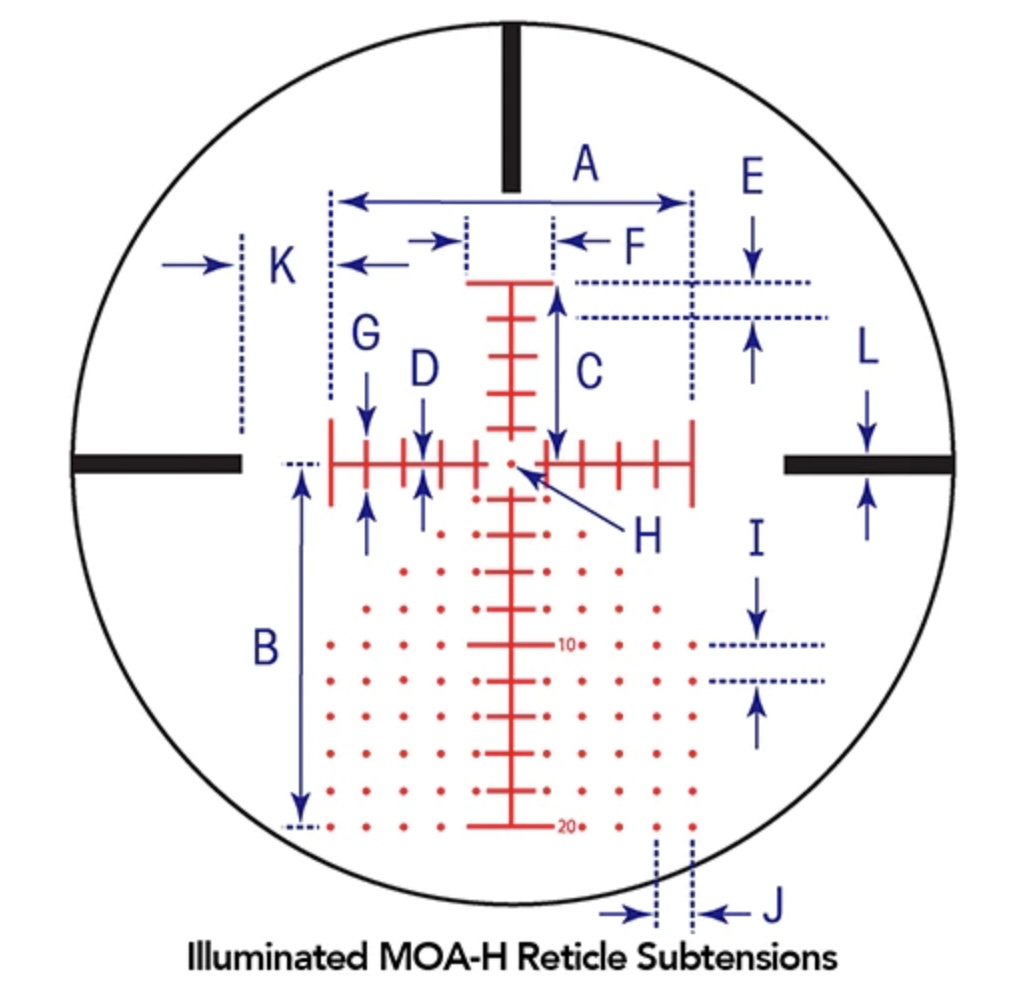

What model and reticle are you referencing? The moa H reticle on mine is fully illumianted, not just the center dot.

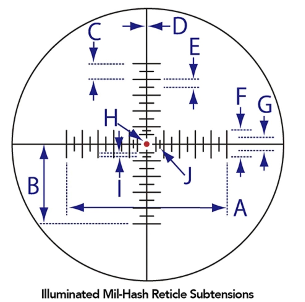

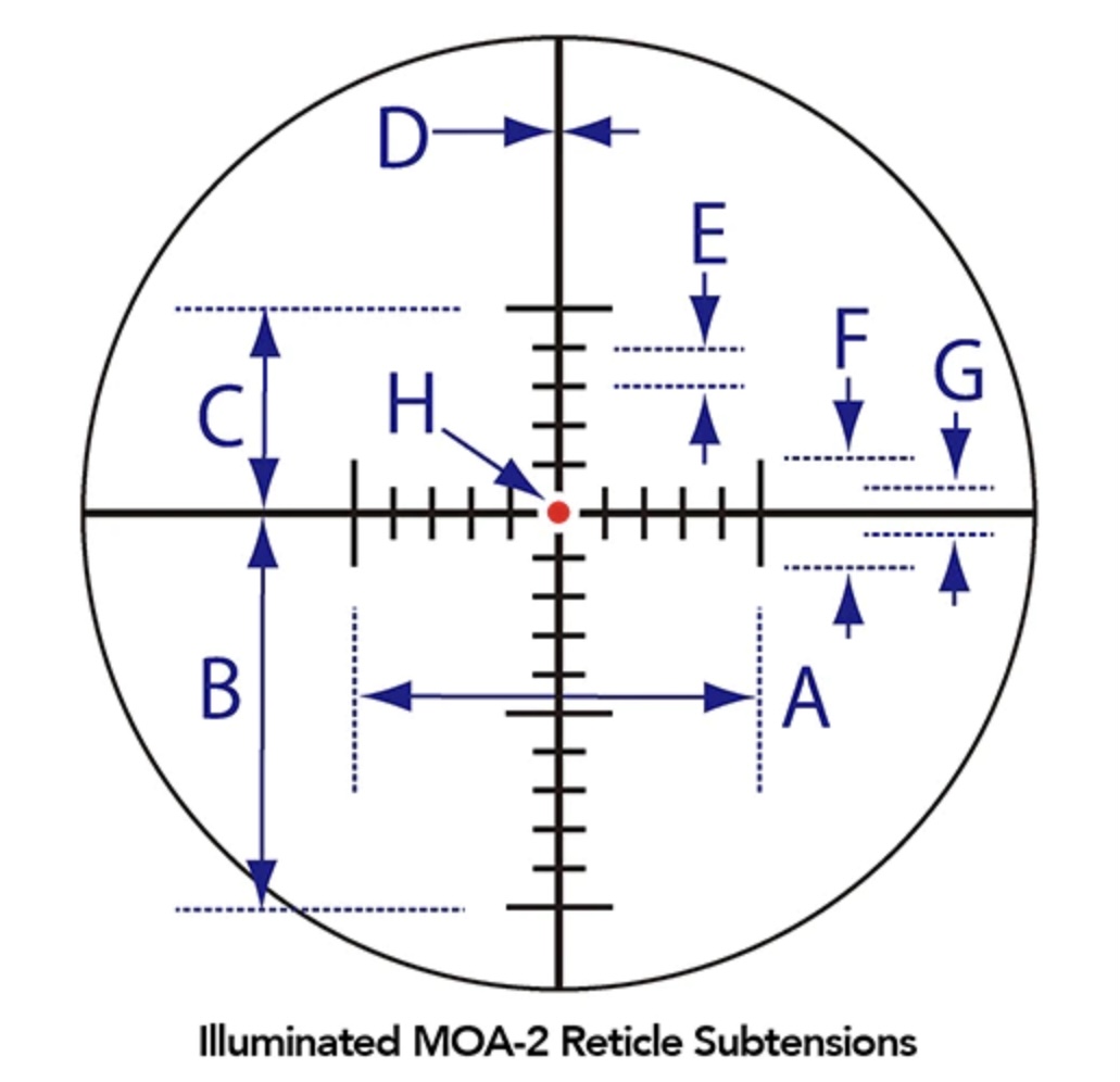

These are the 3 reticles on the SIII 10-50x60, I have the MOA-2
